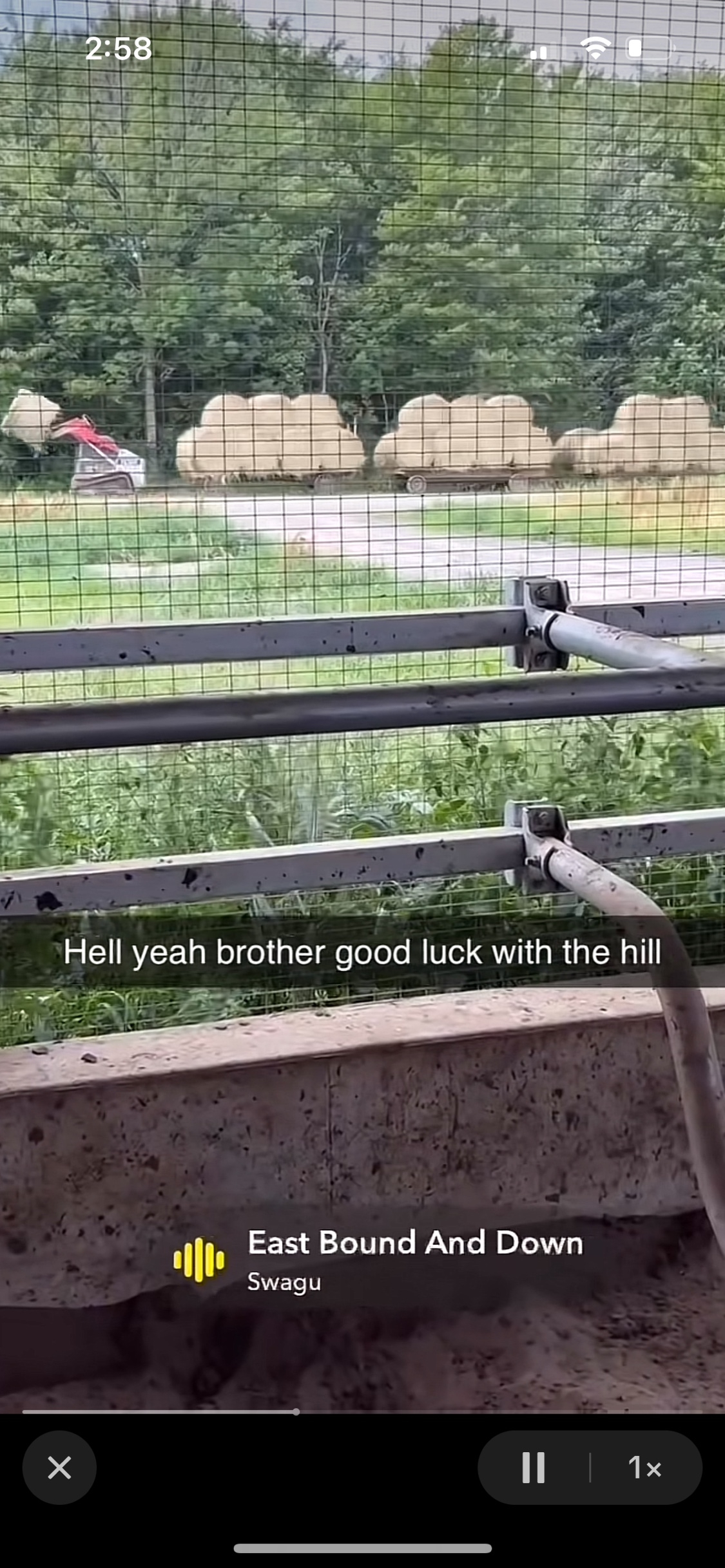

I just saw this on ticktok. Looks like a HST pulling trailers to me.
   / dumb question about HST #83
Somebody believes in abusing equipment.
   / dumb question about HST #84
Is that a feed trough in the foreground of that video clip with skid pulling hay racks? Makes me wonder if just moving short distance on known flat ground. Either way could be interesting turning if pulling very hard.
