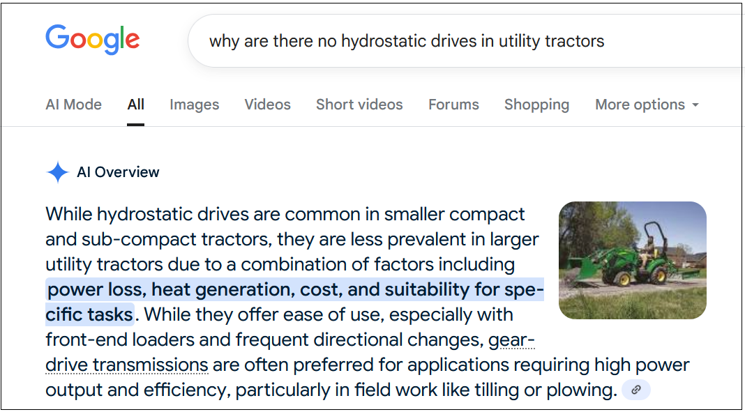

I had another question about HST vs gear, and it hit me to ask Google's AI, since it knows everything:
(text above was highlighted by Google, with more info on each of the four items offered below the above text)
After I read the above, I was thinking that HST is best for lower power applications, but I remembered that I've rented articulated wheel loaders before. They were larger than a utility tractor, and they are HST?!?
I guess that the word "loader" in articulated wheel loader is key. A wheel loader is more focused on a single task than a utility tractor, and that task is 99% back and forth, stop, start, reverse, etc, and that is the area where HST excels.
yeah, I think a lot of CUT work is perfect for HST and HST is perfect for it, while utility tractors tend to be more in the.... tractor.... application, where HST can be a negative and there's little point of having it.
