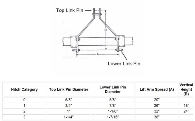

I have no experience with a Quick Hitch, but here is a chart of the measurements on the attachment:
The lift-pin-to-top-pin spacing is 18 for Cat1 and 24 for Cat2.

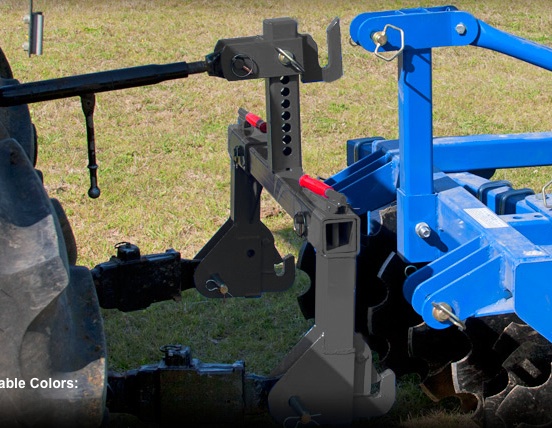

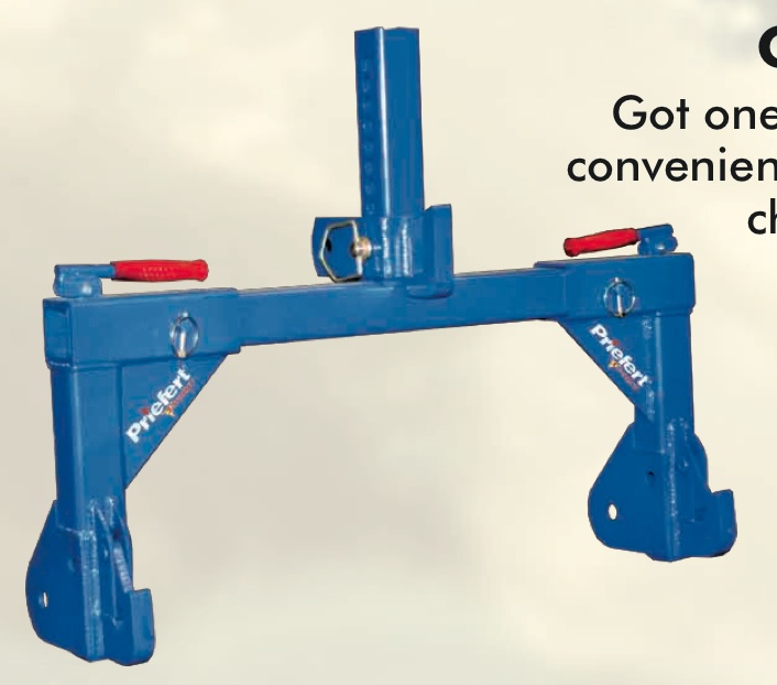

Try to find a discontinued Priefert hitch that is adjustable. And I've seen the the same hitch with another name. You could modify a hitch the same way.
Bruce
Ooo, that's interesting. My concern if I had both hooks would be if an attachment's clevis ever got in the way of another category's hook.
If I made the hitch slide with a cylinder and stops, it could effectively change between a Cat1 & Cat2 on its own...

Look at xfaxman's post. It's your lift arm spread that will be your biggest issue. Only option I can think of its Pat"s system as it allows you to adjust the spread. I'm in same boat and my quick hitch is cat 2. Only works on my disc and 8' rotary cutter... Not my box blade or sub soiler and obviously not my PHD

Another view:
Bruce
/ Dual Cat1/Cat 2 quick hitch #11
I didn't see that the lift pins could be adjusted. That's pretty slick!
