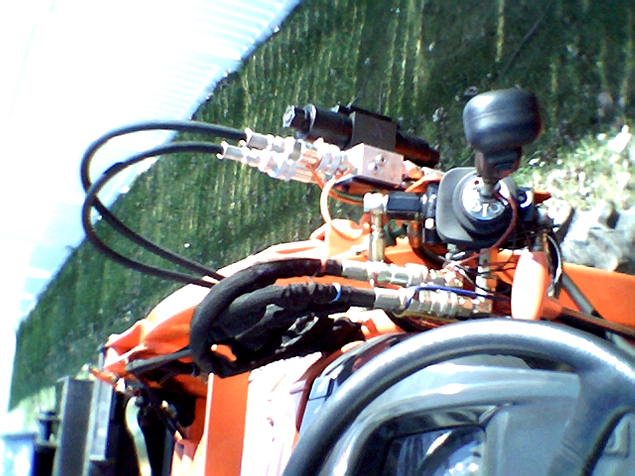

Finally took pictures of my 3rd function kit installation. Not too bad an installation. Kioti DS3510 with KL352 loader. I think I will make a metallic
guard for the setup. Unable to install inside loader arms for protection, No space available. Switch on handle on side where easy to activate with thumb.

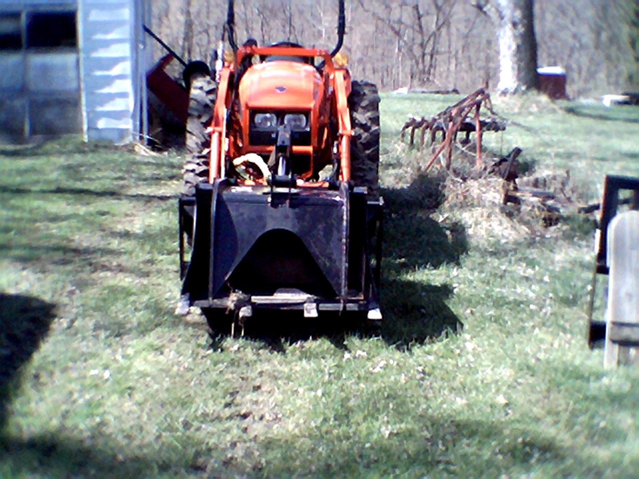

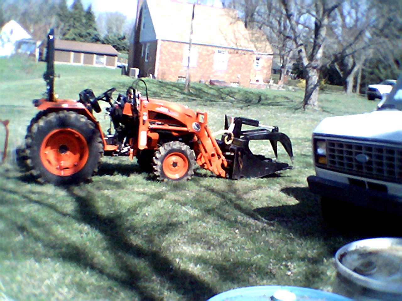

The grapple is the one I got at the local equipment auction last week at Rogers, Ohio. Got a 42" pallet fork also at same auction.

/ DS3510 3rd funtion Kit #3
Nice work.:thumbsup:
Where did you get the valve?
Is there a way to put 90's on the top hoses to lower them from getting caught on things?
I got the 3rd function kit from Everything Attachments.
As for the 90's, yes I could put them on, but with all the running arround I did to get the parts I did end up with, I decided to get it together and try it out.
I will be looking for the 90's today. The DS3510 and the KL352 are all 3/8 fittings and TSC only carries 1 or 2 male/female kits per store. I ended going to 4 stores to get enough kits for everything and forgot about the 90's.
Of course, you don't expect me to get it to where I couldn't try it out?
works Great.

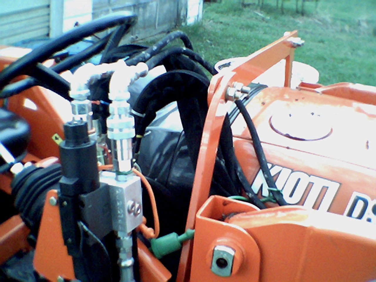

Coyote Machine,
I did modify the upper hoses. Got the 90 degree put on the fittings. Drops the hoses a lot and can use less steel for the guard I am designing to protect the valve since it is outside the vertical FEL mount post.

Looks good. Wondering if you put the 90's on the valve and pointed the QA's toward the seat/wheel if you might be able to get everything lower still without having to build a high shield to protect everything. You might have to add another pair of 90's to accomplish this, but it might be safer for the hoses/valve/QA's.
I would try but all the fittings at the valve itself are straight thread and have O-Rings for sealing on them.could put the 90 itself on the valve fittings, but, did not want to mess with those fittings if I could help it. I am an Aircraft Maint. Tech. and mess with O-Rings and they can get nicked, cut, damaged just looking at them it seems. Then they leak. So, I don't want to pull them to get fittings on..

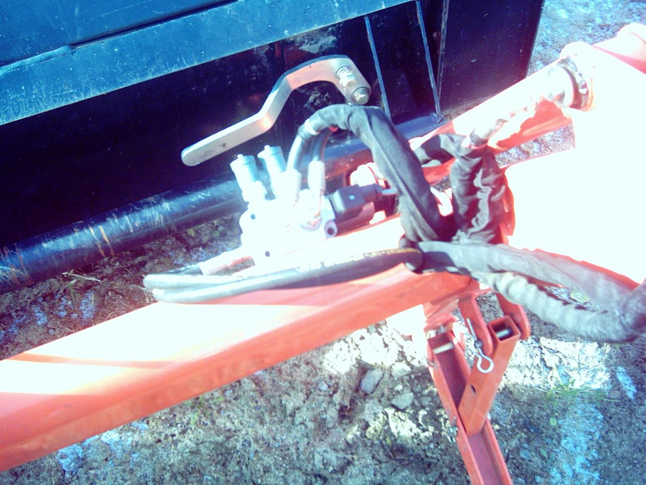

/ DS3510 3rd funtion Kit #8
I had my diverter valve installed on the loader, although i have nothing to use it for:(.
The diverter or bypass valve works very well with snowplows if you hit a rock or something when angled. lets fluid bypass between actuators to avoid damage.
What I installed is a 3rd function valve to operate grapples, FEL plow/blade actuators and the like. Requires electrical power and has wires running to the joystick handle switch (supplied) and also to a permanet hot wire attach.
I am going to make a snow plow QA out of my Dearborn snow plow. And then I will be making it hydraulicaly adjustable. (add actuators) So, I think I may want to buy a bypass valve real soon.
Tom

To the OP: Are those elbows you put on the top steel and designed for high-pressure use? To my eye they look suspiciously like galvanized pipe elbows. If steel, please disregard.

Yep, Steel fittings. I would not use anything else on my tractors. I have used aluminum fittings for 3000 psi on aircraft, but, my tractors are not aircraft.
As for the guard, I was thinking 1/8 steel bent into a "U". 1-1/2 leg, then a leg to cover the valve, with the 3rd leg about 1-1/2 bent at a 45 going aft.
the first leg will have the 2 bolts thru.

Tom, I know that you said that the 90s were steel and not aluminum, but are they high pressure steel? I have never seen a hydraulic 90 like what you have there. It looks like it is for water or gas. :confused:

I know. They are temporary. I had to order all the proper steel ones I needed. Only found two in the 4 TSC stores I went to. I should be changing them out by next saturday If I am lucky and they come in.
If I wanted to do tubing, I have the flareing tool for the JIC fitting. There is no big problem using the 37 degree JIC with the 37-1/2 degree aviation flare. Much better than using the automotive 45 degree flares that some use. I no longer have a source for the aviation steel fittings. Unless, I ordered from Aircraft Spruce or similar company.
Still, It is cheaper to buy from TSC or such as those fittings do not have an FAA PMA. (Federal Avia. Admin. - Parts Manufacturing Approval. Which in my opinion, jumps the price up greatly)
