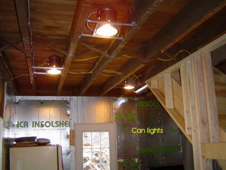

I have done similar, using the foil faces foam, (now our house was boarded up on the inside, with ship lap lumber,
one mistake I felt I made was not putting some wood striping around the windows, for some thing solid to nail to,
makes some things hard to work with, with the thickness of not any thing solid, to work with,
I would do it again tho knowing what I know, but would most likely use 3/4 thickness, and fur out the windows and a 1x4 on the floor and would not hurt to put something at the ceiling for some thing solid to nail/screw to,
I use what was called a box extension, a small sheet metal thing with tabs where the screws are, and it slipped inside the box in the wall, and held with longer screws in the receptacles,
this was what I used, Inspired Remodeling & Tile | Nashville, TN | Peter Bales, Contractor | Play it Safe With Outlet Extensions
it appears they make a plastic version of it as well,
PVC Electrical Box Extenders for Tiled Backsplash - Brings your outlets out flush with the wall.

My house, being "double plank" had no problems nailing or hitting wood, unless you hit a crack between boards. There were no receptacles in the walls, due to the planks and the house was built before electricity was available. So, I had to cut into the first plank for part of the box depth and the insulation took care of the rest. The wires were run up the cracks between the planks.
