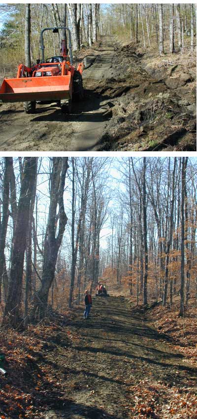

   / Drying a wet road
#20
I did some more work on this road section. The attached photos show how I left it last spring after trenching to collect the water and installing culvert pipes to drain the water to the downhill side of the road. The trenching left a wall of dirt between the road surface and the trenches and left a low spot in the road for water to collect.
This past weekend I used the grader blade to cut down the dirt mounds and move that material to the road surface. The result is a nicely (at least for someone doing this for the first time) crowned road surface that slopes to the sides into ditches. Now all the water should shed away.
The photo at the top is from last spring and shows the road, ditch, and wall of dirt between the two.
The photo at the bottom is from yesterday showing the same stretch of road properly graded.
I now have a full appreciation for the value of Hydraulic Top and Tilt.
