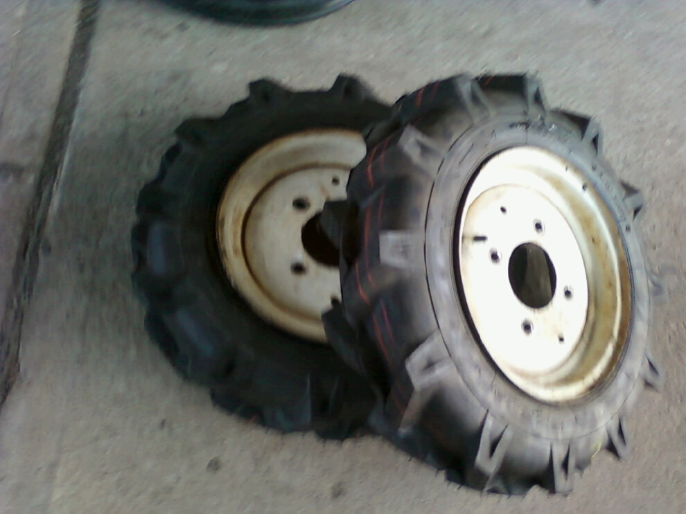

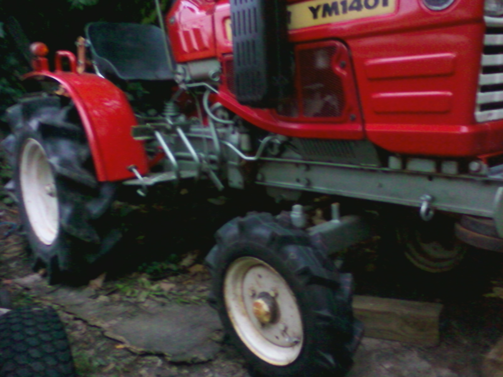

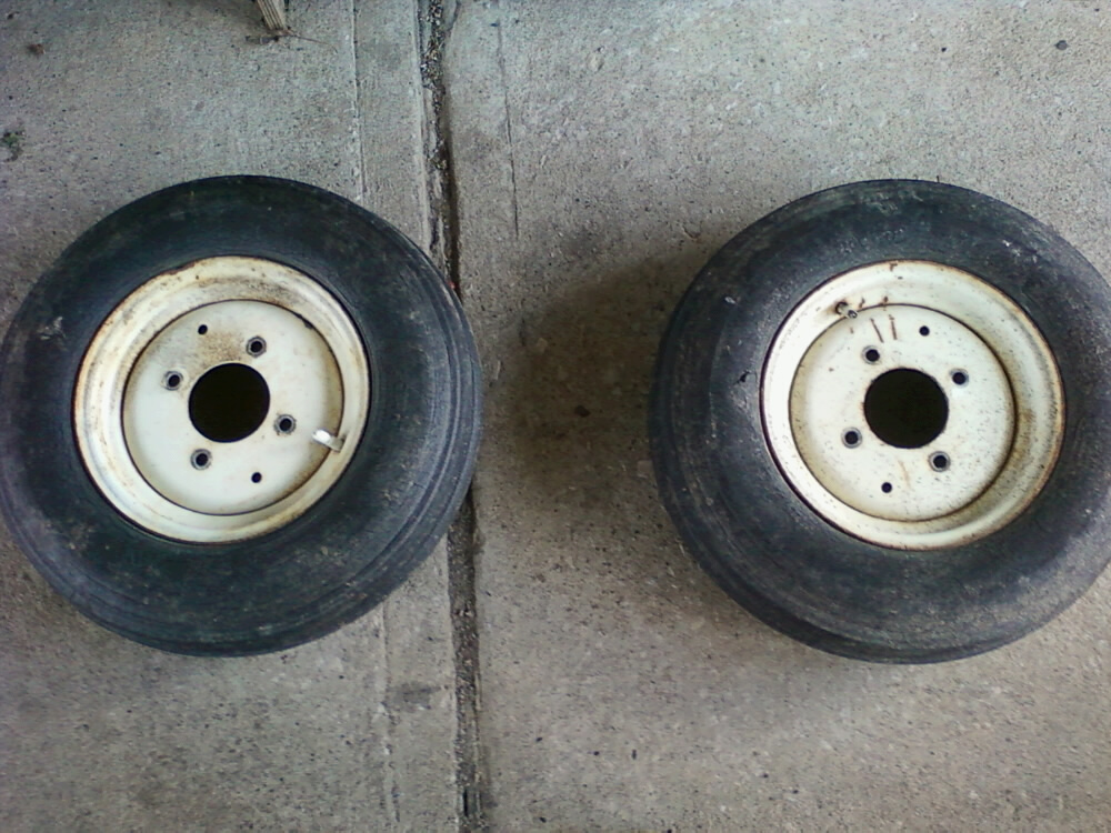

Found tires on the internet and replaced the old ones today. Here's a pic of the old and the new. Old Tires.jpg

They really were not that bad price wise. My old tires were coming apart literally. The sidewall was cut by a stem while hauling some logs this summer. It appears the tire pinched a hole in the tube causing a slow leak. I was able to patch and use the old tube with the new tires though. The tubes themselves looked to be in good shape except for the small hole. These are 4 ply and rated at 375 lbs. each. I was hesitant about trying these out at first because of the load rating. After installing them I think there is nothing to worry about.
