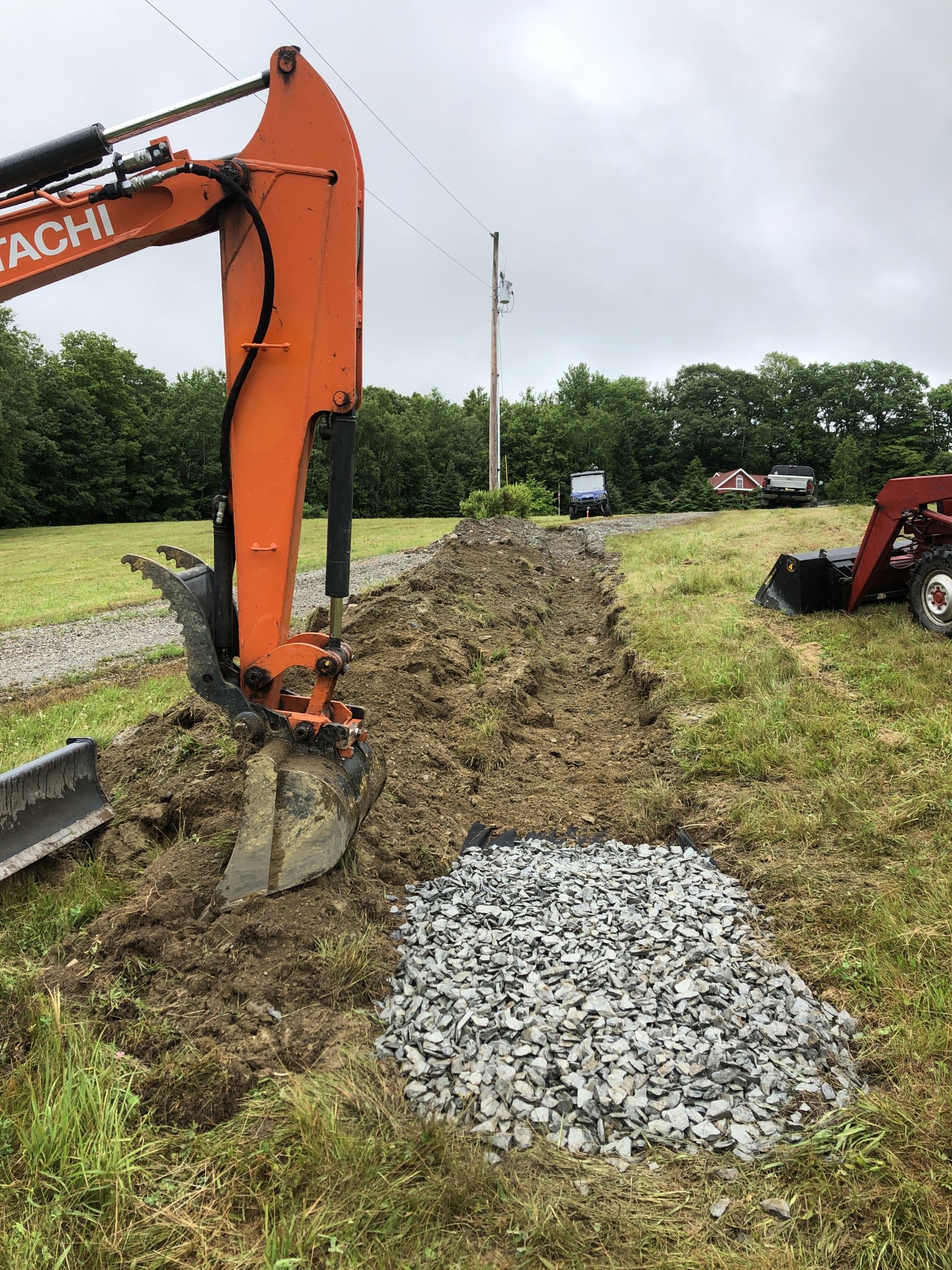

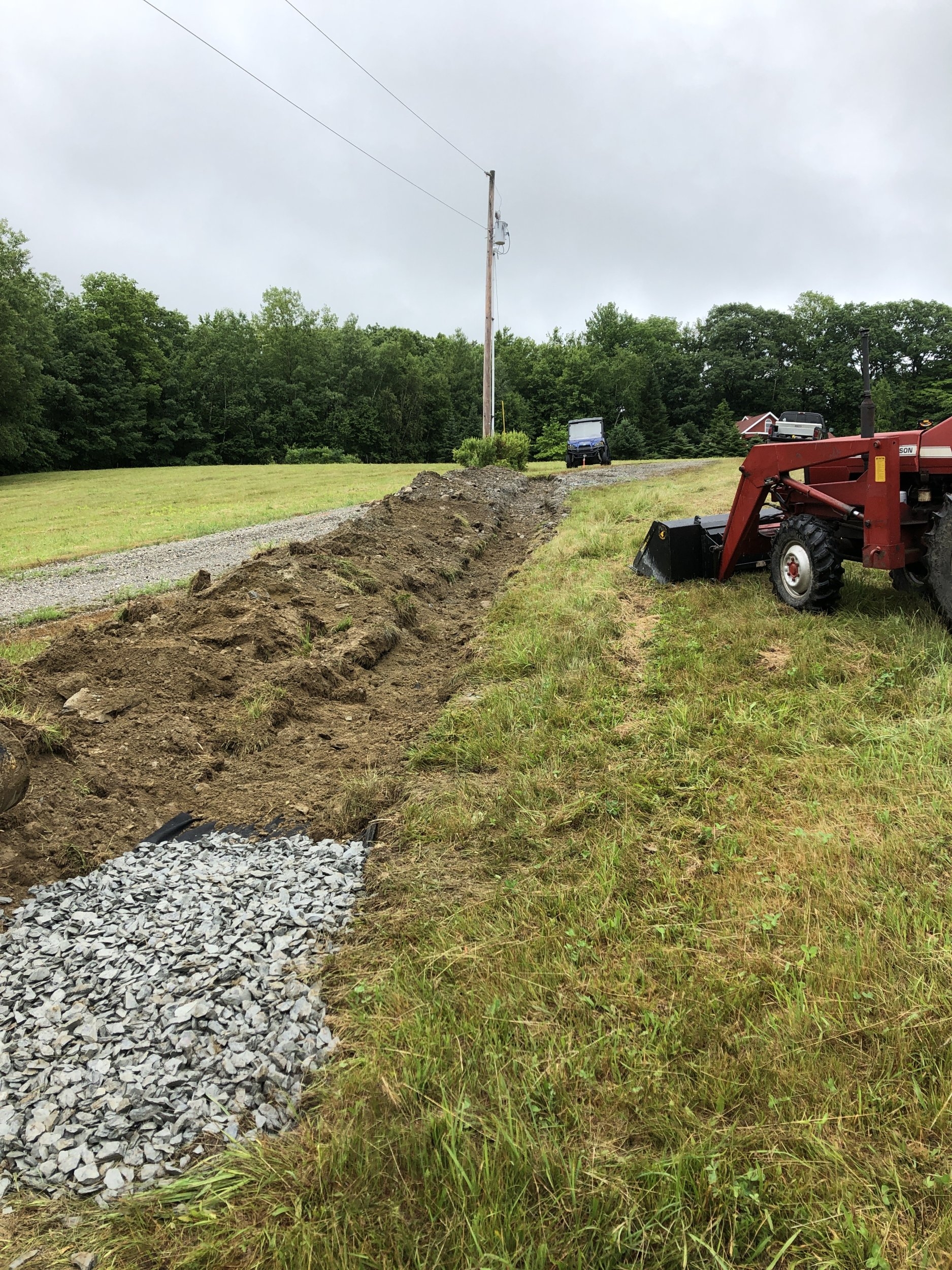

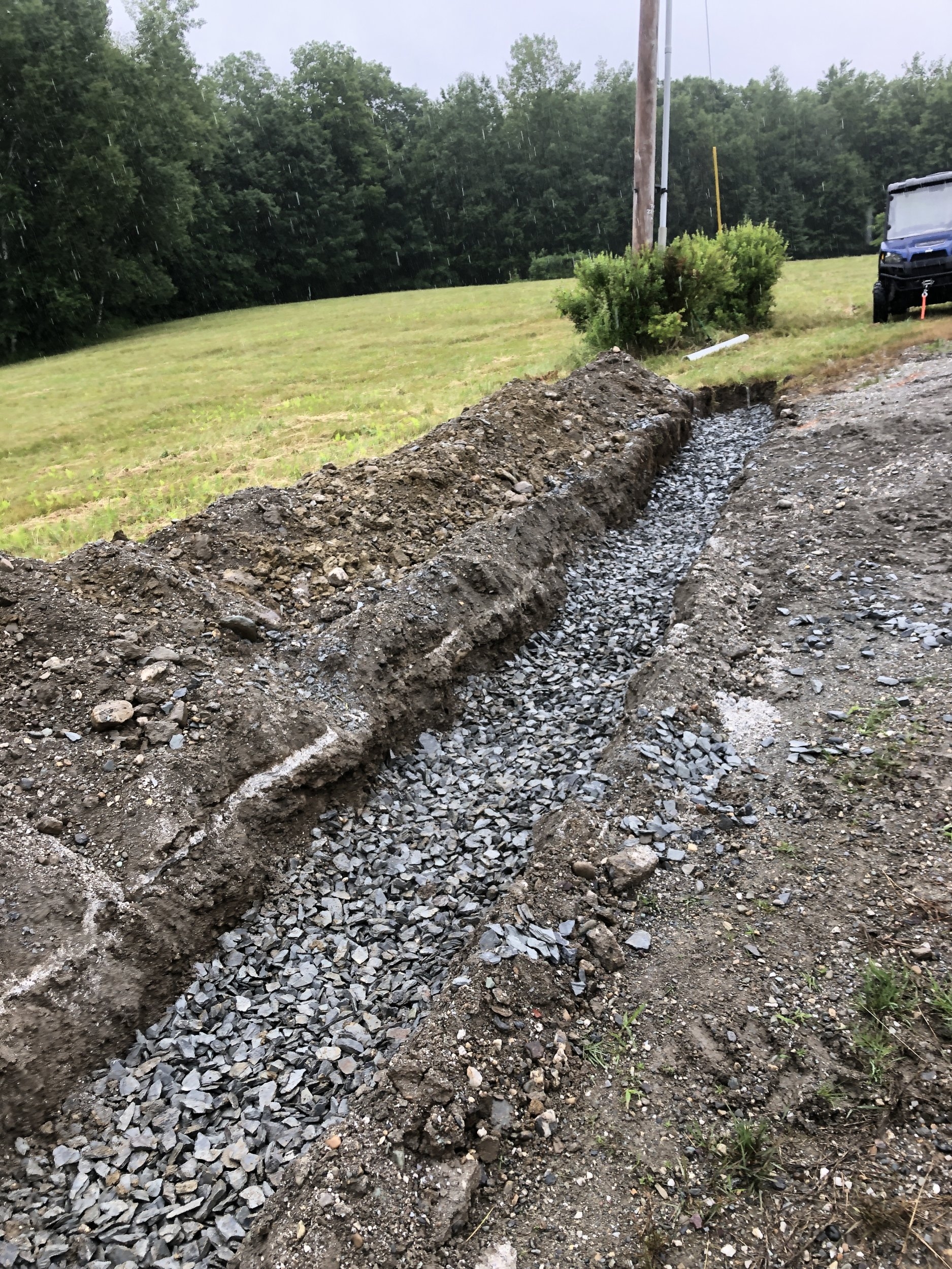

Good Afternoon,
I have been wanting to put in drainage in a wet section of my DW for the past few years ! Well I finally got to it today, although it rained throughout the whole project ! šŸ¤”
We dug a 100 ft long trench 2 ft wide and about 18ā€ deep diagonally through the section of my DW that gets really wet in the spring ! I had to call Dig Safe first because my internet and phone lines run the length of my 800 ft DW ! I’m guessing I used about 10 yds of 1 1/2ā€ stone, because I have about 2 or 3 yds left in my pile ! We used fabric over the stone to keep out the dirt from filtering down through ! My neighbor graciously used his Hitachi excavator to dig the trench, and I used my tractor to shuttle the stone down the DW where it was needed ! Time will tell how successful this project was ! šŸ™

Well thought out and done. (y)

i would have placed fabric, and a cleanout as well, but thats a pretty short run.

Good Evenin LittleBill,
Yes we used fabric and I just have to move some gravel at the end of the run to get to the pipe if I ever need a cleanout !

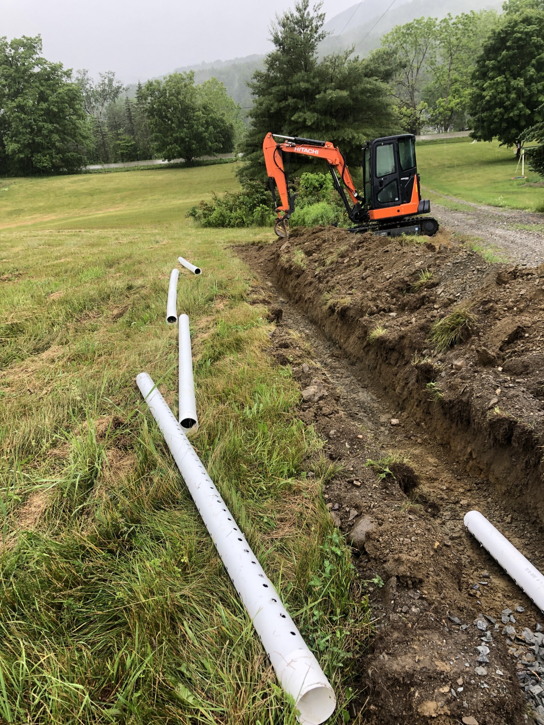

Good Afternoon Guys,
Just a quick follow up on the drain project. As most of you know we have an unprecedented amount of rain here, which gave me the opportunity to see how the driveway drain was working. Took a ride down the DW this morning in the Ranger and sure enough water was coming out of the drain making me feel that all our work was not in vain ! šŸ™
The real test will be next spring when the frost is coming out along with the spring rains ! We shall see !

Congratulations on your successful drainage project! I hope that others in your area fared ok as well. That was a heck of a lot of rain.
