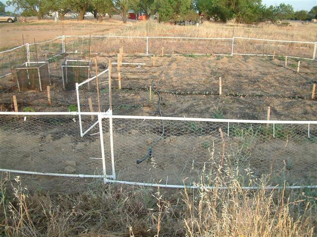

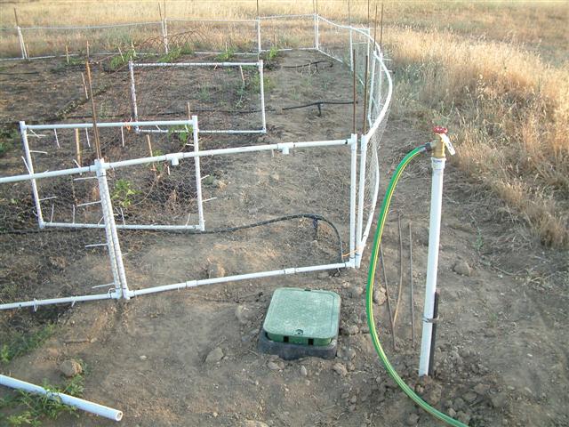

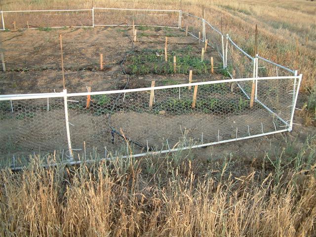

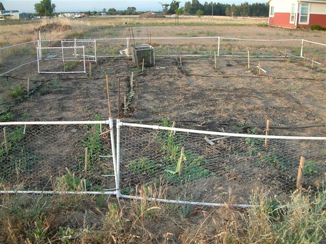

You need to bury the white PVC pipe since it turns brittle from the Sun's ultraviolet.
I use 1" PVC pipe and 1/2" risers teed into the pipe. Rainbird has nice $4.00 T-shaped couplings between the riser and 1/2" flexible black poly tubing (part #R334C). I lay the poly pipe perpendicular to the crop rows and string 1/4" emitter tubing along the rows. The emitter tubing is "Duraflo Jr 1/4" Dripperline" made by Agrifim (Fresno, CA) and has 1/2 gph emitters every 6" along the run.
See
NDS,Inc.
The entire system works off a 1" solenoid valve that's wired into my 16-station Rainbird sprinkler timer that controls all my landscaping sprinklers and driplines. The valve is in the valve box (green lid).
