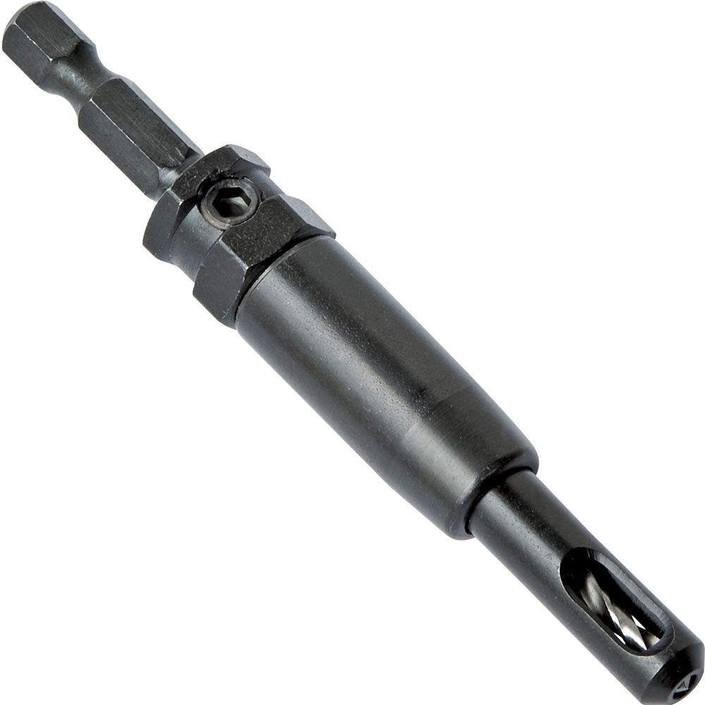

I like the peg board also but I would use a Vex bit for the pilot hole.
