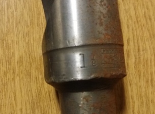

If you're interested, I have a spare 1-7/8" drill you can have. The flutes are right at 6" long, so you could get the majority of
your hole drilled, then use your boring bar.
Not sure of the taper, but you could possibly turn it to fit your tailstock...
Feel free to PM your address, and the USPS will be thrilled to deliver!
Tim

The shanks are machinable on decent quality drills. I used carbide to cut some of mine down. I should add that they are case hardened and get easier to machine once your in .030" or so.

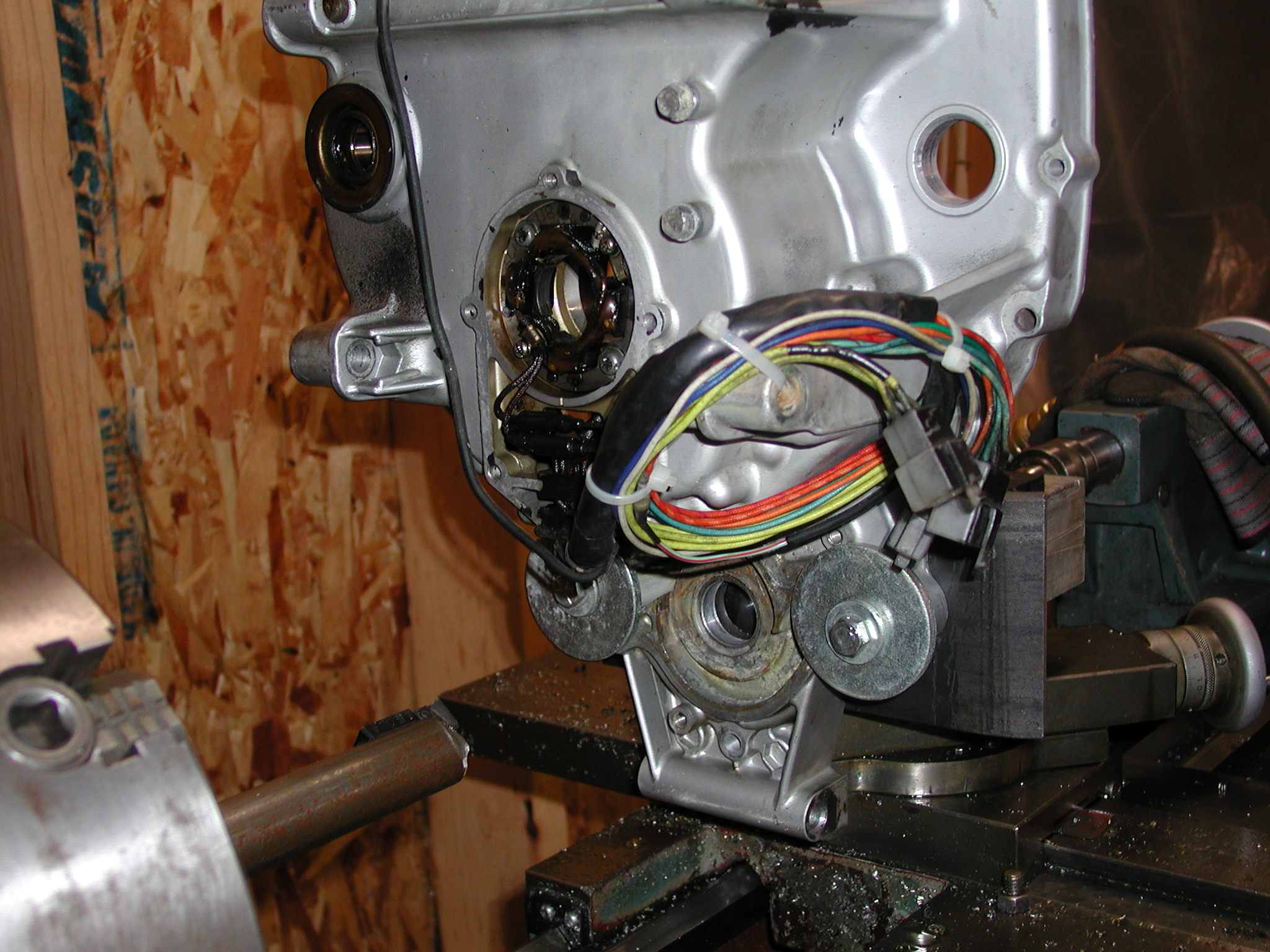

Here's a picture of me boring out a motorcycle engine cover for a different size water pump seal. It's bolted to a makeshift angle plate, and the boring bar is in the chuck. The engine is in my garden tractor, so maybe it's ok to post it on a tractor forum.Image016.jpg
