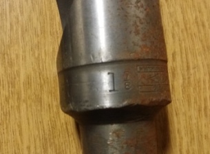

If you're interested, I have a spare 1-7/8" drill you can have. The flutes are right at 6" long, so you could get the majority of
your hole drilled, then use your boring bar.
Not sure of the taper, but you could possibly turn it to fit your tailstock...
Feel free to PM your address, and the USPS will be thrilled to deliver!
