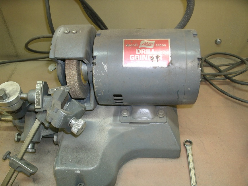

When I used to have the tool shop I found I could pay a machinist to stand at a grinder and sharpen drill bits or buy a Drill Doctor and have a flunky do it at a lot lower rate. The bottom line was that the Drill Doctor did it as well and more consistently than a machinist on a bench grinder and a lot quicker at a lot less cost. At first the machinists laughed but soon the machinists were just using the drill doctor if we did not have a sharp drill available.

It's all in the hands. You develop the heel clearance with your left hand fingers while rotating the shank with your right hand fingers while maintaining the correct lead angle with both hands. Simple with practice. Frustrating for the inexperienced and why 'Drill Doctors' are always 'on call'.....:D Darex (Drill Doctor) builds some very fancy drill sharpeners as well as end mill sharpeners for many thousands of dollars. There retail Drill Doctor is just one of many models.
My issue with the retail store model is simply it's limited range. My shop drills run in all sizes from 1.5" down to a No.80
