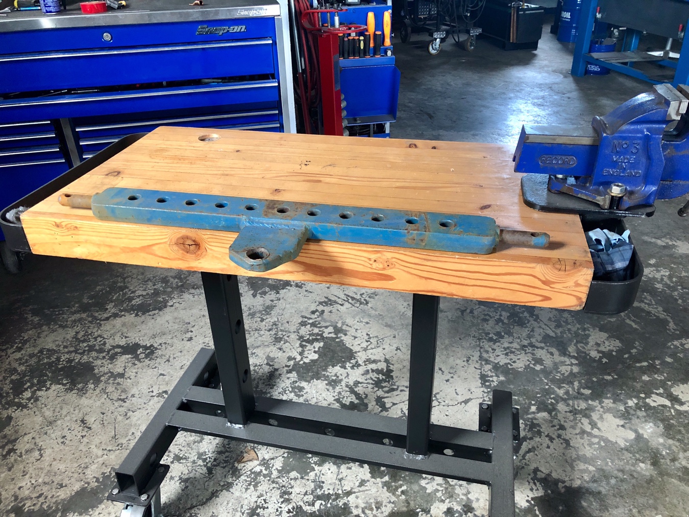

Wish I had a picture. Dad had a V shaped hootis that bolted to the cross drawbar and went forward/outward to the lift arms. Had a clamping setup on each end that clamped it to the lift arms. In the center it extended rearward past the cross drawbar. As it crossed it bolted to it. In it's extended center it had a pin hole. Put on the vertical stabilizers, and this device, now you have locked the hitch point from moving laterally as well as up/down. You've also extended the hitch point so you didn't experience the binding you mentioned. Created a rigid hitch point that was height adjustable. When using a tractor too small for the tasks at hand it helped to set the height above the center point of the rear axle. This used leverage to increase the traction of the small 2wd tractor when pulling loads. Caution was needed on behalf of the operator though. Dad lectured me sternly when using this setup. Did a lot of steering with the brakes. :)

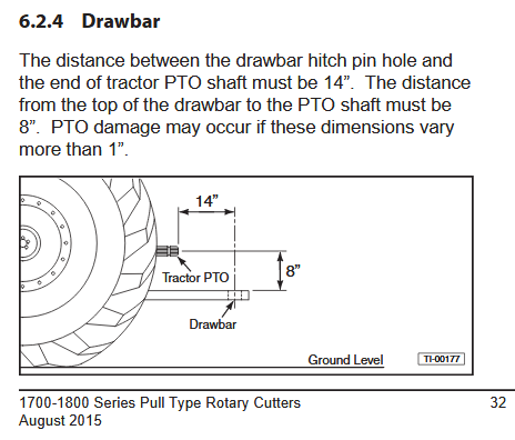

So, the OP has what is now called a Titan 1810P mower (not an 1800P).
Per page 32 in the manual, there needs to be 8" from the top of the drawbar to the vertical centerline of the tractor PTO shaft and the pin hole in the PTO shaft needs to be 14" behind the end of the the PTO:
602161d1556323583-drawbar-adapter-1800manualpage32-png
OP, does your tractor meet those dimensions? If not, what are your dimensions?

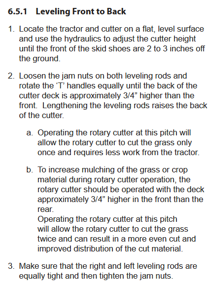

I would also check front to back leveling and set the front lower than the back:
602162d1556323749-drawbar-adapter-1800manualpage34-png

Here’s a version of the extended hitch point to eliminate binding that ovrszd mentioned.

Yessir, you are correct. It is the Titan 1810P. I did check those dimensions. I have over 10-inches vertically and the drawbar hole is right at 14-inches back from the end of the PTO shaft like the diagram shows. If I only had 8 inches, shown in the diagram, between the drawbar and the PTO shaft, I could ONLY mow on flat ground I think. I like to run the cutter pretty close to level, and if I lower the front, it reduces the amount of clearance I have to lift the cutter over stumps or big rocks. My challenge here is my Ozark ground that has lots of crooks and uneven ground. When I'm mowing the face of a dam, too steep to mow laterally, I have to back the cutter down the slope. The transition at the top uses ALL the clearance between the shaft and the bar. I was actually feeling vibration as the shaft's guard was rubbing the bar. That spooked me pretty good.

How close was your front to back level?
Aaron Z
   / Drawbar Adapter #47
Find yourself a used tractor dealer that has been in business for a long time, like 40 years + in the case of mine. They go to auctions and pickup most of what they sell and at auctions, anything is for sale, drawbars included. Take your old one with you and get a drop down (usually 2") with the same hole relationship and cross section....if that's possible. BTDT
   / Drawbar Adapter
#48
Aaron Z
Right now it's set so the front is about 1/2" lower than the back when the deck is about 2 inches from the ground...

Update: I win the dumbhead award, because when I remeasured the vertical distance between the PTO shaft and the drawbar... I don't know what I was drinking when I measured before... but the drawbar is only 7 inches lower than the point on the PTO shaft. So THAT'S why I have clearance problems. Duh.
