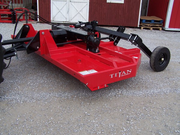

It is a Titan 1800P pull type. I haven't been able to find a picture of one on a tractor. This is all I could find back when I bought it, and still today...
Like I said, I'm happy with how the cutter performs, but I have to solve the driveshaft clearance issue.

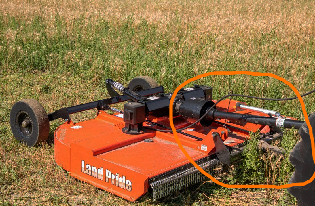

Not much clearance back about where the mower deck starts. Is that where the OP has tight clearance? I'd be doing some refab!
/ Drawbar Adapter #24
I’m guessing that is his clearance issue, looks to be a problem on those cutters.

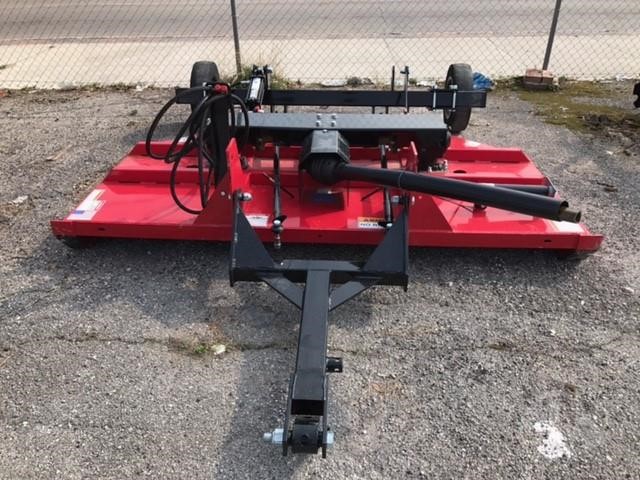

Most cutters with a high mounted hitch like that use a carrier bearing and two part pto for clearance. For a one single shat like that most have the hitch design so the cross tube and hitch are even or lower than the mower deck, such as these two bush hog brand cutters. IMG_0993.jpgIMG_0994.jpg

Your hitch design is a little different than the titan. The cross bar in the hitch is farther away from the deck allowing more clearance.
/ Drawbar Adapter
#27
Ah ok something like this. View attachment 601801
YES! That is EXACTLY it!
This picture shows my problem very clearly. On flat ground there would be no issue with it, but in the Ozarks we have crooks, ridges and valleys. If you're mowing over a rise, you can run out of driveshaft clearance in a hurry.
This more I look at the pictures, I don't think the hitch could be inverted. I guess I could look at drilling new holes, but that's some THICK steel to drill through.
When I wrote Titan months ago, they had no suggestions. My only complaint with the cutter.

In some photos it looked like there were some holes below where the tongue was mounted, so I went looking for some photos.
Found one:
Low mounted tongue.
https://www.tractorhouse.com/listings/farm-equipment/for-sale/18264993/2019-titan-implement-1808p
I didn't find any mention in a quick look at the manual.
http://titanimplement.com/assets/1700-1800-series-pull-type-operation-manual.pdf
Bruce
Wow! That looks better, but now I don't know where the leveling bars are going to attach. Can't wait to get a fresh look at my cutter when I see it tomorrow.

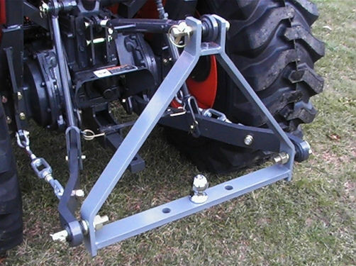

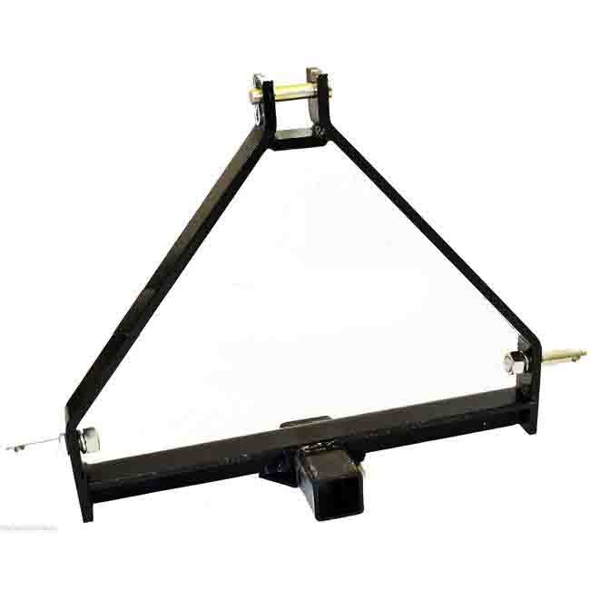

What about something like these, both are under $100:
/ Drawbar Adapter
#37
/ Drawbar Adapter #38
Yes. And these have the same issue with the 3-point possibly raising the hitch into the driveshaft too.
I don't think it would be bad to have the cutter further back though... I have plenty of driveshaft length.
