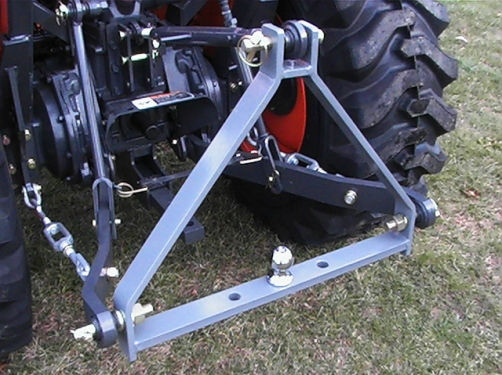

Ah ok something like this. View attachment 601801
It looks like lowering the connection between the tongue and deck with new holes would be the quick way to gain a good 3" of clearance. Tool rental places many times have a mag drill that would make the job easy. Changing the front of the tongue will not alter the geometry between the deck/tongue mount/pto shaft.

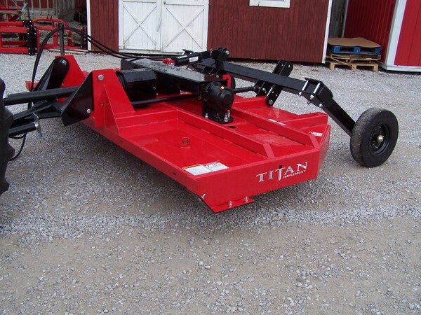

Wish I was a good drawer using "paint" or some other program. I'm left to try to explain my thoughts without the aid of eloquent language.....
Imagine the machinery sitting on flat ground, cutter deck level and at proper height. This "fixes" the cutter gearbox input shaft at a constant elevation. The PTO output shaft of the tractor is also fixed at a constant elevation. The hitch pin is between the two and at a given elevation.
The problem as I understand it is the PTO shaft comes in contact with the hitch near the pin area?? Let's clarify that part first. I went back and reread the original post. I believe this to be the problem???
If so, the hitch mount on the cutter frame modification won't solve anything. As I mentioned earlier the hitch will need enough adjustment to move the gearbox back to the exact elevation it was before. This must be done to get the cutter back to level and the predetermined cutting height.
We can't change the elevation of the tractor PTO output shaft.
Only thing left is to change the elevation of the hitch pin.
Hopefully I'm missing something and this will all work itself out with the modifications that have begun. I'm anxious to see the results. :)

You can see where the pto shaft is the closest to the tongue weldment.

AHA! This is where MY eloquent language has failed us. No, the clearance problem is the gargantuan (eloquent, no?) crossmember further back on the tow bar rises way up and becomes a clearance problem with the center area of the driveshaft. When the tractor crests a hill and the cutter is still downhill, the guard near the middle of the driveshaft is rubbing that crossmember.
This picture shows the spot of contact. As you can see, there's plenty of room at the hitch end and the gearbox end. The middle member is the problem.
Also, If I changed the location of the holes on either the cutter or the sides of the tow bar, it would change the ratio of how the leveling bars work. And the leveling bars can't go closer to the deck because of the top reinforcement on the deck.
Pretty sure I'm on the right track here... and I hope so, 'cause the welder has it now. :-#

Yep....cut apart and refab your circled area with 5"+ clearance and you should be good to go.:thumbsup:
/ Drawbar Adapter #67
Yep. I get it now. My theory is incorrect. The change needs to be made at the cutter. Not sure cutting and angling the tongue will help. We'll see.
Thanks for the clarity.

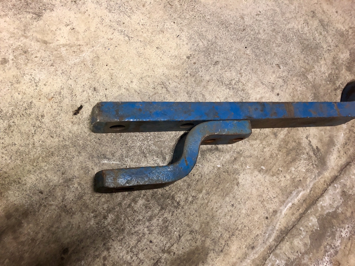

I’m glad you got it fixed. Correct me if I’m wrong but looking at the pics you’ve lost some maximum cutting height because the hitch point is lower.
Wouldn’t a reversed offset drawbar or an offset added to a straight one have accomplished the same thing without altering the mower’s hitch? Or would you still have PTO shaft interference?
Drawbar with offset like this
Yes. It has lowered the maximum height, which I expected.
And yes, the offset drawbar is exactly what I was looking for at the beginning of this post, but I discovered that if I lowered it 6-inches at the drawbar point, I could have some high-centering issues. I feel like this is the best solution.
