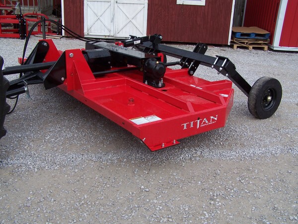

Ah ok something like this. View attachment 601801
It looks like lowering the connection between the tongue and deck with new holes would be the quick way to gain a good 3" of clearance. Tool rental places many times have a mag drill that would make the job easy. Changing the front of the tongue will not alter the geometry between the deck/tongue mount/pto shaft.

That might work if the crossbar is higher than the front of the deck, drill new holes a little lower in the red part.

Wish I was a good drawer using "paint" or some other program. I'm left to try to explain my thoughts without the aid of eloquent language.....
Imagine the machinery sitting on flat ground, cutter deck level and at proper height. This "fixes" the cutter gearbox input shaft at a constant elevation. The PTO output shaft of the tractor is also fixed at a constant elevation. The hitch pin is between the two and at a given elevation.
The problem as I understand it is the PTO shaft comes in contact with the hitch near the pin area?? Let's clarify that part first. I went back and reread the original post. I believe this to be the problem???
If so, the hitch mount on the cutter frame modification won't solve anything. As I mentioned earlier the hitch will need enough adjustment to move the gearbox back to the exact elevation it was before. This must be done to get the cutter back to level and the predetermined cutting height.
We can't change the elevation of the tractor PTO output shaft.
Only thing left is to change the elevation of the hitch pin.
Hopefully I'm missing something and this will all work itself out with the modifications that have begun. I'm anxious to see the results. :)

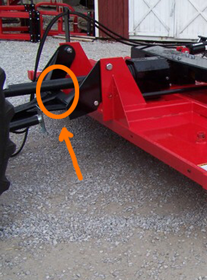

You can see where the pto shaft is the closest to the tongue weldment.

AHA! This is where MY eloquent language has failed us. No, the clearance problem is the gargantuan (eloquent, no?) crossmember further back on the tow bar rises way up and becomes a clearance problem with the center area of the driveshaft. When the tractor crests a hill and the cutter is still downhill, the guard near the middle of the driveshaft is rubbing that crossmember.
This picture shows the spot of contact. As you can see, there's plenty of room at the hitch end and the gearbox end. The middle member is the problem.

Yep....cut apart and refab your circled area with 5"+ clearance and you should be good to go.:thumbsup:

Yep. I get it now. My theory is incorrect. The change needs to be made at the cutter. Not sure cutting and angling the tongue will help. We'll see.
