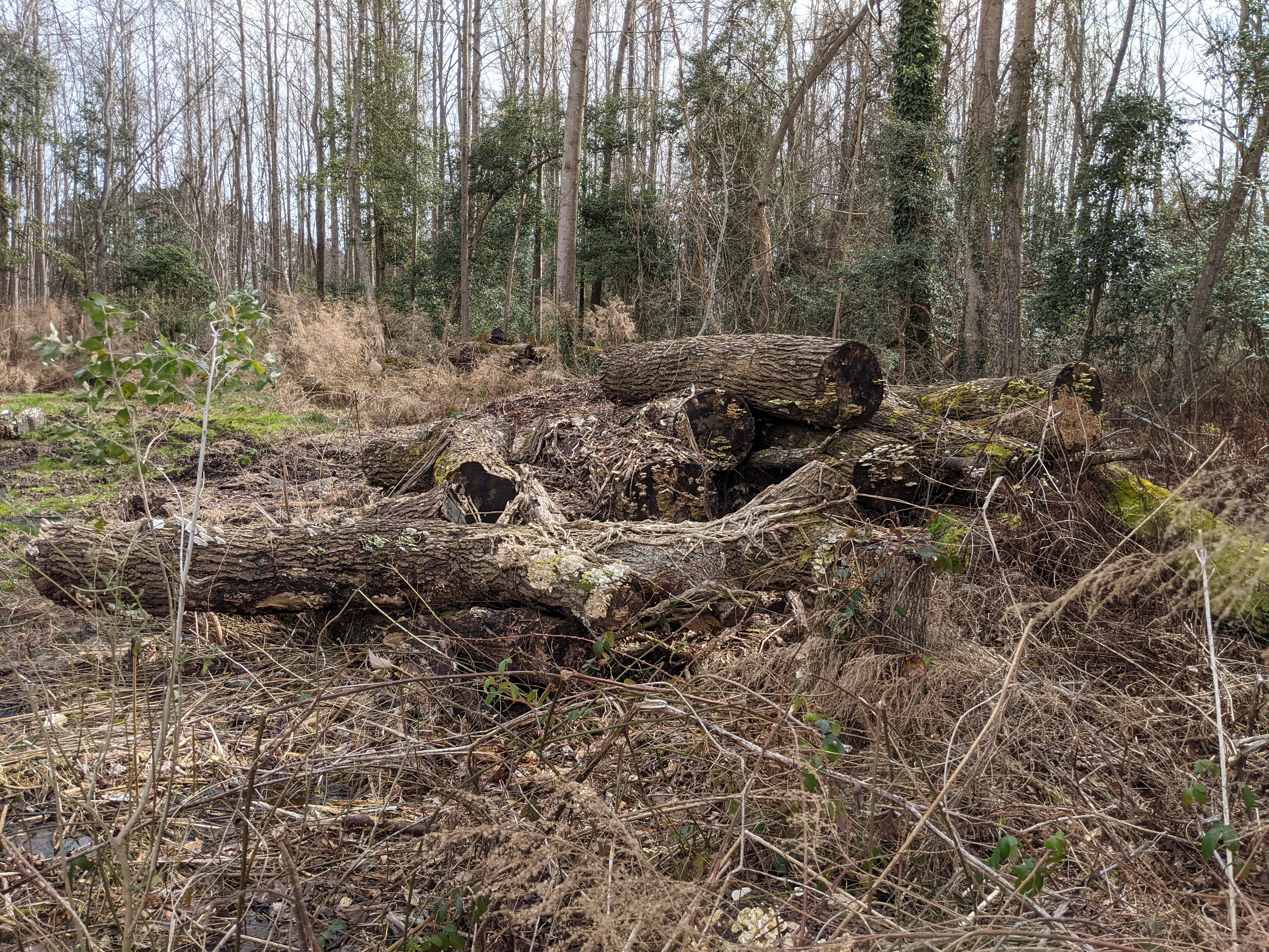

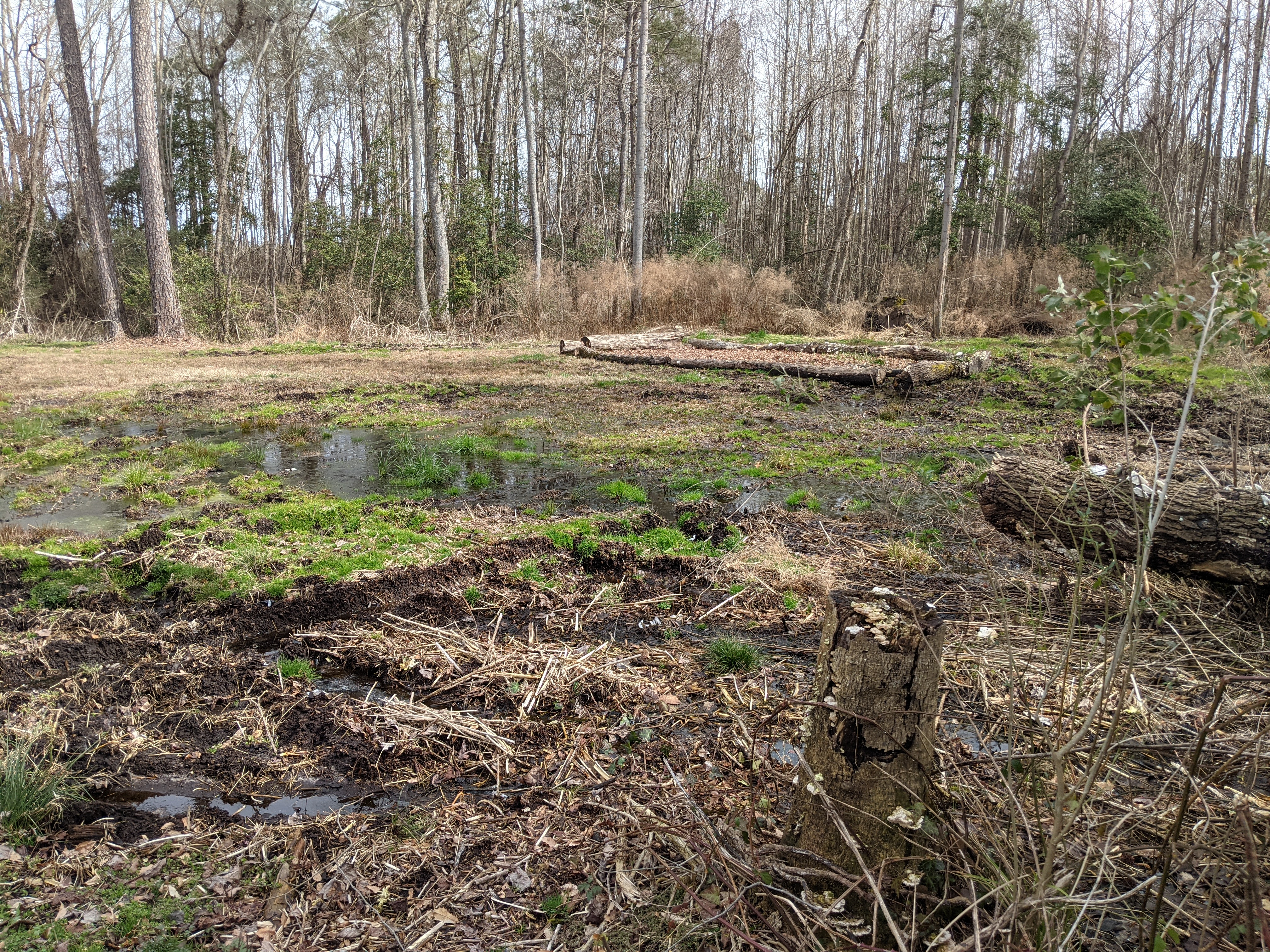

My entire backyard has had standing water since I moved into my house in December. I suspect it's primarily due to compaction, as the previous owners had a good 15+ trees cut down back there. The standing water seems to be in all the ruts created by the tree trucks. Fortunately for me, they left all of the logs stacked on the edge of the yard. Unfortunately, they're far too big for a chipper.
My plan is to scrape the entire back yard down about 8 inches or so with my FEL. Next I'll cut the logs into 4 inch strips, and use them like pepperonis to fill in the excavated yard. The next layer will be mulch and other compost type material, and then I'll finally cover it all with the dirt I originally dig up. Any input on this idea would be appreciated, not entirely sure if it's the best way to do it but it's the best way I can think of using the materials and equipment I have.
View attachment 691055View attachment 691056
Aargh, sounds like a recipient for disaster. Bring in a couple hundred yards of fill and build it up.

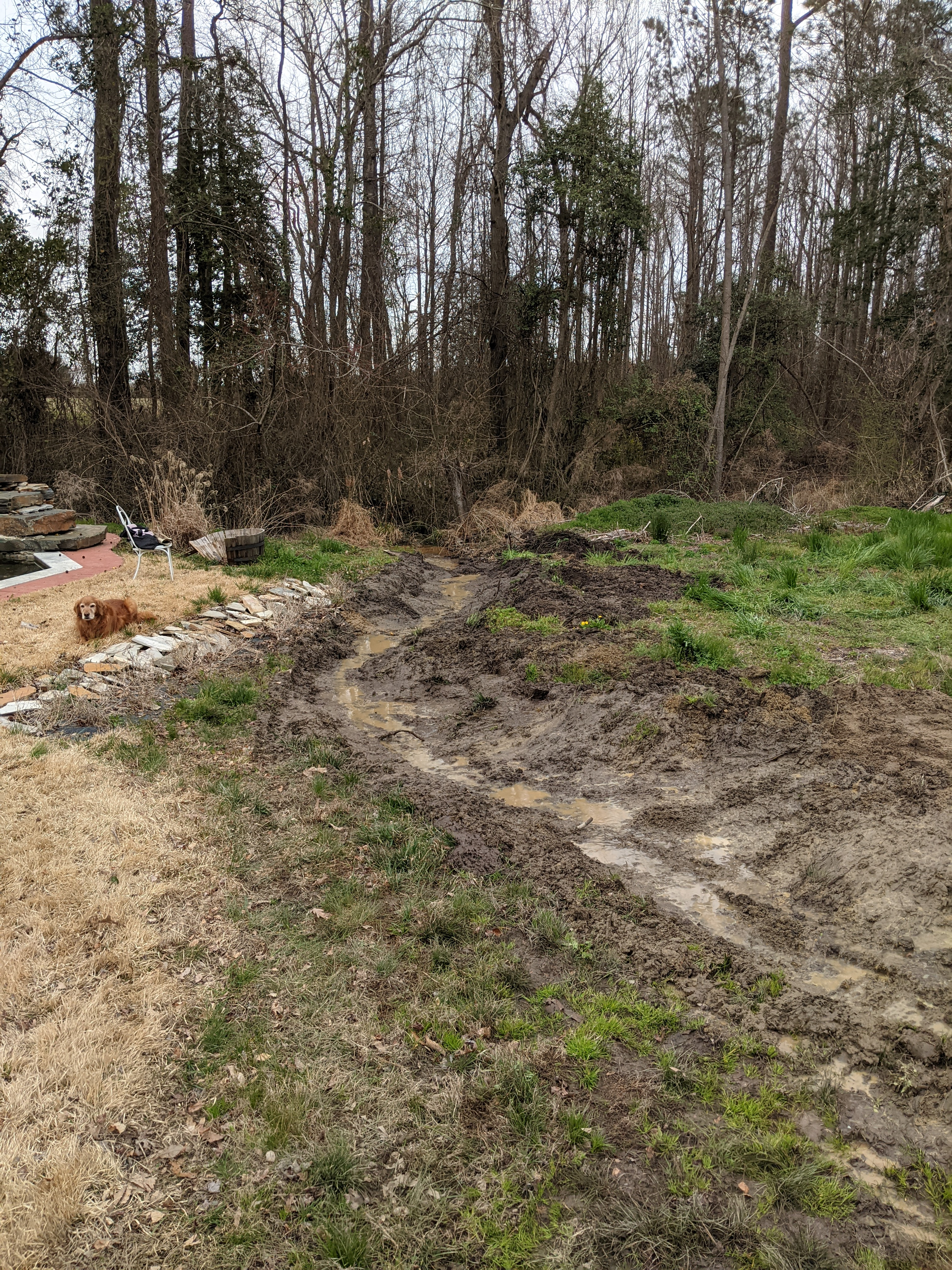

Well over the last few months I was able to put in about 200 feet of drain pipe
Old and Tired was extremely generous and dropped off a sub soiler, I made multiple passes to loosen things up. The area was already somewhat lumpy, and now it was completely rutted. Figured a complete resurface was in order, so I went over the entire area with a box blade followed by a tiller.
Next I spread about 13 or so yards of topsoil over the lower patches.
Finally, I was planning on reseeding. However, the grass has come back with no help from me. It's still fairly thin and patchy, but I'm going to wait until spring and then just overseed as needed.

This is what it looked like before I started!

Looks good, but its hard to tell what the wet rainy freeze season will bring......
Hopefully the drainage you put in will be effective
/ Draining my backyard swamp #49
I'm not sure where you are but if that piece of property were in SC it would be wetlands which can't be drained without creating replacement wetlands somewhere else. The fines for draining wetlands are huge.
