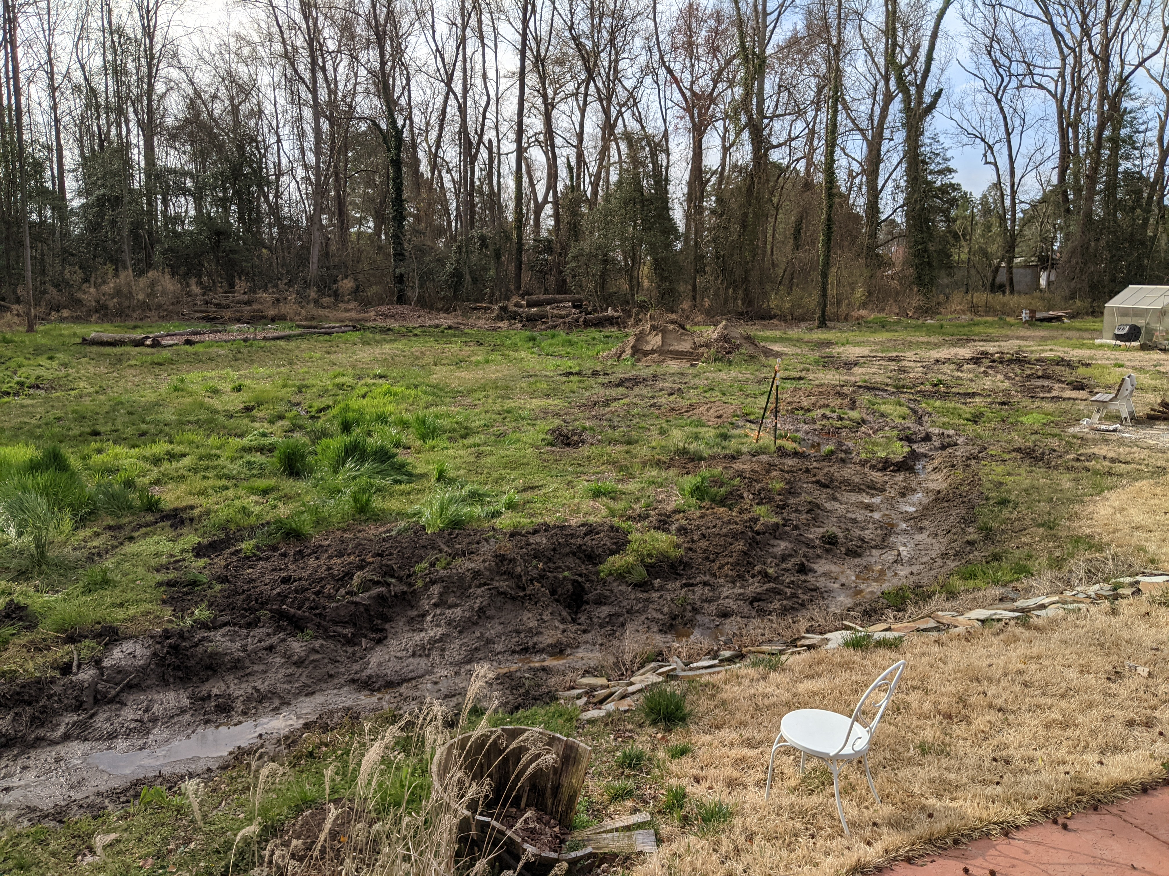

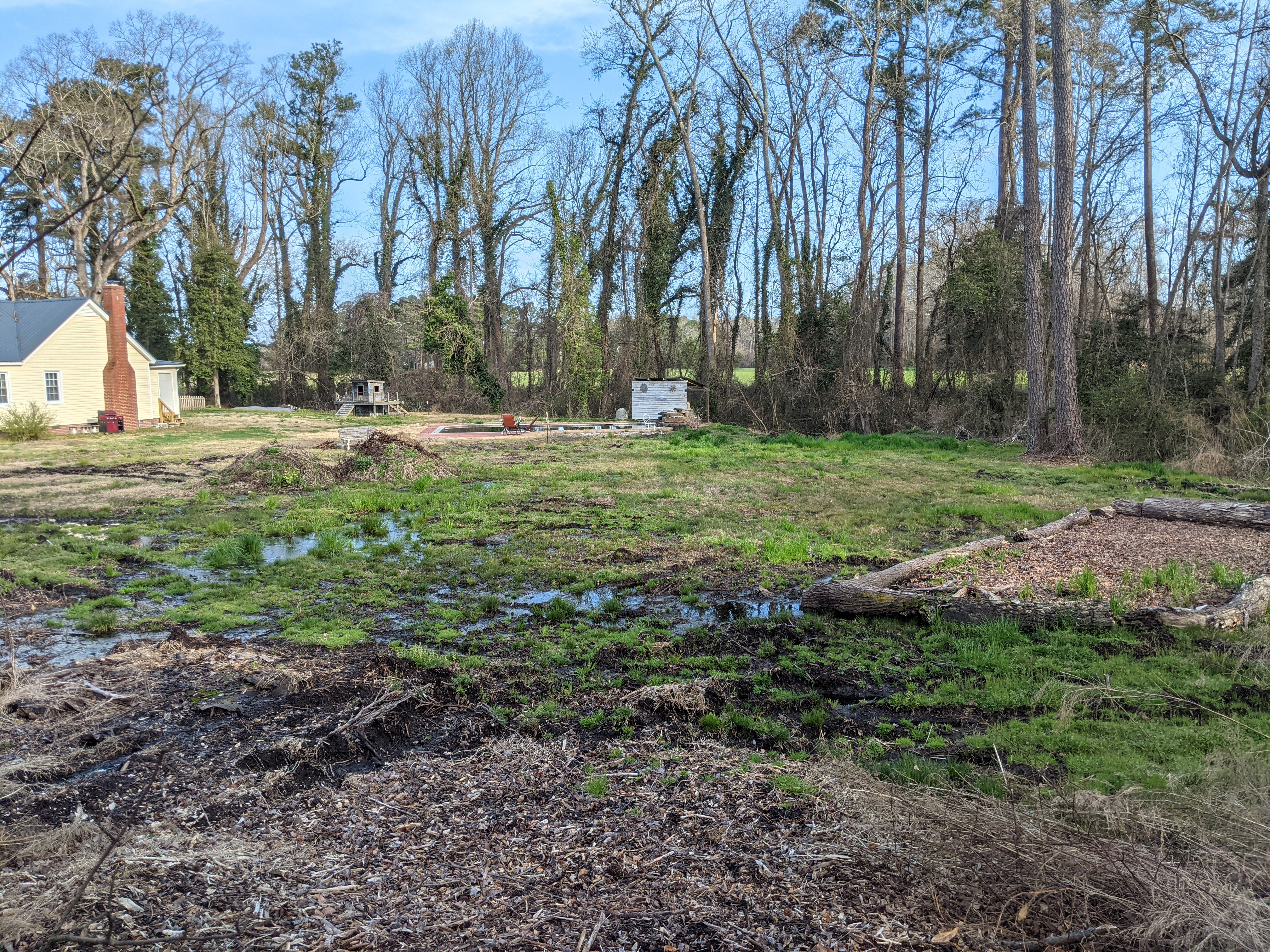

My entire backyard has had standing water since I moved into my house in December. I suspect it's primarily due to compaction, as the previous owners had a good 15+ trees cut down back there. The standing water seems to be in all the ruts created by the tree trucks. Fortunately for me, they left all of the logs stacked on the edge of the yard. Unfortunately, they're far too big for a chipper.
My plan is to scrape the entire back yard down about 8 inches or so with my FEL. Next I'll cut the logs into 4 inch strips, and use them like pepperonis to fill in the excavated yard. The next layer will be mulch and other compost type material, and then I'll finally cover it all with the dirt I originally dig up. Any input on this idea would be appreciated, not entirely sure if it's the best way to do it but it's the best way I can think of using the materials and equipment I have.
View attachment 691055View attachment 691056
Just cut a swale so the water can run off. Digging up all the topsoil is not a Good idea.

Yeah good advice in here so far. Since you appear to have modest elevation to work with, all you truly need is to contour the land so that nothing puddles and it all gently flows away, down your swale.
Your original idea to put wood underground and cover with mulch would have been a total disaster of soupy black muck in a couple years. If you do import material to raise the land, go with sand or sandy loam.
But other people from NC have been on here complaining about the excessive rainfall and wet conditions. Since you just moved it, I would give it a bit and learn the seasonal nature of your property.

The drainage swale you dug should work, provided it is in the low spot of your "swamp". Once it dries out a little, plant some sort of grass seed over the whole area. Vegetation soaks up a ton of water. Depending on where you live, a creeping kind of grass would be great, because it will eventually grow into the drainage swale and protect it from eroding further.

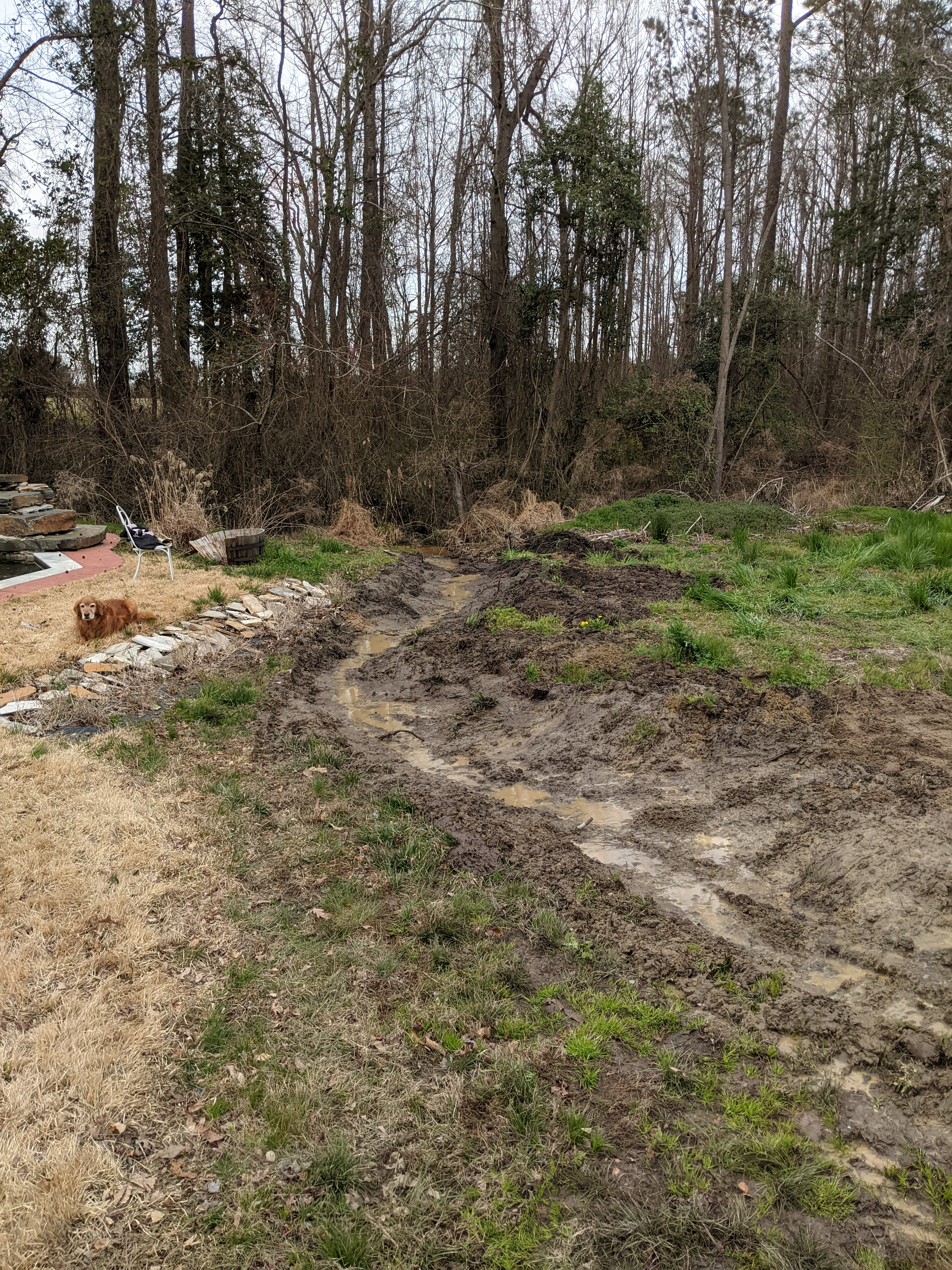

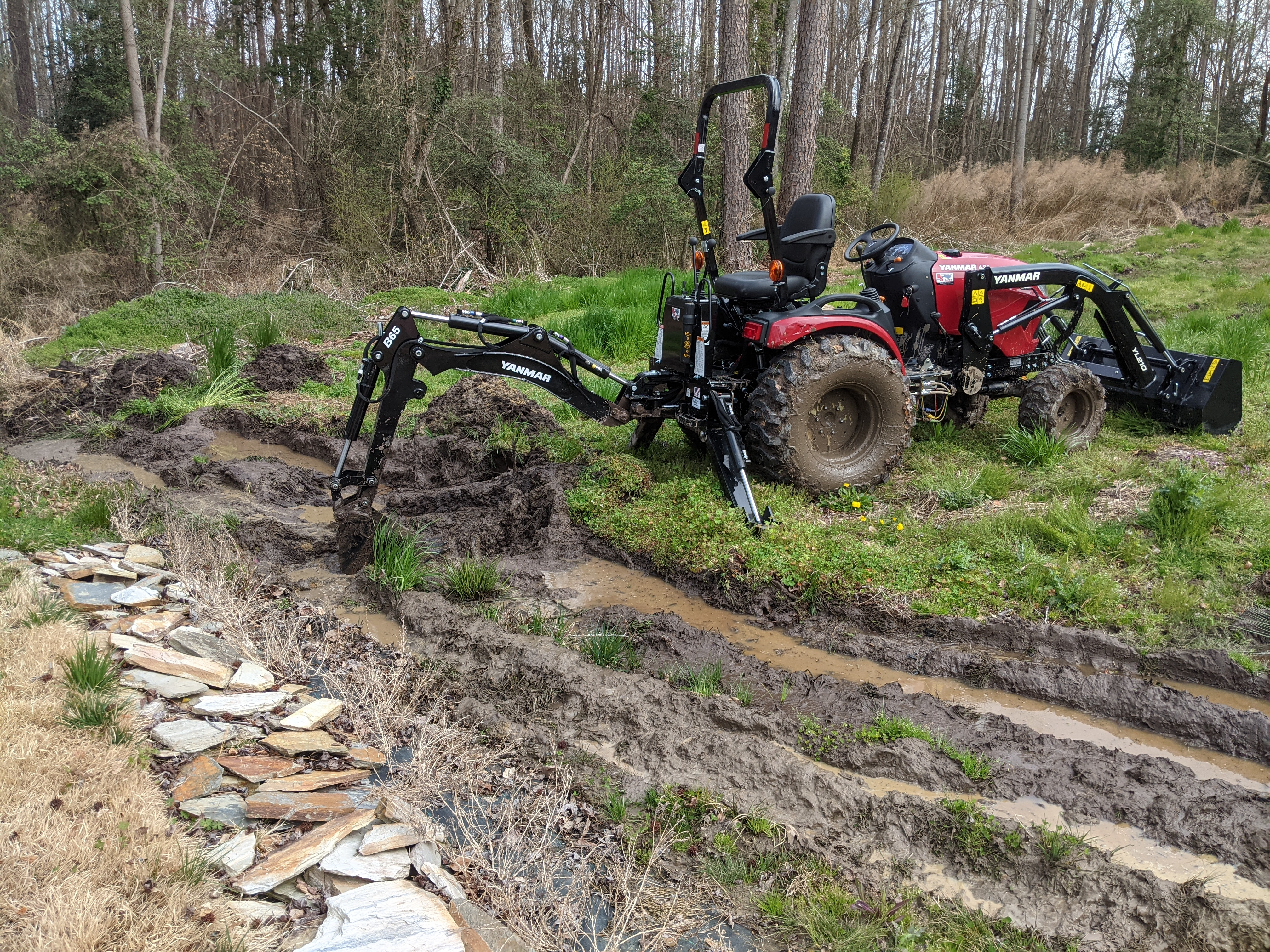

I did start a swale yesterday, and it's difficult to see but the yard does have a gentle slope towards a creek behind the yard. Would the swale along one edge be enough if I can fix the compaction issue? Or do I need a drain through the middle as well? I was also thinking about a dry well. My thought behind burying the disks was to raise the overall level of the yard, but I think it would require several loads of mulch and fill dirt to prevent the lumps. I'll get some better pictures today to try and show the whole layout. View attachment 691085View attachment 691086
Unless you always want to have a muddy ditch through your yard and as you have a creek to drain it to, this looks the perfect application to install Hydroblox. We've used them successfully to drain flooding areas and they work better than any french drain and better than most ditches, in my opinion. Plus, you can have a perfectly smooth dry lawn then.

Let the swale do the work of starting the drying. Here in NC we just had the second wettest winter on record (just 0.03" shy of a new record). Things are finally drying out around here. Depending on where in eastern NC you are, you may also be dealing with clay near the surface. The suggestion of the cereal grasses to break up the compaction is a good one for our area but you may have to do it over a number of years if the clay is close to the surface.
If you find the single swale isn't cutting it, you can then move onto the second one up the middle or do a buried drainage line (or lines) through the center if you don't want to see the swale there next year.

In digging the swale, I hit the clay layer about 8 inches or so below the surface. I have seen substantial improvement in the two days since digging it though, even now water is still flowing through it pretty good. After the middle parts dry I'm going to see if I can regrade with a box blade. The bottom part of the yard has a sizeable slope, while the top part is flat. I think if I can grade it all and make a continuous gradual slope, while grading out the current ruts, that might be sufficient. If it's not, then I'll add a drain, something like the hydroblox maybe. Finally the cereal rye to help the overall long term aeration of the area.

Thank you everyone for the excellent advice. The swale is already doing wonders, and I'll find some other projects for my new tractor until it dries out enough to continue working the yard.
