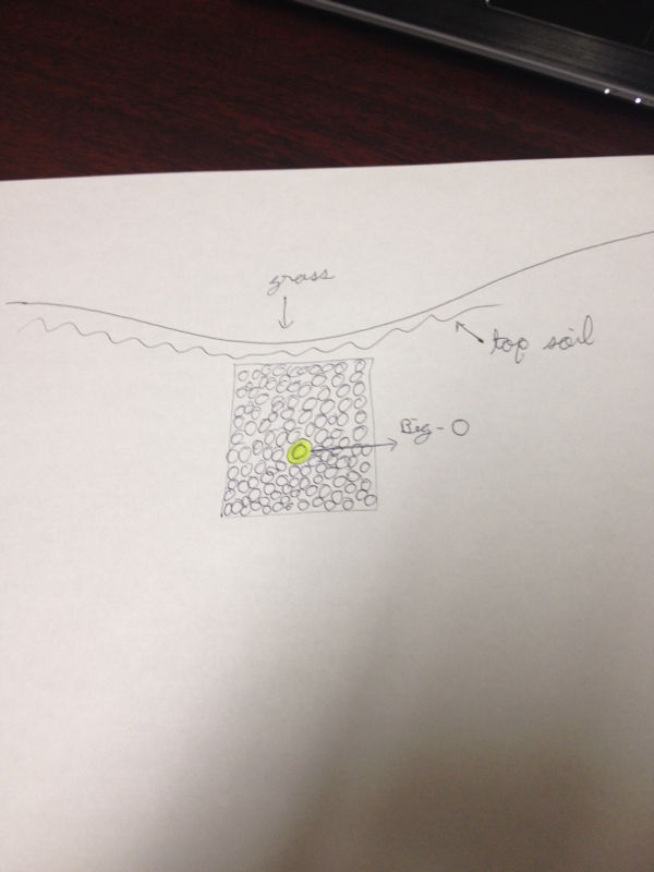

A big-O is what we call it up here dig a shallow trench put about a foot of 3/4 clear and about an other foot over it then a geo textile sheet over top then top soil and seed and now you have a wet spots that will always be dry and your pipe goes into a hole filled up with rocks or out into a ditch the sock on the pipe prevents dirt from getting into it makes it last much longer The other way will work but for how long

The socks "goal" is to keep the mud and dirt from slowly filling the pipe. I wrapped some before and they are working great years later. Maybe it would have worked for a while without the wrap but for the little added cost figured it was worth it to not have to do it again.

All farmers do it with a sock dig a trench and back fill! It will work but the best way is with rock and yes big rocks will work as good or better then small ones the only thing there might be a shift and cause little sink holes in the surface

We have guys that use this method In ditches to get ride of water fast after a storm it works amazing but if your using big rock you'll need to put geo textile over the rocks to prevent the top soil of going into the big cracks of the rocks
