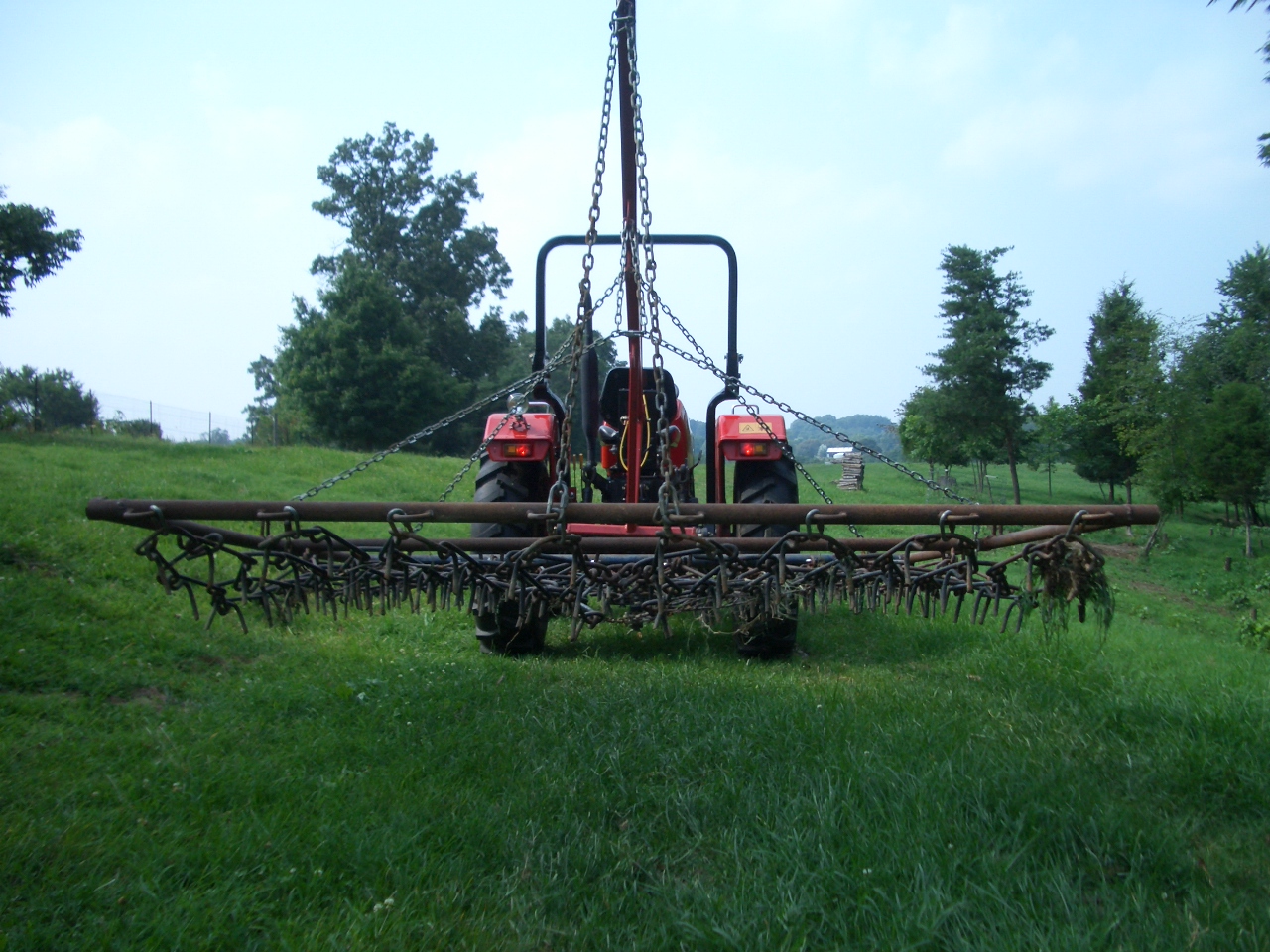

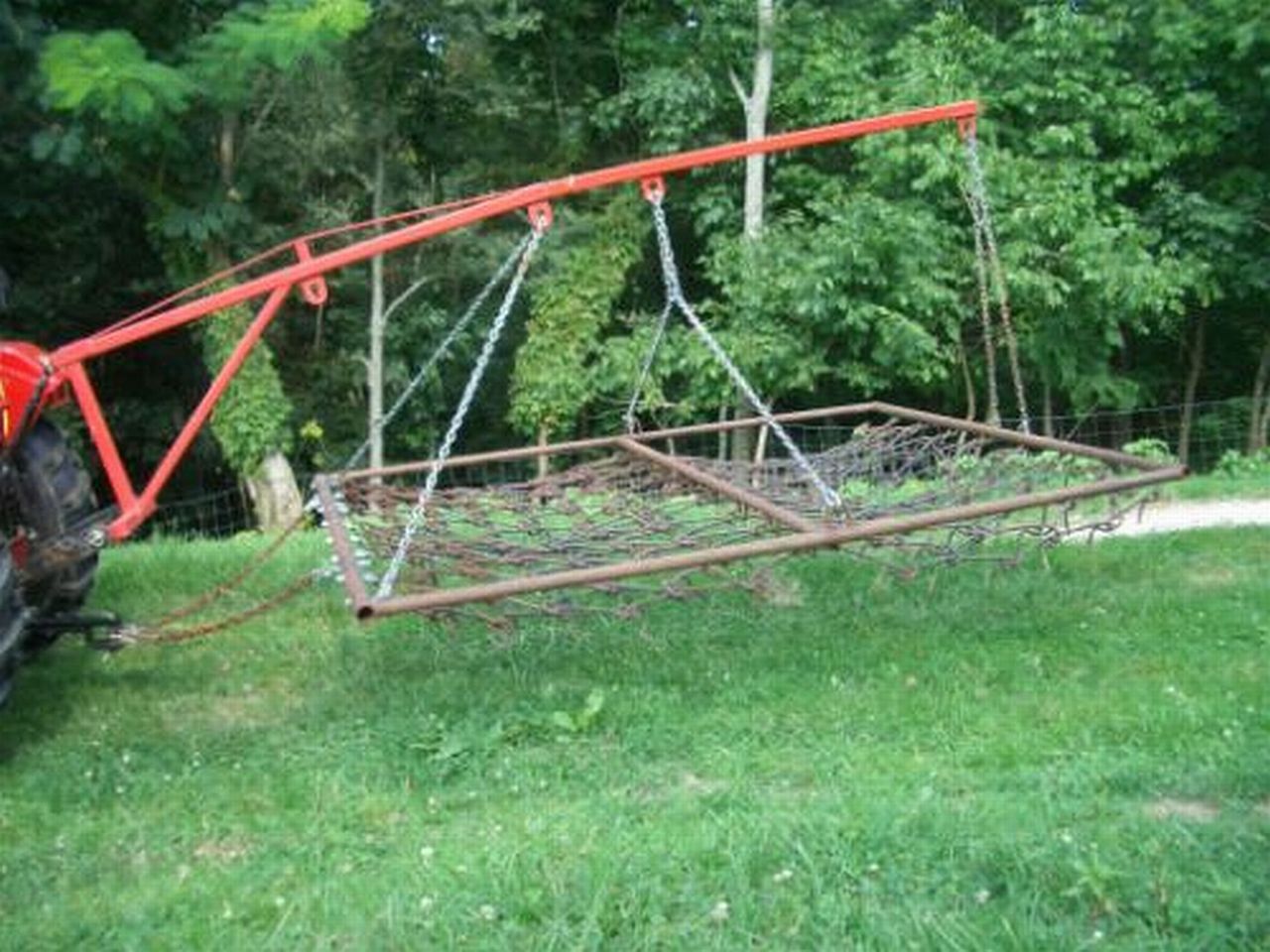

I didn't want to pay that price either. I bought 4 squares and assembled them in an 8' x 8' configuration. Starting with the 8' tow bar, I used three more sections of pipe to make a frame around the harrow sections. Attachment points are U-shaped pieces of rebar, harrow is attached to frame with connecting links. It can be flipped over for simple smooting work. But if I had to do it over again, I'd put a tow bar on both ends to enable towing in either direction.
Then I lift the whole thing with an extended boompole. Word of caution with this design though, it's very hard on toplinks.
