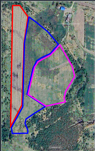

What app/program did you use to make that map? We have 38 acres for hunting, and the SIL wants to map it out like that.
yeah knowing wont help you lol.... I used the drafting program from work called AutoCAD and I print screen maps from google map and paste them on AutoCAD, scale them to scale and used them.
   / Farm Field Rehab for Fescue #17
Thanks. I only used AutoCAD once or twice, but that was years ago and don't have access anymore anyway... We'll look into the GIS suggestion.
