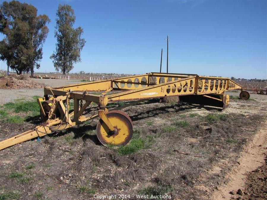

If you lived in flood irrigation territory, the old long landplanes are cheap as the leveling companies have shifted to laser-controlled scrapers.
High bid: $585
West Auctions - Auction: Tractors, Farm Equipment and Implements in Northern California ITEM: 14'x6' Marvin Landplane
Bruce

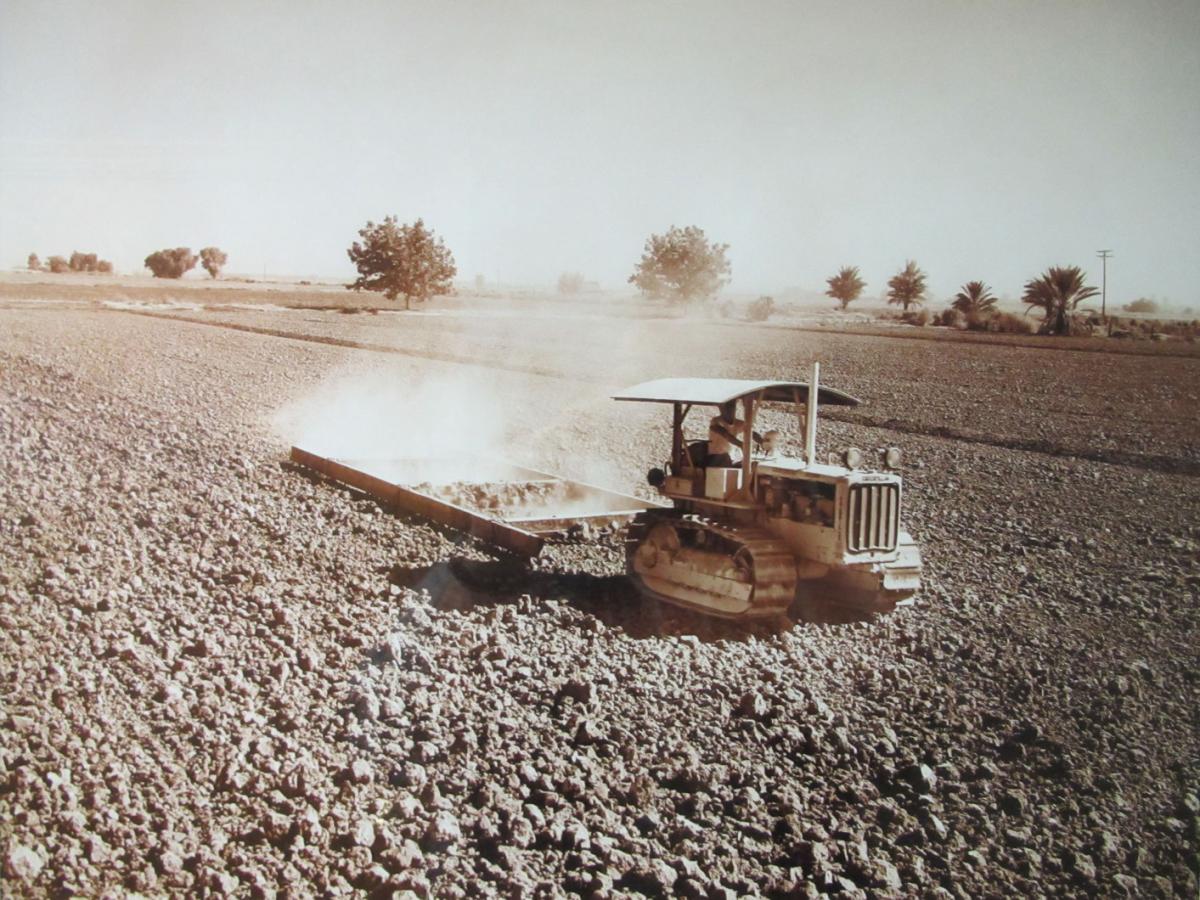

Before the long steel land planes became common, almost every large farm had a wooden one.
Bruce

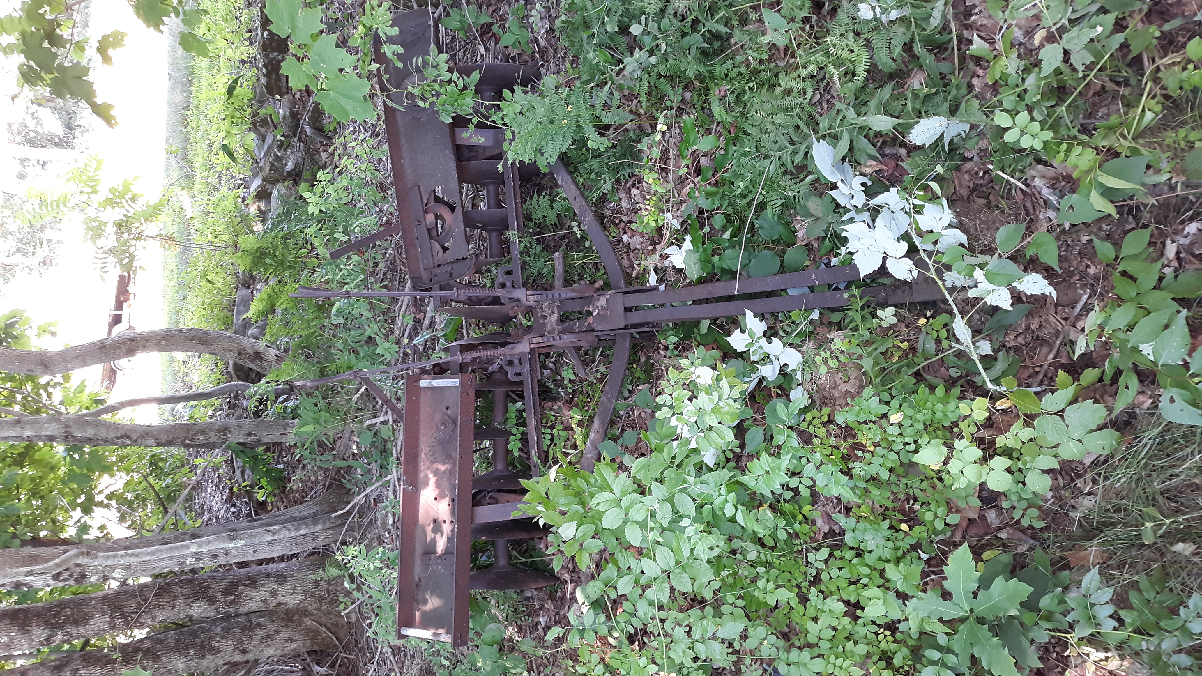

I found a 9 - 10 foot double disk harrow with a hydraulic piston and wheels for decent money this morning. I talked with the owner who does farming. He told me that my 45HP Kioti with HST was too small to pull this harrow. We got to talking and he said he has bogged down his 70HP tractor using this harrow. He now has a much bigger one that he pulls with a 135hp tractor. He said a 6 or 7 foot would be the biggest that I probably could pull as long as I wasn't going too deep with the disks. He suggested using a rototiller on the fields or have if plowed. After that to go over it with a disk harrow of grader planer. I can always drag a section of chain link fence over it afterwards if it still needs more leveling. I have plenty of fence and poles. After looking at disc harrows for sale I remembered that my FIL had one back in the 70's that he parked in the woods out behind the barn at the farm. I had forgotten all about this. Sure enough it was still sitting out there in the thicket. I dug it out and it still spins and the levers and adjustments on it still work. One of the rock pans needs replacing. The discs are of the smooth type and it is only a single harrow.
