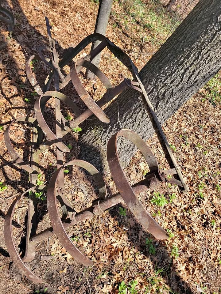

My cousin's daughter just bought some hunting land. I bought this old spring tooth as a welcome to thge neighborhood gift.

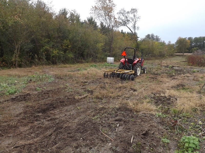

A disc harrow with 2-gangs. Notched discs up front gangs and rear smooth discs.
Food plots can vary in small open areas.
The trouble with a tiller is hitting tree roots or large rocks. It can explode a tiller gearbox in 1/2 a second.
Then you can use the same tool for the home garden.
