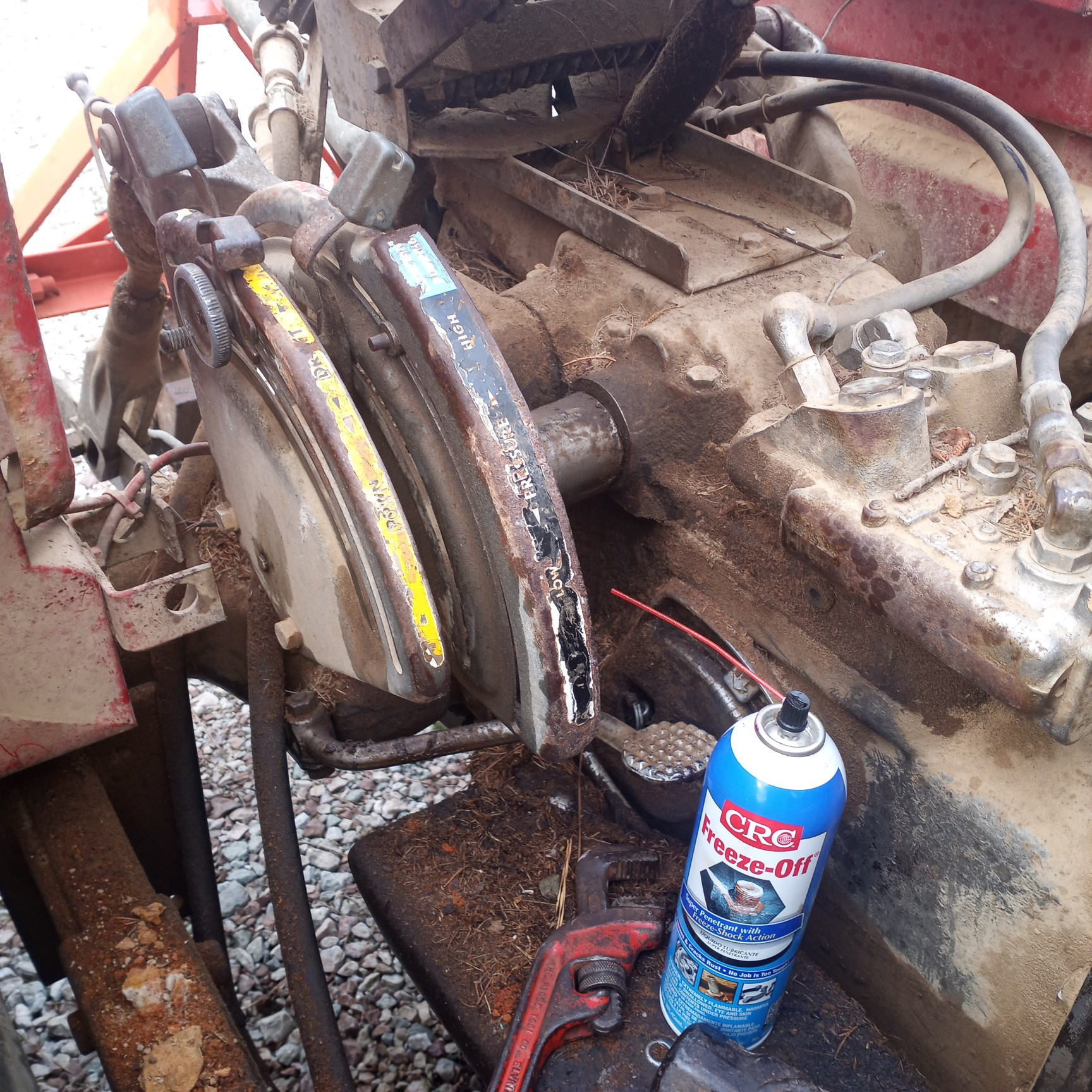

Pressure Shift lever won't move as it is rusted up. The draft lever works well. I put WD 40 on it and a pipe wrench but no luck. Does anyone think it may just be rusted bad and I need to heat it? Or what I can check?

Welcome to TBN. A little heat couldn’t hurt. Hopefully it’s just rusted and can be loosened up working on it externally.

Thanks I'll try that this weekend to see if it moves any. Up Down lever has always worked fine, I never used the other one it has always been stuck

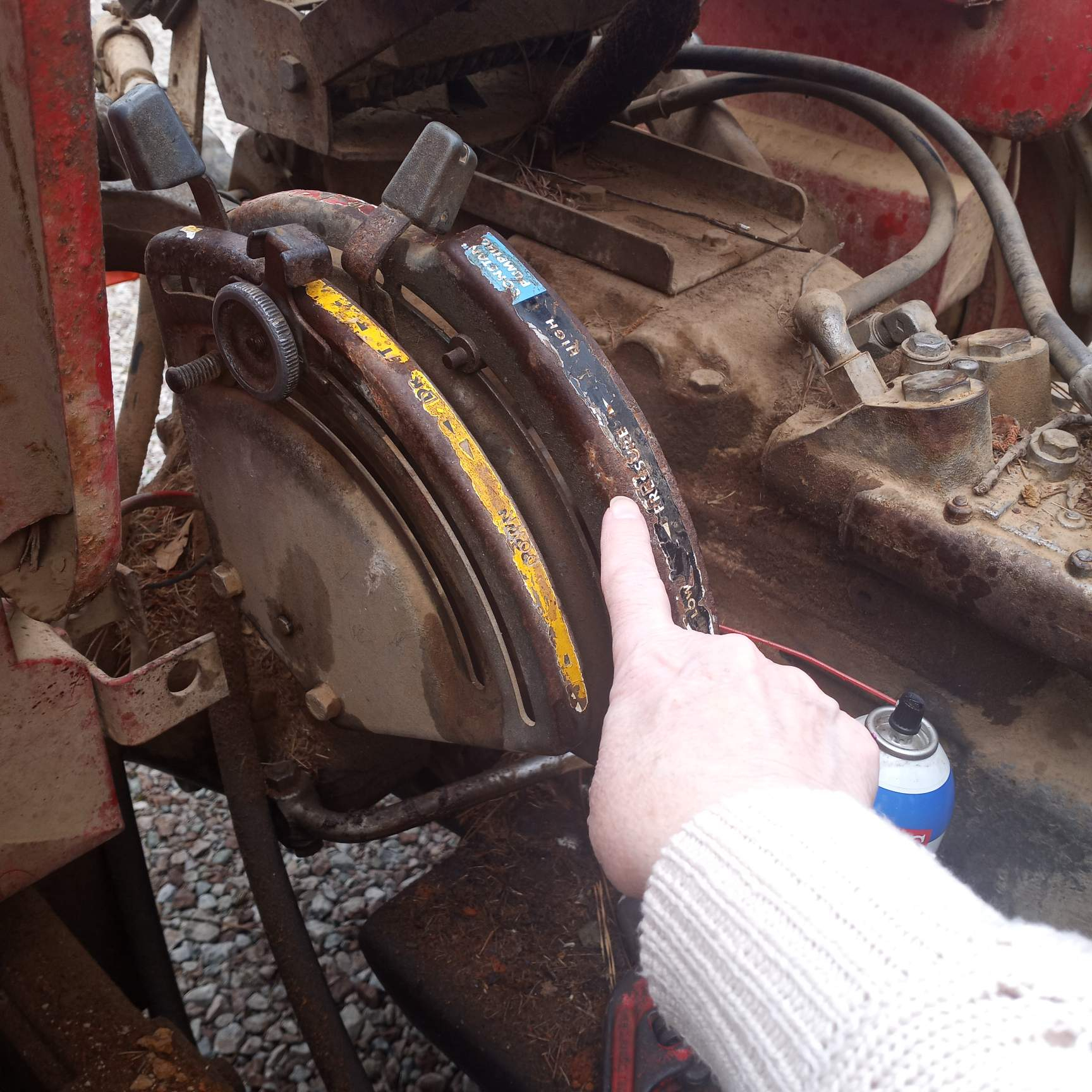

OK That worked after a lot of heat and 30" pipe wrench and a man helping. I was told that that lever has not moved is over 30 years. But now I can't read the writing on the plate to see where I need to run theat leaver. Who has an old emblem like that or a pic so I can see it (175 Massy )

Thanks I can read part of it. I need a new sticker who ever has those. I really don't know where to leave that lever now. I noticed that in some places it changes the motor sound

If the inner (position or lift control) lever is all the way back (turquoise) color in photo, the pump will run constantly against the relief.

OK so when do I do that and is it best to not run constant?
Yes, don't do that. Raise to just before that

Try pbBlaster for penetrating oil next time ... lots better than WD. Don't forget to lube up those levers to keep it from rusting up again (something better than WD-40). FL humidity & salt air does a number on metal. Can try dry lube if you're worried about dust/sand sticking in there & building up (McLube SailKote lasts a while). Also ... belated welcome to the site. Lots of helpful folks on here. Enjoy the tractor, what are you growing on the farm.
