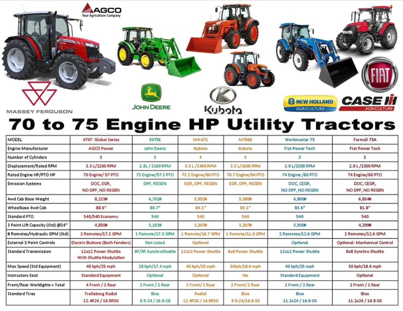

Hi there,
I am new to the tractor game, I am trying to take my time and absorb as much information I can before I pull the trigger on a tractor.
Can someone explain to me why some tractors (MF 4707 / NH Workmaster 75) don't need a DPF and others in the same class (5075e / M4D-071) have a DPF? Everything I can find indicates that DPF is not desirable and will only serve to increase your initial cost and maintenance over time.
The Kubota salesman I talked to said new holland might be using engine credits or something. But would that mean that the consumer is just better off taking advantage of the companies using those credits? Assuming everything else is equal, is it in my best interest to choose a tractor with no DPF?
Thanks for coming to my ted talk
Morgan
My .25c worth.....Simply put if you don't need the 75+ HP don't get it and thus stay away from the urea. Urea = just another thing to fix when broken. 75 hp is a pretty big machine. Lots of work gets done with 50hp. Consider what you will be doing with it then compare physical size weight lifting capacities etc. Some times within a brand there is not a whole lot of difference between machine capacities besides HP.
