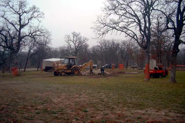

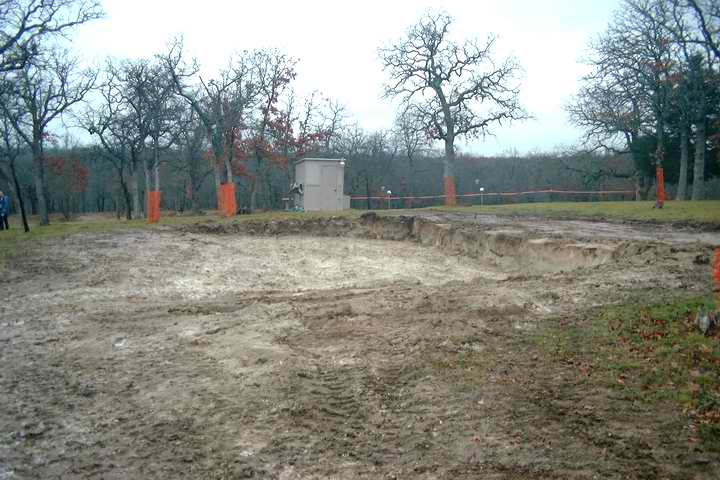

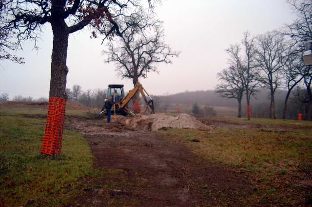

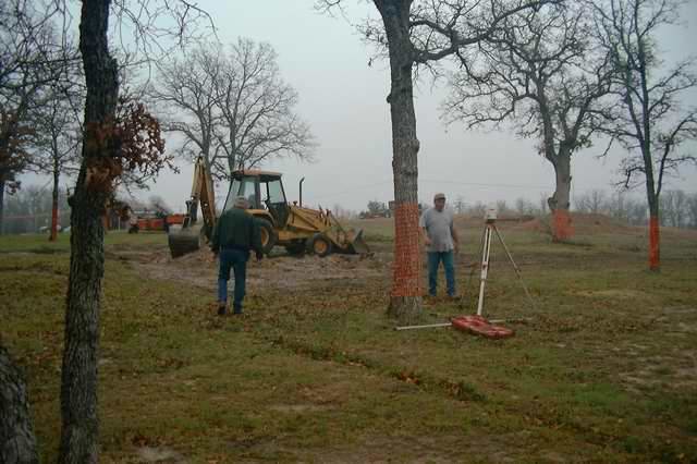

Bob, here are some pictures of the excavation for my house using a LBH. The first step was to shoot the grade to determine how deep the excavation would be when finished. This was done after removing several trees the size of the ones in the photos using the method Eddie described.
Next, they dug a trench at the deepest point down to final grade.
Finally when the trench was finished, they turned perpendicular to the trench and started taking out the slug of dirt dow to the final grade and measuring many times using the transit to establish a flat final elevation.
This was a simple job, but shows the technique. this excavation was basically a 4 hour job including hauling and piling up the spoils that I helped with using my tractor's FEL.
