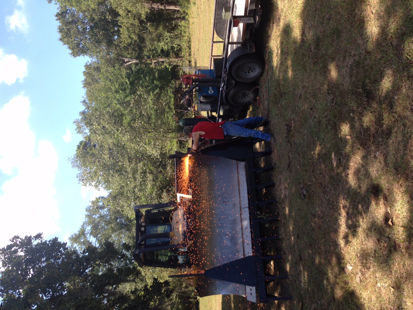

To answer your question, both.
Rent...the only reason I bought a dozer is we are selectively clearing and taking our time. I did add a root rake and it works very well.
