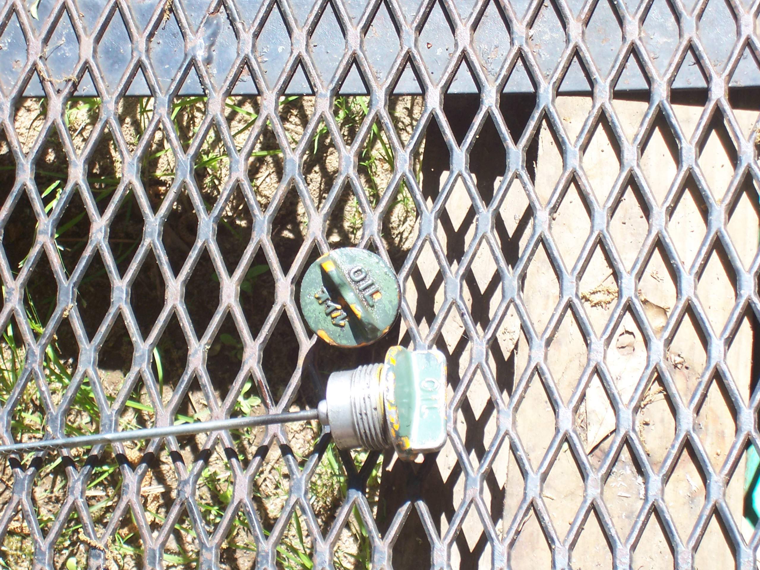

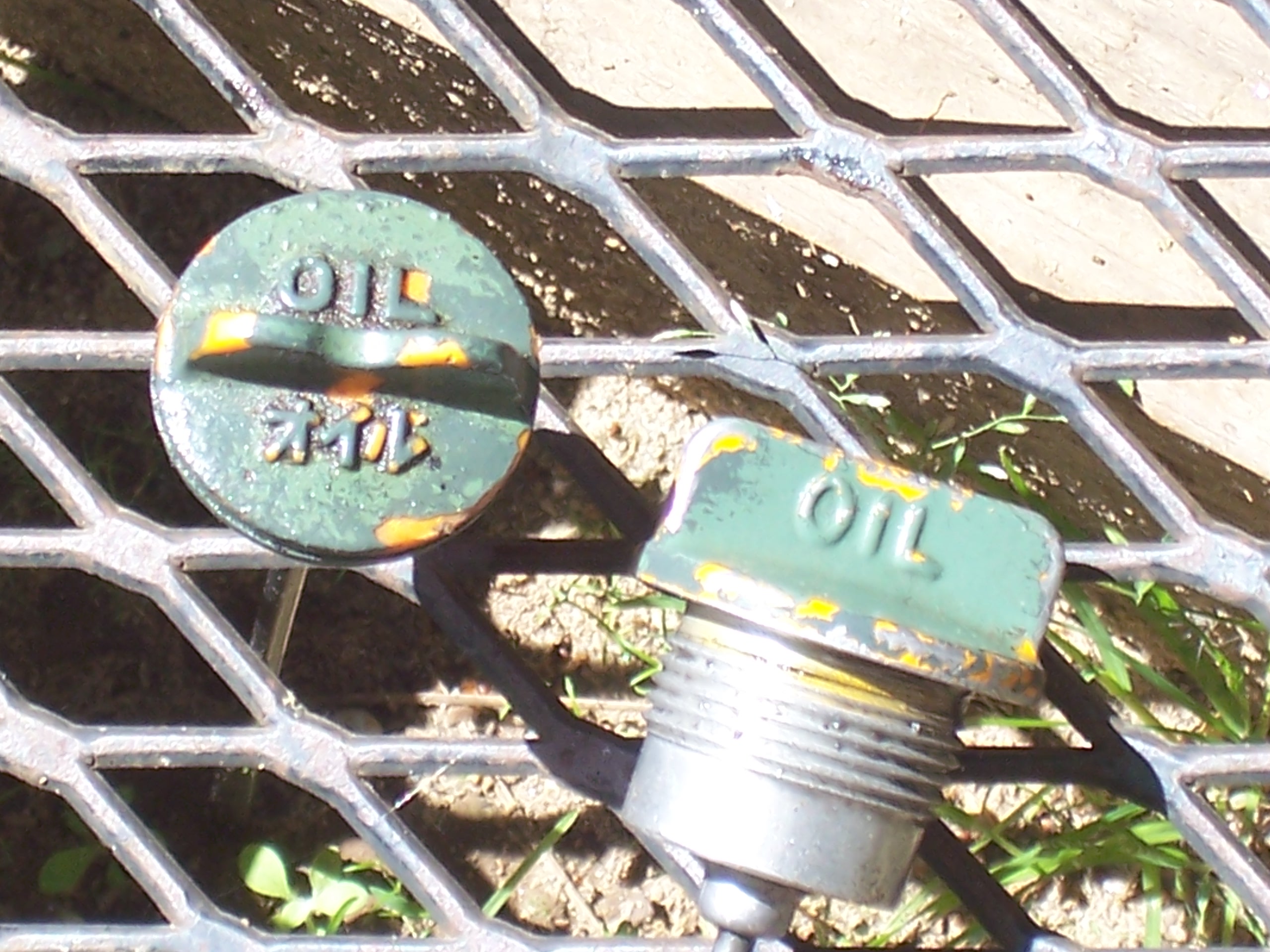

I should have started with this... here are a couple pictures of the 2 dipsticks. Between them is a US quarter for size reference. Both sticks are metal. The crosshatched pattern on the long stick is only about 5/8" long. The shorter stick was in the engine oil, and the longer one in the hydraulic fluid.
I'm sure I didn't switch them, but I'm wondering if the previous guy might have. (That's my story, and I'm sticking to it!! :D)
Not sure if the ones from my 1700 are original, but are what came with it when I purchased the tractor, Seems to be slight different then the other ones shown, the 2 dipsticks are almost equal in length,
The hydraulic stick is plastic and measures from the O-ring to the tip 7 7/8
The Engine stick has a larger metal cap and measures from the O-ring to the tip 7 3/4
each have 710 as well as the Japanese writing ( OIL ) on them,:D
Ok, I'm a day late and a dollar short. A quart low as well. :D
I just got back out to the ranch. These are the dipsticks in my YM240. They seem to match deepNdirt's sticks, not Ginormous's.
'Oil' is metal cap, longer crosshatching, slightly shorter length. The transmission dipstick cap is plastic. Both have English/Kanji text.
Long ago I punched a tiny mark halfway down the oil dipstick to indicate where 4 quarts fills it to. For this photo I indicated that point with the white wire.
