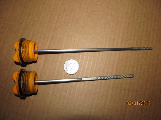

So... on my YM1700 I have a dip stick for the engine oil and one for the hydraulic oil. They both say the same things, "oil" and a Japanese word, are the same color. They have the same thread so could be interchanged, which leads to my question. Which goes in which oil? :confused: The only difference is that one has a longer metal post with a crosshatch pattern about 1 inch long, and the other has a shorter metal post with a crosshatch pattern about 2.5 inches long.

I should have started with this... here are a couple pictures of the 2 dipsticks. Between them is a US quarter for size reference. Both sticks are metal. The crosshatched pattern on the long stick is only about 5/8" long. The shorter stick was in the engine oil, and the longer one in the hydraulic fluid.
I'm sure I didn't switch them, but I'm wondering if the previous guy might have. (That's my story, and I'm sticking to it!! :D)
That looks correct but I'm going from memory, I'm not at the ranch right now. Hopefully someone else can verify this too.
I put a tiny punch mark halfway down that long crosshatch on the shorter stick, to indicate where four quarts of oil fills it to. This so I can verify that my YM240 doesn't use any oil, maybe 1/16" on the dipstick, between annual changes. You might pour in four quarts at an oil/filter change, and see if it reaches that midpoint.

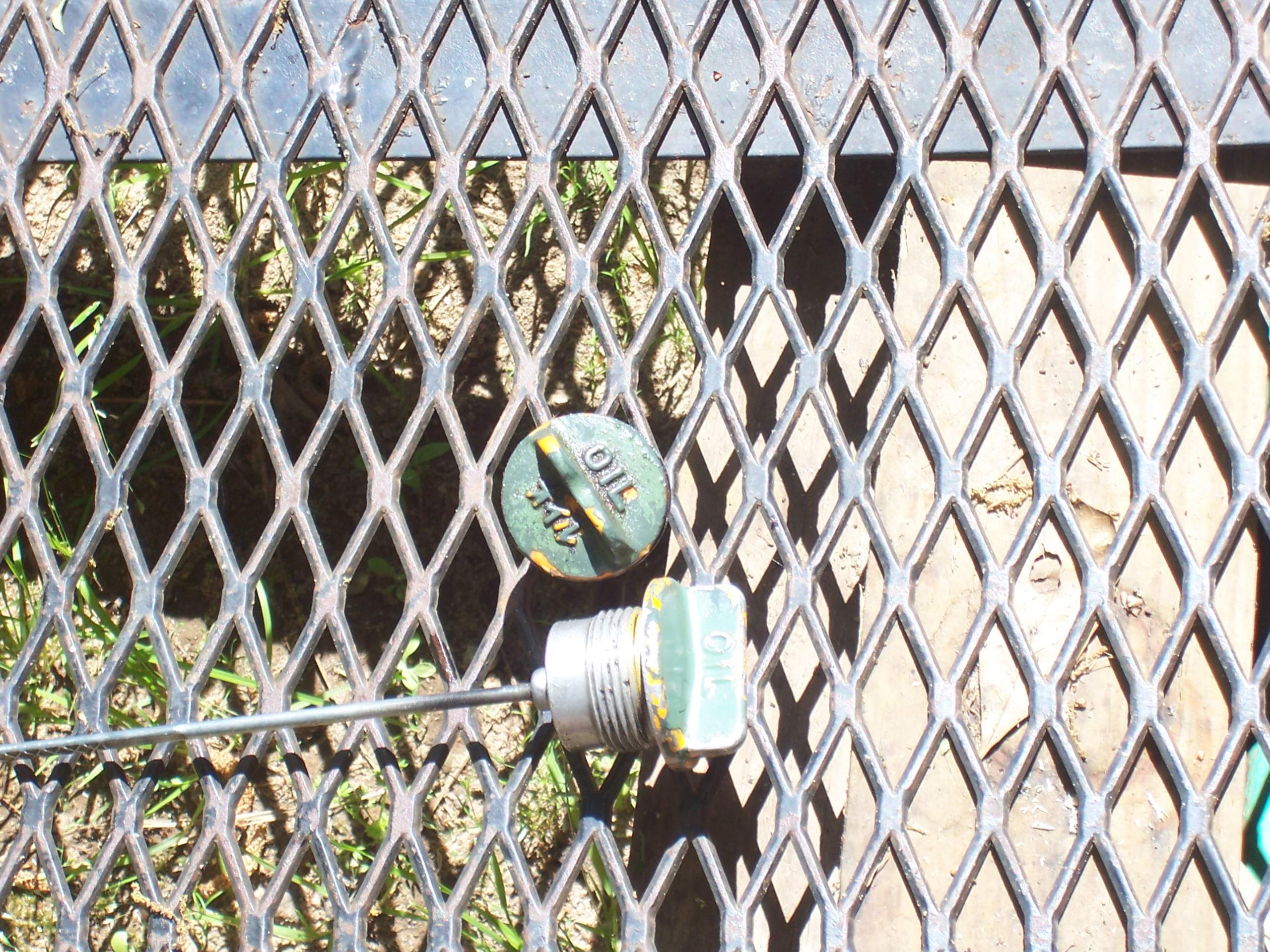

Only pic I could find
Mine looks like this . Cal's maybe the same
/ double dipper dilemma #9
I think it is the same. I posted this picture to show a temporary oil gauge I installed to verify that my sender needed replacement. But the picture also shows the all-metal threaded dipstick. (YM240/YM2000).

Logic tells me that the one with the shorter crosshatch is the engine oil. Long one is hyd.
/ double dipper dilemma #11
Experience tells me that the hydraulic and front axle dipsticks have a shorter crosshatched area, compared to the crankcase dipstick.
/ double dipper dilemma #12
I was just out back and mine look pretty much identical on my 2000. The shorter one Oil. The Long one Hyd. The length of the dip stick that is. The opposite for the Cross Marks. The Long Marks Oil. The Short Hyd.

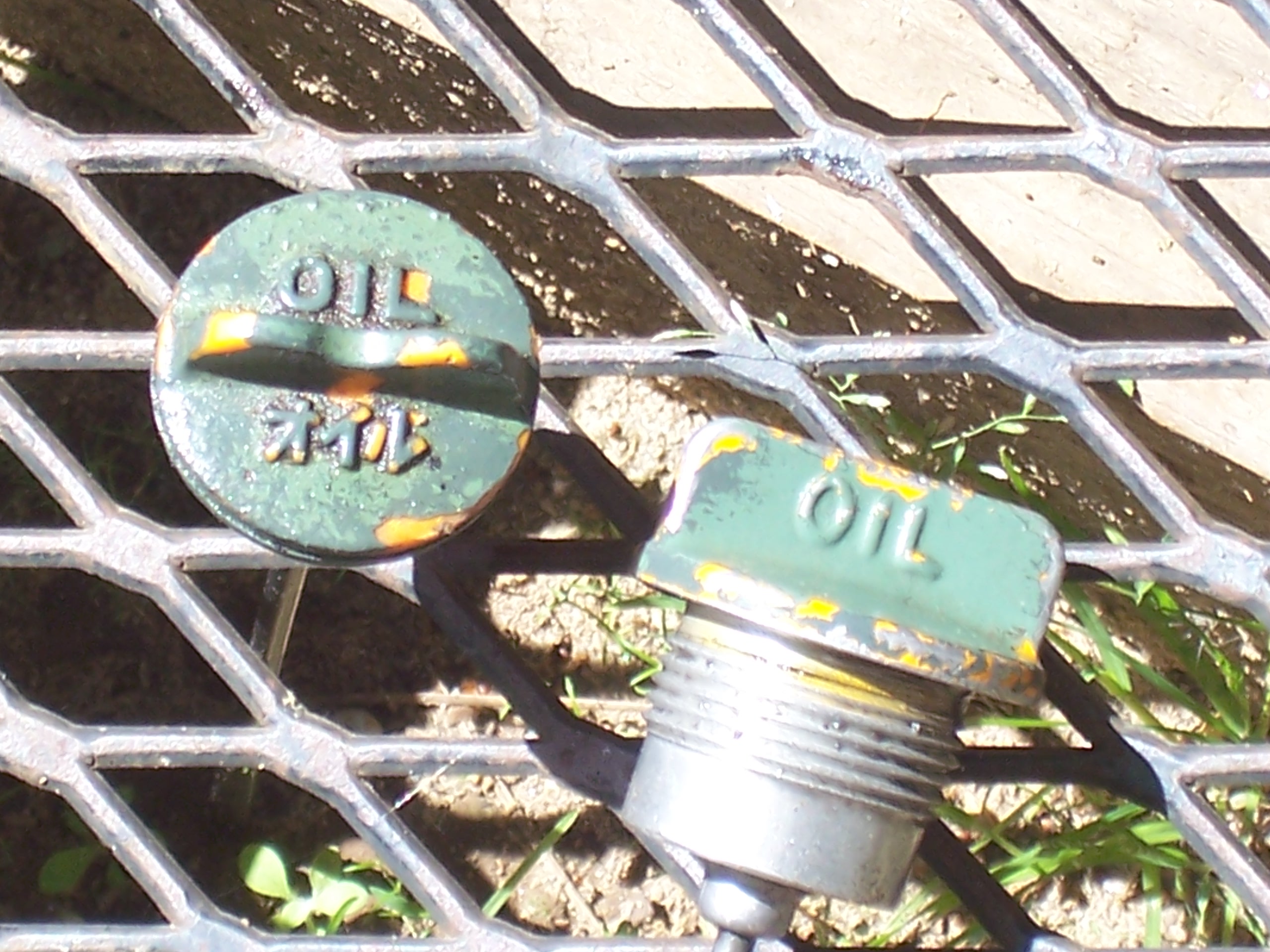

Here another thing that puzzles me about the -A on my 2TR20A-A Eng. on a Red YM2000 after seeing the Oil on the cap of Cali. pic. which is the 2TR20A US. YM240. Why would they put both on my caps English and Japanese. Yotang224 :D :laughing:

I got the Ym2000 and my cap looks exactly like California's. I bet he has Japanese on the far side of the cap, maybe not. BUT anyway my cap on both the Hydro and engine oil says oil in english and Japanese.

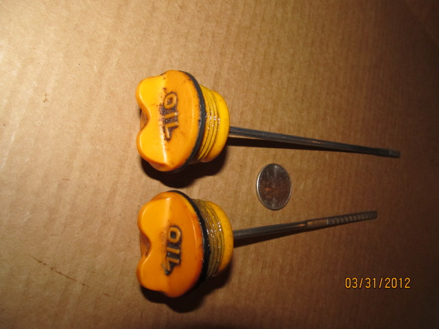

Not sure if the ones from my 1700 are original, but are what came with it when I purchased the tractor, Seems to be slight different then the other ones shown, the 2 dipsticks are almost equal in length,
The hydraulic stick is plastic and measures from the O-ring to the tip 7 7/8
The Engine stick has a larger metal cap and measures from the O-ring to the tip 7 3/4
each have 710 as well as the Japanese writing ( OIL ) on them,:D
/ double dipper dilemma #17
I forgot to mention that there is a noticable size difference in the caps. Same as yours DND. But didn't notice there was much of a difference in Ginormus pics. at the start of this thread. The Oil has been changed no doubt looking at the cap but is the same Length wise. And on the English that tells me they were planning on exporting alot of 1700/2000 models to the US. or No doubt English speaking countries. Still CRS. but I believe I know why they wasn't shipped to the US. LOL.

I'm thinking if either of the 2 are the incorrect ones for the engine you may not been using the right amount of oil all this time,:cool: especially if using the shorter of the 2, will have you over filling the crankcase, and could explain why or if you might been seeing oil blowing out the vent tube,
