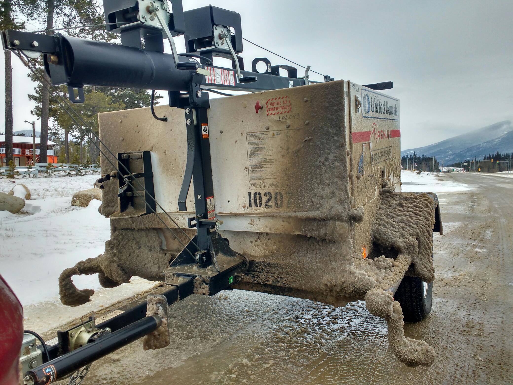

We debated using a pto generator for backup but decided that the option of an independent generator was the way to go, freeing up the tractor for dealing with the crap that is usually causing the outage. Deciding what type of generator normally depends on the most convenient type of fuel available, and here that does not include propane or NG. Most of those whole house screamers that are sold these days are not very durable, Generac comes to mind, and now Champion. Good luck trying to get service on those when mechanical problems develop. Diesel was the most logical for us, as we need diesel for the tractor as well. What we have now is an eight kw light tower that is powered by a D1105 kubota engine with over 10000hrs on the meter. It runs at 1800 rpm and can reasonably be expected to last another 5000hrs which means it will outlast us by many years. Bonus, the light tower has its own 50 gallon fuel tank, which is also the fuel tank used to fill the tractor. Ltgenr.jpgIMG_20180330_154532391_HDR.jpg
It was clean when picked up, but got a little contaminated on the way home.

We debated using a pto generator for backup but decided that the option of and independent generator was the way to go, freeing up the tractor for dealing with the crap that is usually causing the outage. Deciding what type of generator normally depends on the most convenient type of fuel available, and here that does not include propane or NG. Most of those whole house screamers that are sold these days are not very durable, Generac comes to mind, and now Champion. Good luck trying to get service on those when mechanical problems develop. Diesel was the most logical for us, as we need diesel for the tractor as well. What we have now is an eight kw light tower that is powered by a D1105 kubota engine with over 10000hrs on the meter. It runs at 1800 rpm and can reasonably be expected to last another 5000hrs which means it will outlast us by many years. Bonus, the light tower has its own 50 gallon fuel tank, which is not also the fuel tank used to fill the tractor.View attachment 687153View attachment 687152
That's a nice rig and a great way to repurpose equipment. :thumbsup:
