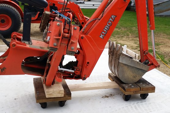

I used some HFT Dollies and 2 x 4's
/ Dolly for Backhoe? #22
Nice improvise... but those little diameter casters I think would give me fits. Need pretty smooth surface with no pebbles. My dolly casters are 5in diameter and function very well... I think that is a key design parameter if you build one.
I agree...the larger diameter wheels will make it easier to move on rougher surfaces. As I mentioned I had these hanging around, and being on a smooth surface, the unit can be moved easily.

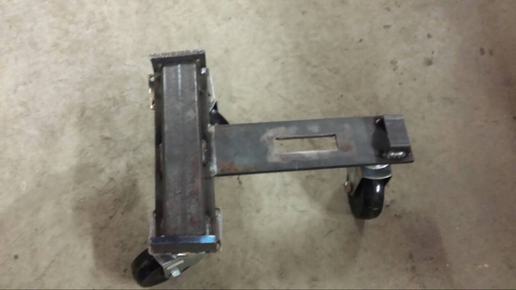

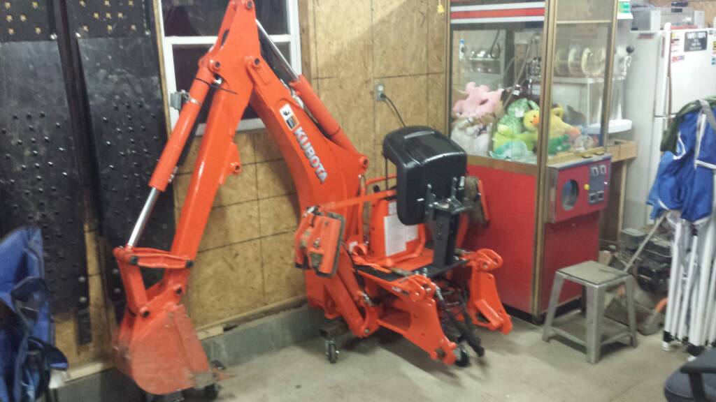

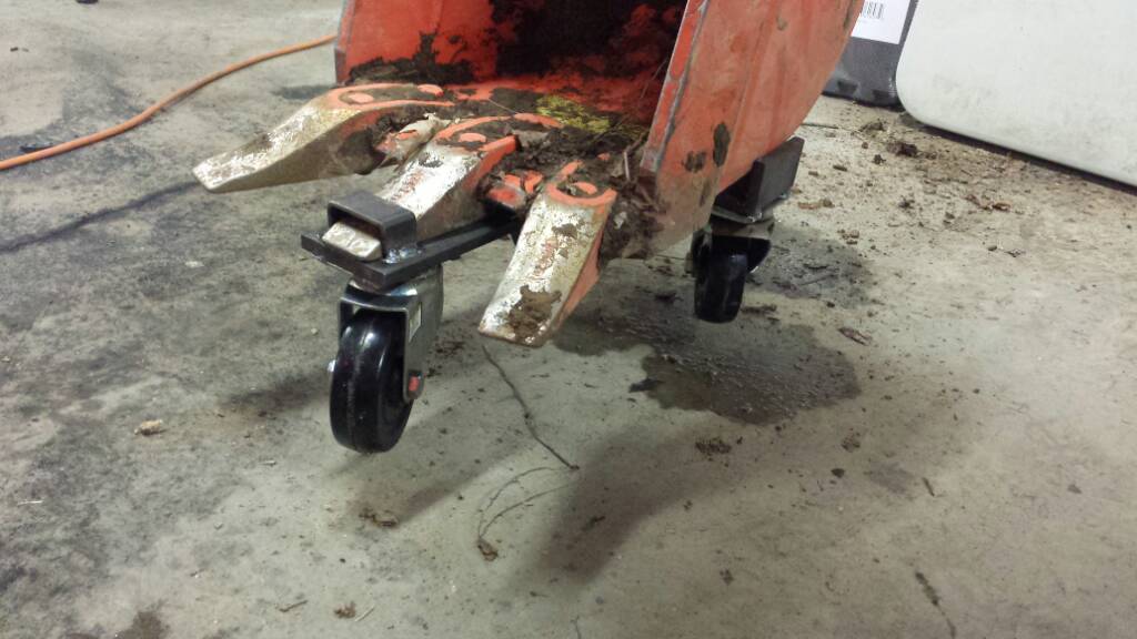

Awe man, now I got to re-do mine and it's your fault! That's a great idea, never crossed my mind.
Garage isn't very big and that backhoe is about 7ft long sitting on the ground if I remember right. I have to add one wheel to help stabilize it a little more but it works better than I would have thought. I just used steel I had laying around around harbor freight casters.

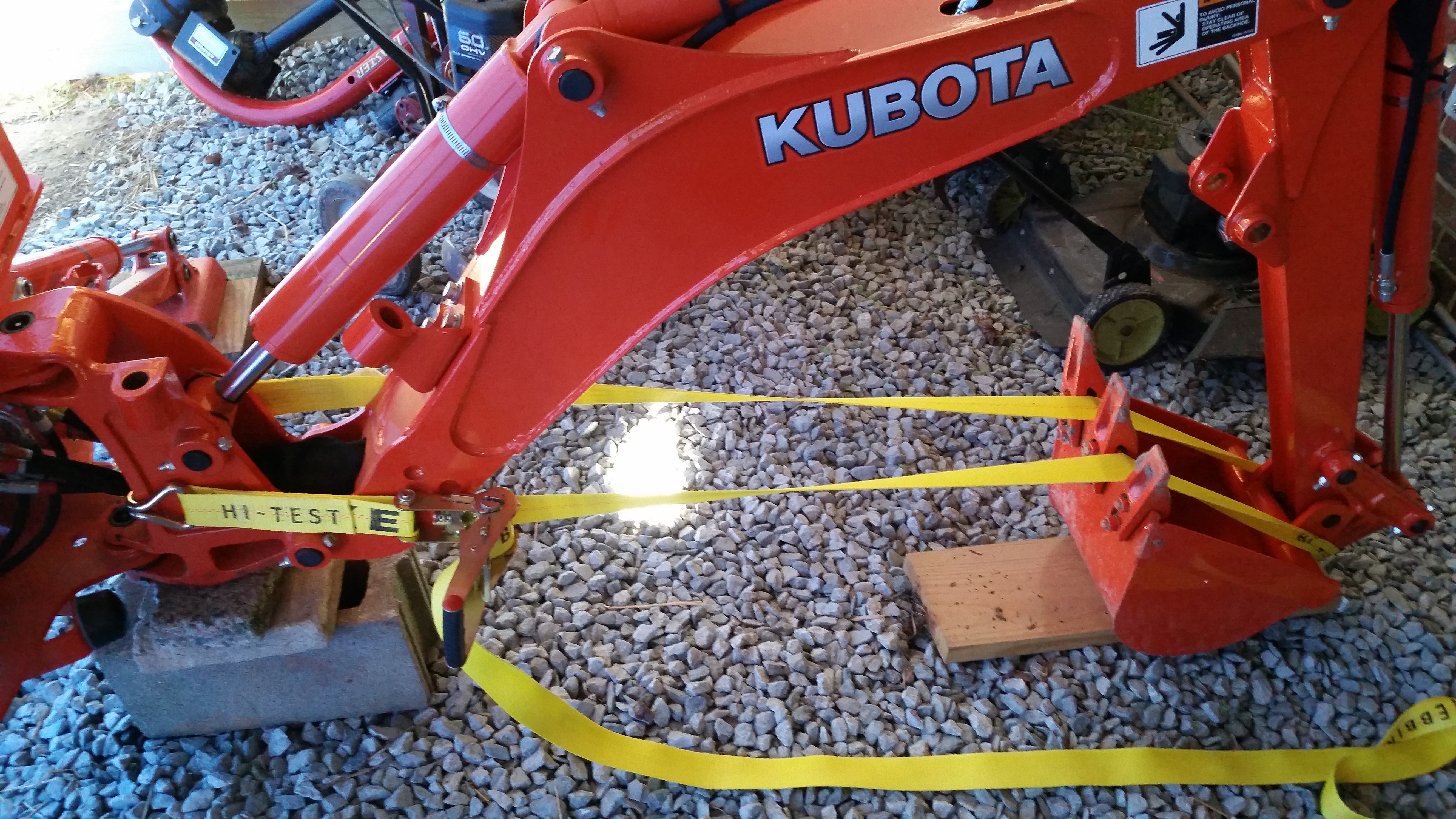

This is what I do with mine:
To move it around, you could put it on one or more dollies.

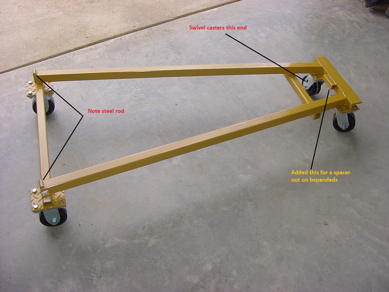

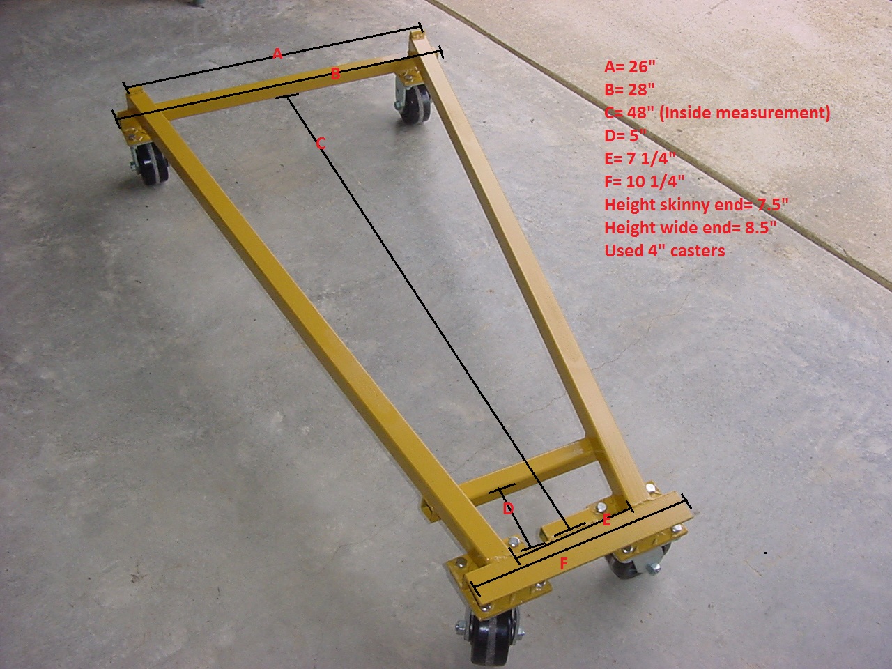

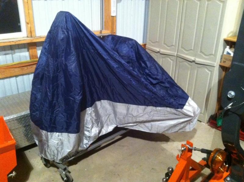

There is some great looking dollies here, I opted for Bxpanded since I dont have a welder. Mine is inside and on concrete so it made since. Easy to move around to clean up the shed. Since its off 95% of the time I decided to cover it up too. A $20 large motorcycle cover did the trick. This is an old pic and have secured the outriggers better.
