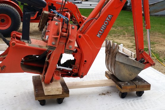

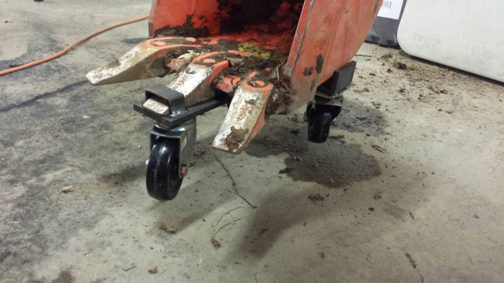

BXpanded makes a backhoe dolly. I use three mover's dollys - two on the frame and one under the bucket.

I have considered getting one of those motorcycle platforms as a basis for a backhoe dolly. Built a simple wooden dolly instead of spending the dough.
If you do not need to move it, setting it directly on the ground is fine. You attach the hydraulics when it is time to reinstall it, so using the stabilizers and bucket you can raise and position it for attaching. I need to move mine, hence the dolly with wheels. pksebago's three mover's dollies is good... basically that is what I have with crossmembers so they are tied together.

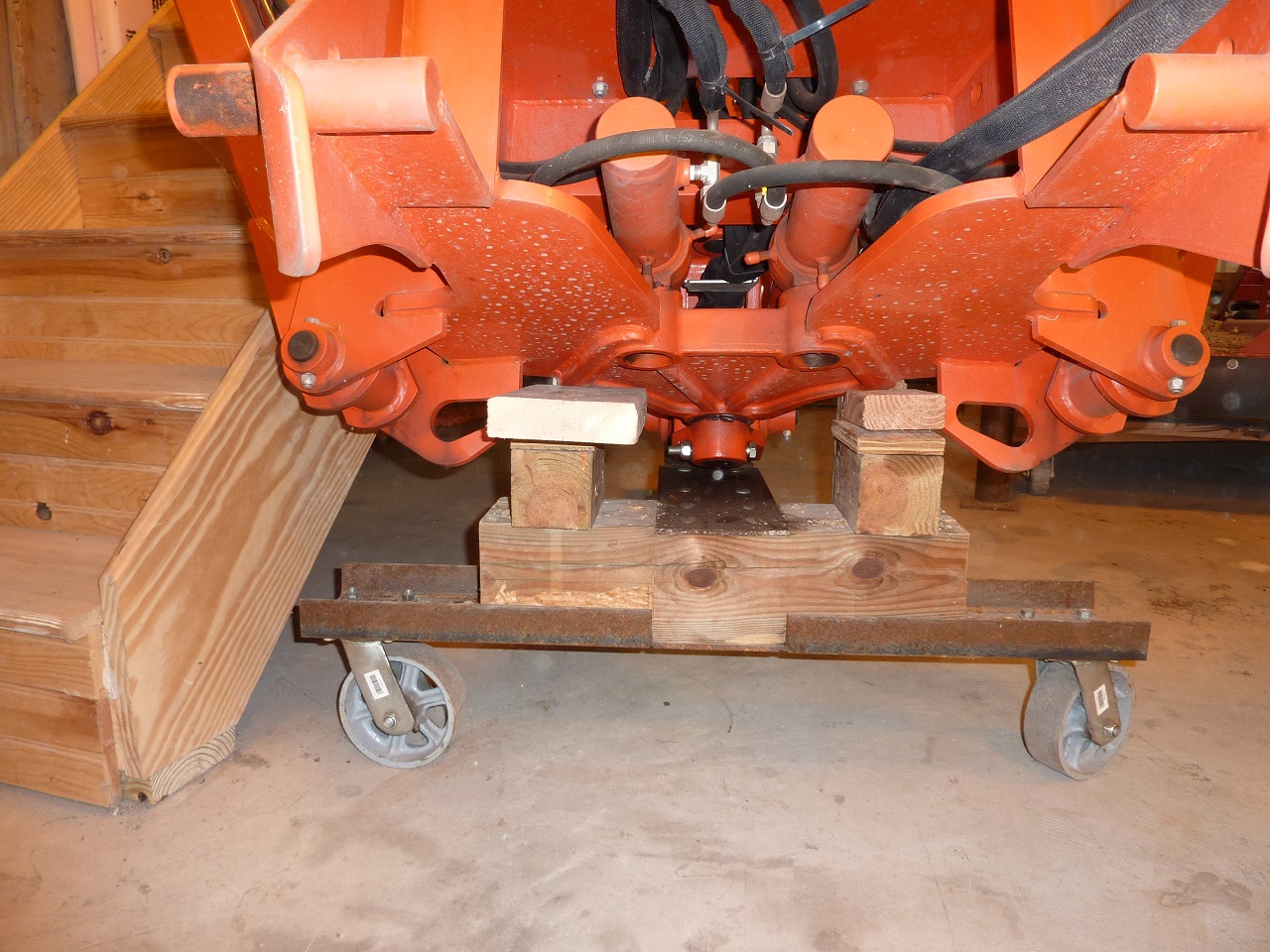

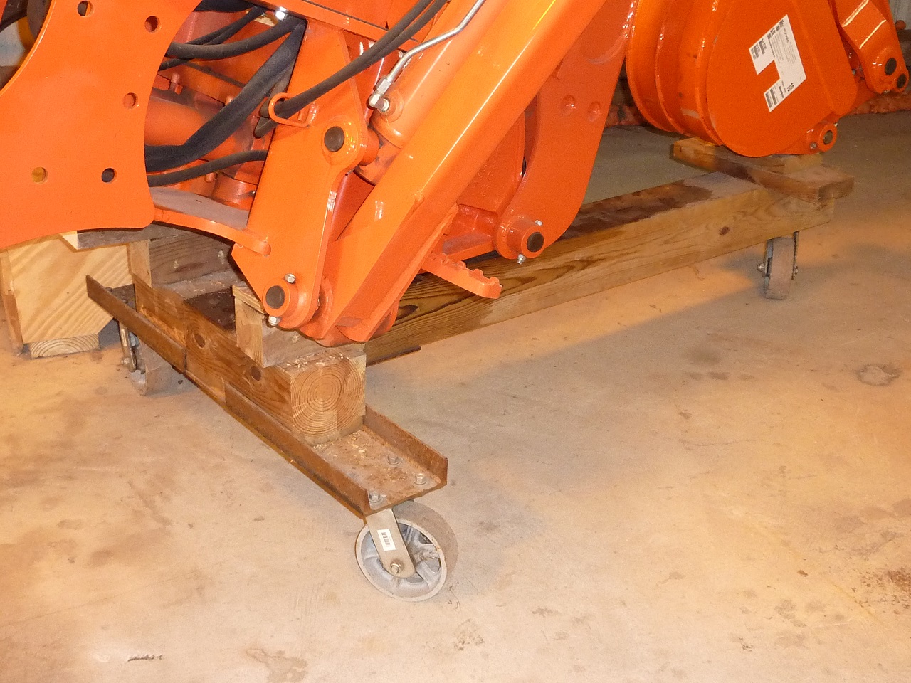

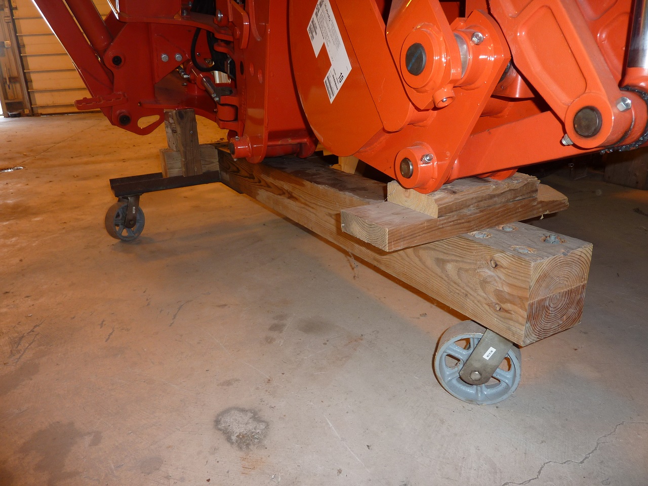

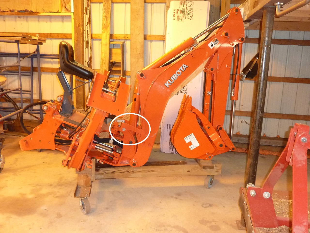

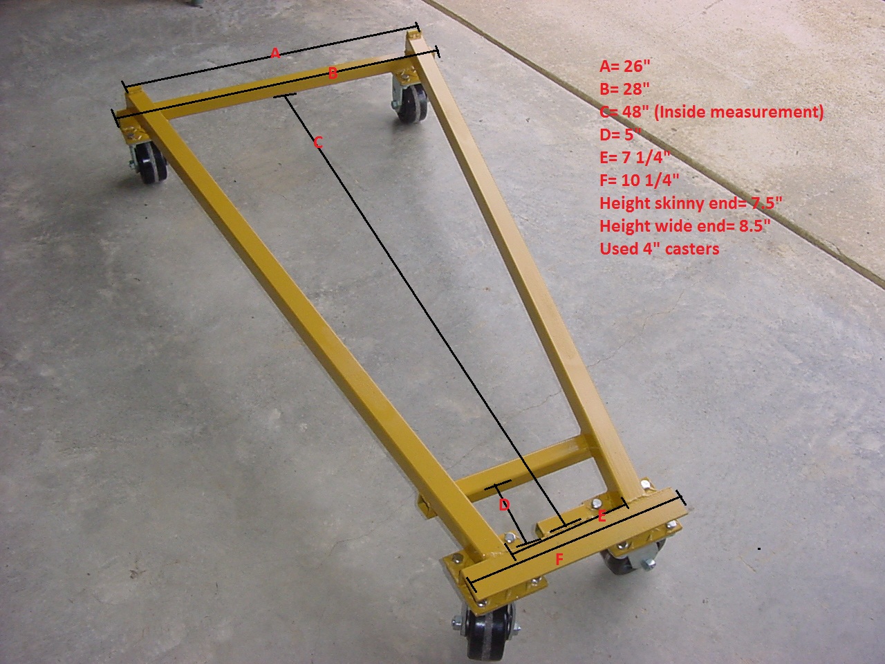

If you have a concrete floor for it to roll on, a dolly is fairly easy to make. I made one for my BH92 hoe using a 5' 6X6, a 3' piece of 6 channel and 3 cheap swivel casters from Northern Tool:
http://www.northerntool.com/shop/tools/product_200660568_200660568
I bolted the channel to the 6X6 in a "T" shape and then bolted a caster on each leg. You'll need to use shims to fit the frame of the hoe.

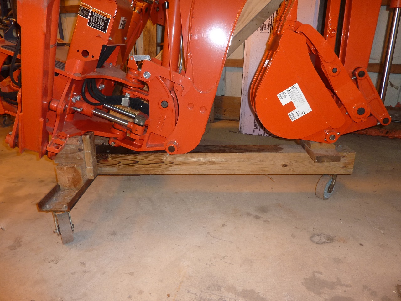

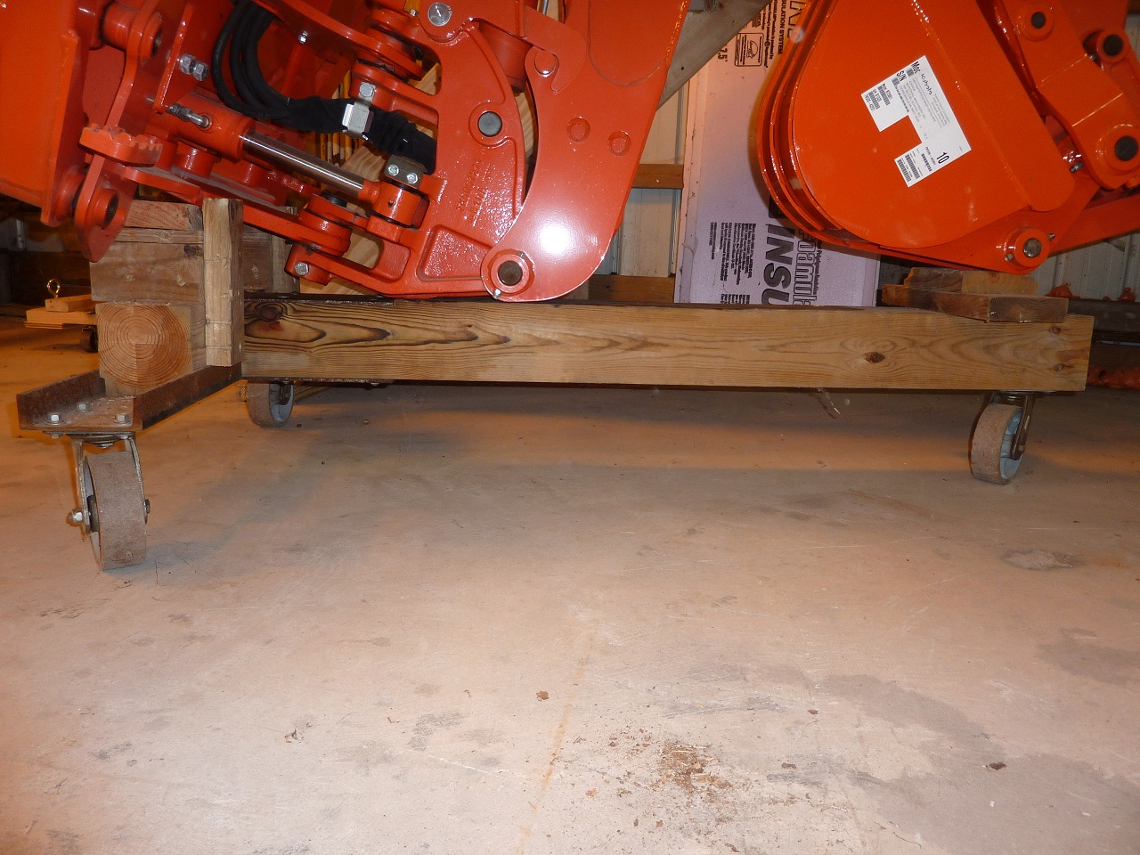

To put the hoe on the dolly, lower the stabilizers, pull the mount pins and move the tractor ahead a few inches until it just clears the frame. Leave the hydraulic hoses attached. Using the stabilizers, raise the hoe until there is enough room to roll the dolly underneath. Retract the stabilizers until the hoe rests on the dolly and shims. Disconnect the hydraulic hoses and you're in business.

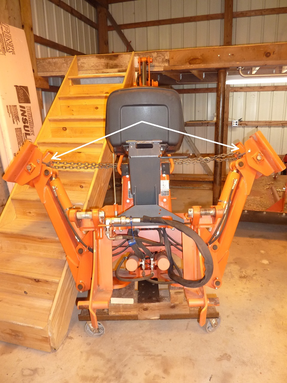

I've used this dolly on 3 different hoes so far and it works well. Make sure to immobilize the boom using the attached pin or hook to keep the hydraulic cylinders from bleeding down over time. Failing to do this could cause the hoe to slip off the dolly. The stabilizer cylinders will also bleed down making the dolly difficult to move. To avoid this, I chain the stabilizer feet together.

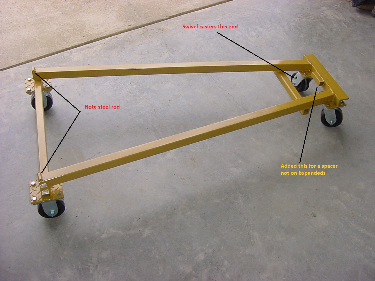

BXpanded makes a BH dolly. I have one and it works like a charm. I have limited flat covered space and need to put as many of my tools, tables, etc on wheels to manage them and shop space.
Here is a youtube vid on what it looks like and how it works. You might want to build a similar one yourself.
Backhoe removal demonstration using BXpanded Backhoe Dolly - YouTube

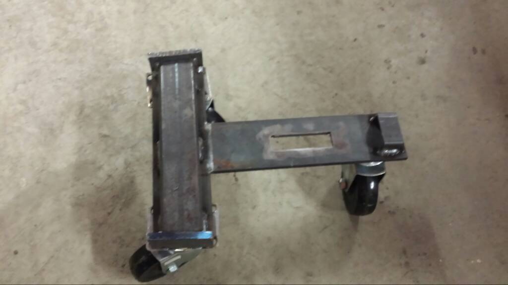

I built a dolly but need to make some changes before it will work. Design review required.

Yeah I was going to build a dolly because cost would have been so much less, but ended up buying because the dimensions are important to make install/removal a breeze.
/ Dolly for Backhoe? #12
Could you share the dimensions of the one that you purchased?

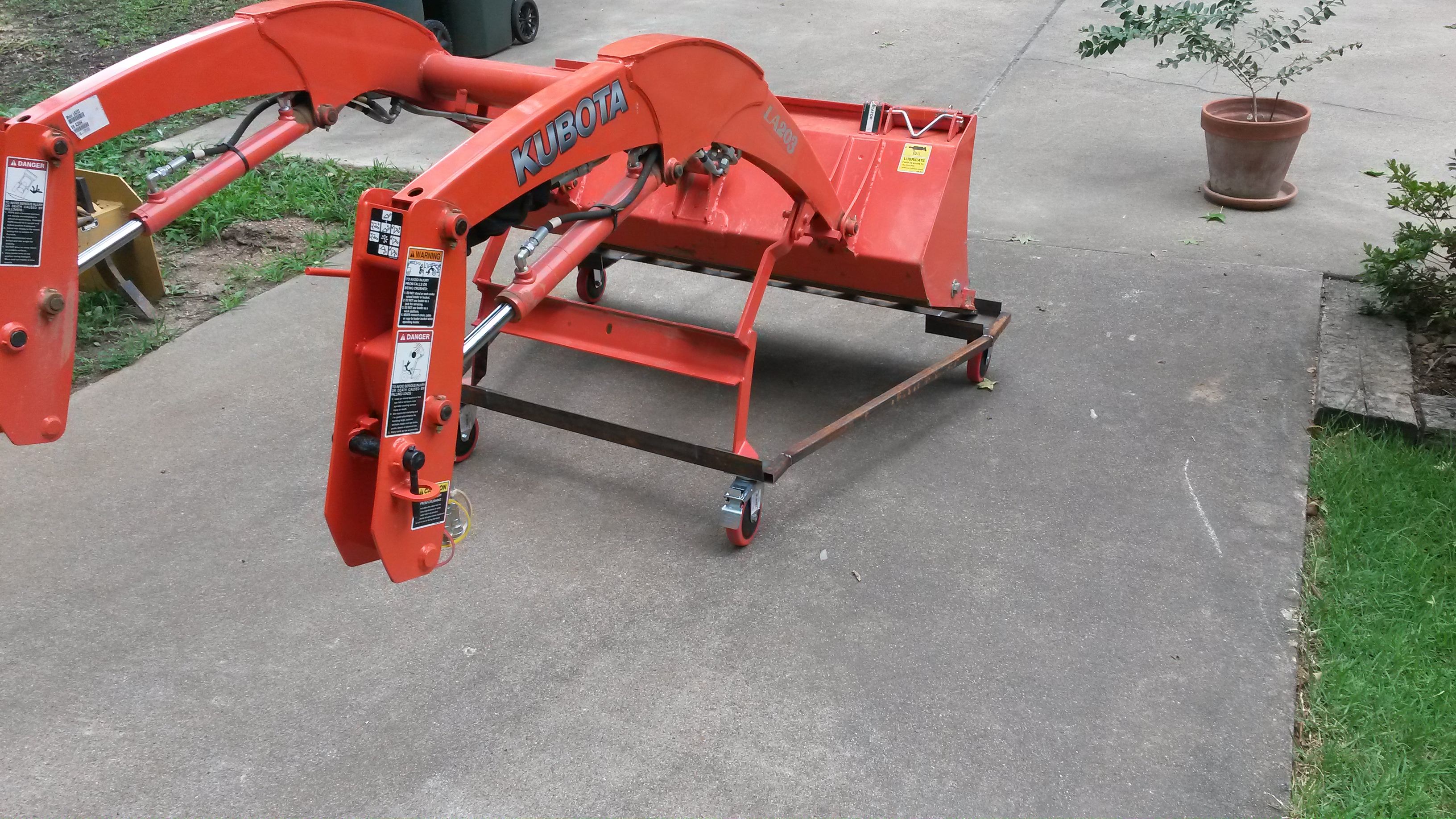

I was going to weld up a dolly but had a couple of small HD dollies hanging around. Tied them together and built up an elevated section to rest the hoe frame on. Works great and makes moving it around easy!
/ Dolly for Backhoe? #19
Nice improvise... but those little diameter casters I think would give me fits. Need pretty smooth surface with no pebbles. My dolly casters are 5in diameter and function very well... I think that is a key design parameter if you build one.

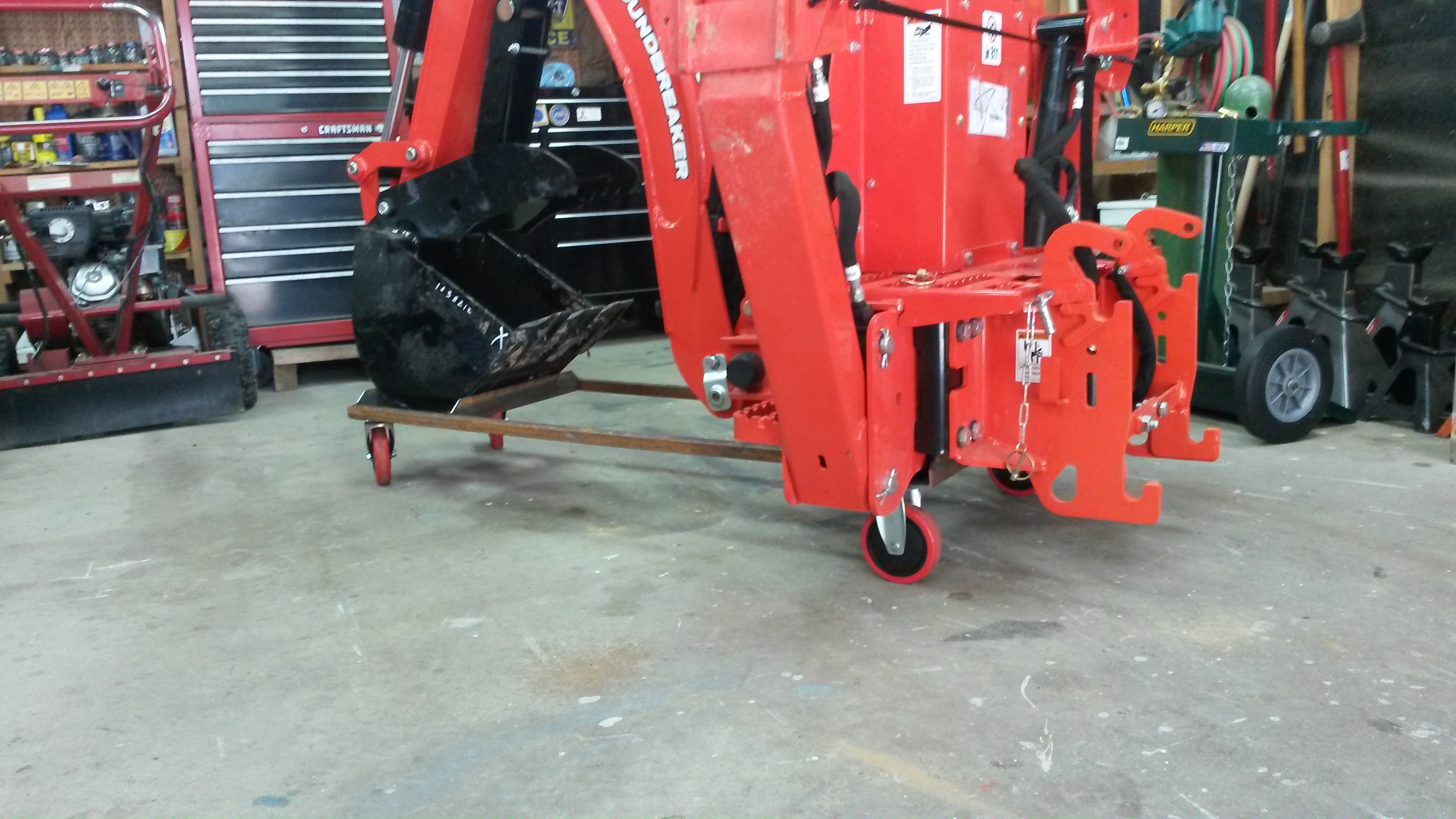

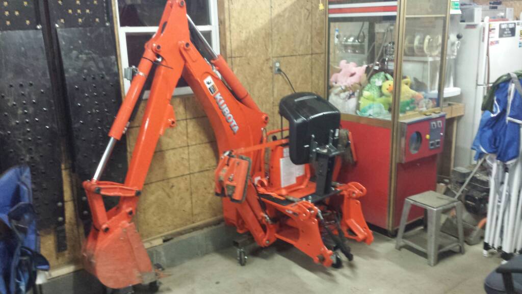

Here's my backhoe dolly. It's for a bh77 backhoe. It's two pieces so I can move the boom to one side and push it against the wall. I run a strap between outriggers and from the bucket to the step to keep it from bleeding off. 20151228_233755.jpeg 20151228_211127.jpeg20151228_211208.jpeg
