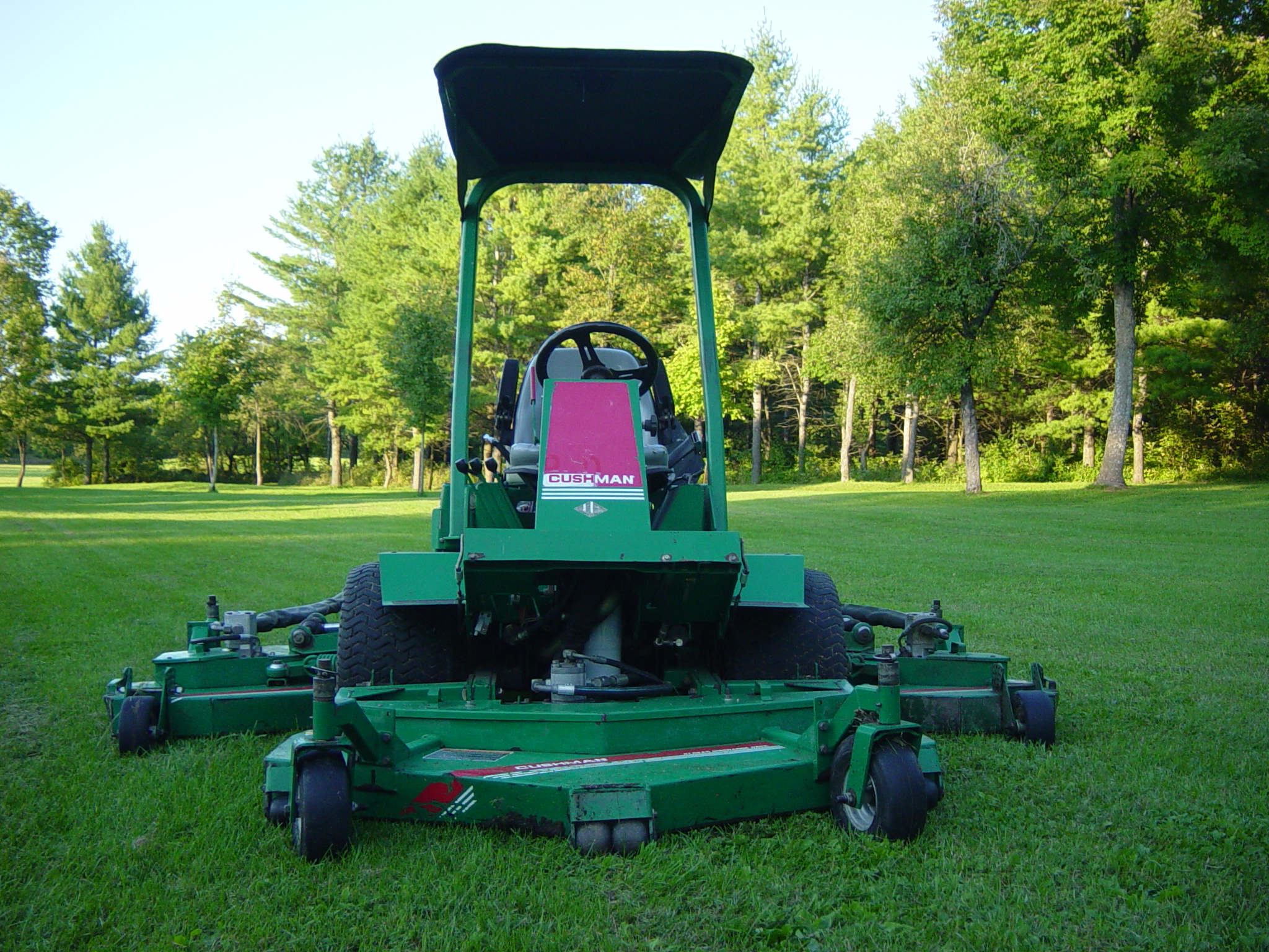

A 72" deck often doesn't do a nice job. Too much uneven ground to span. That's why bigger machines start to use seperate decks to follow the contours of the ground.
Bigger mowers actually take less time than the math might indicate, because you always have overlap. If I have four inches of overlap on my ten foot mower, that is a smaller percentage than four inches on a five foot mower.
My 72” does a good job with hardly any scalping of you get the mowing pattern right. The biggest problem is an obstacle that doesn’t let you drive where you need to such as a fence that’s not 72” from the bottom of a ditch. I think the 72” does a better job on flat ground especially with tall grass. My 72” machine will mow twice as fast as the 50” it replaced.

I have a 72" for my Steiner, that I just got for the heck of it in a trade and it is for sale.
Generally speaking, the best quality cut is from a narrow push mower and the quality get's worse as you move up in size. If you are mowing something that is billiard table flat, then I guess the 72" would work well. Not around here with the unduating terrain.I am not even talking of scalping, but more bridging small dips and valleys.
Currently I have 4', 5', 6', 6' fine cut flail, 10' (Three Deck) mowers, and got rid of my 16' flex wing finish mower. And had many others, so I have a little experience.
   / Does the math work? #30
Ooops, forgot the hydraulic sickle mower and Van Wamel (Hammer Type) Ditch flail mower.
