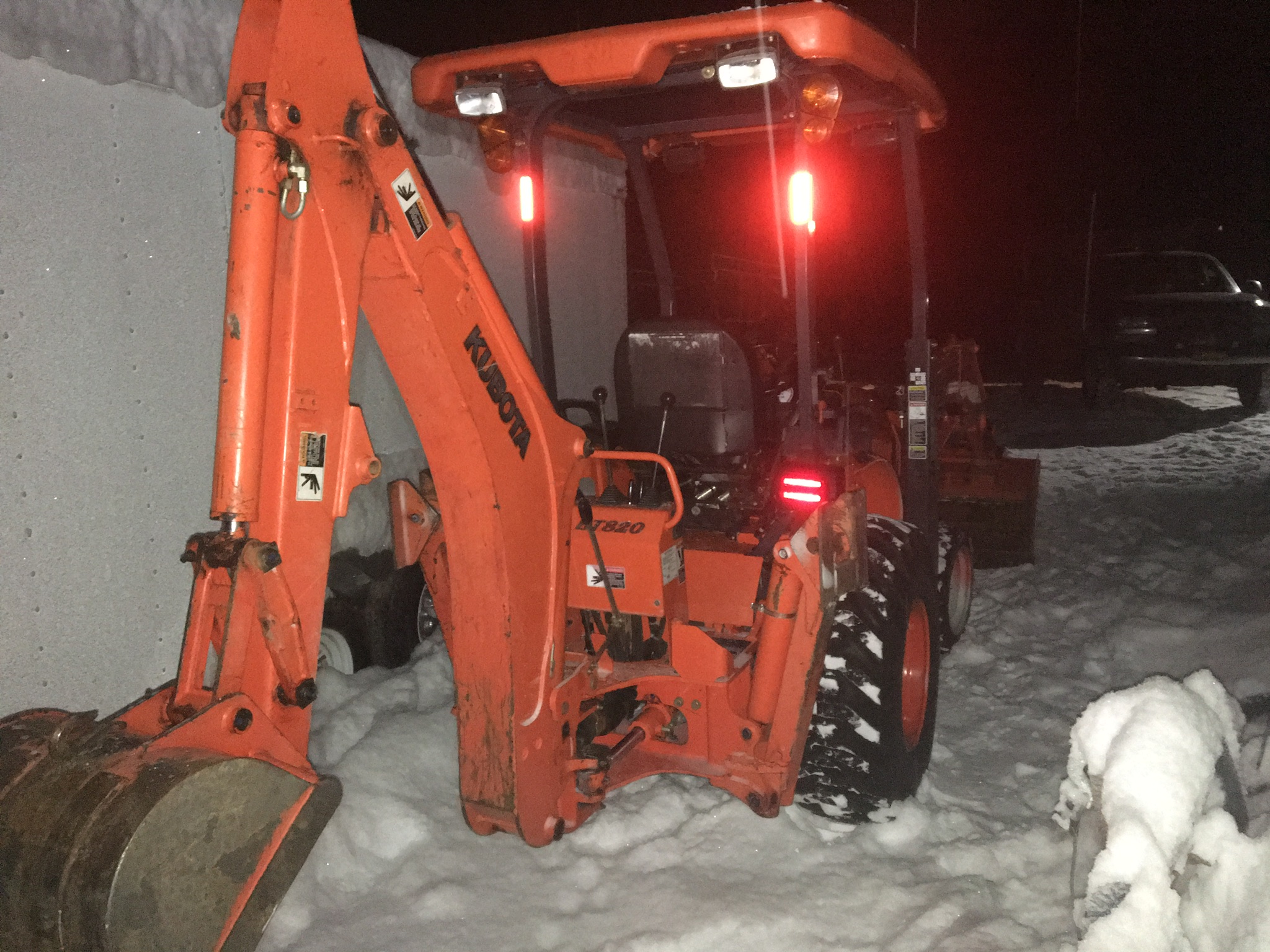

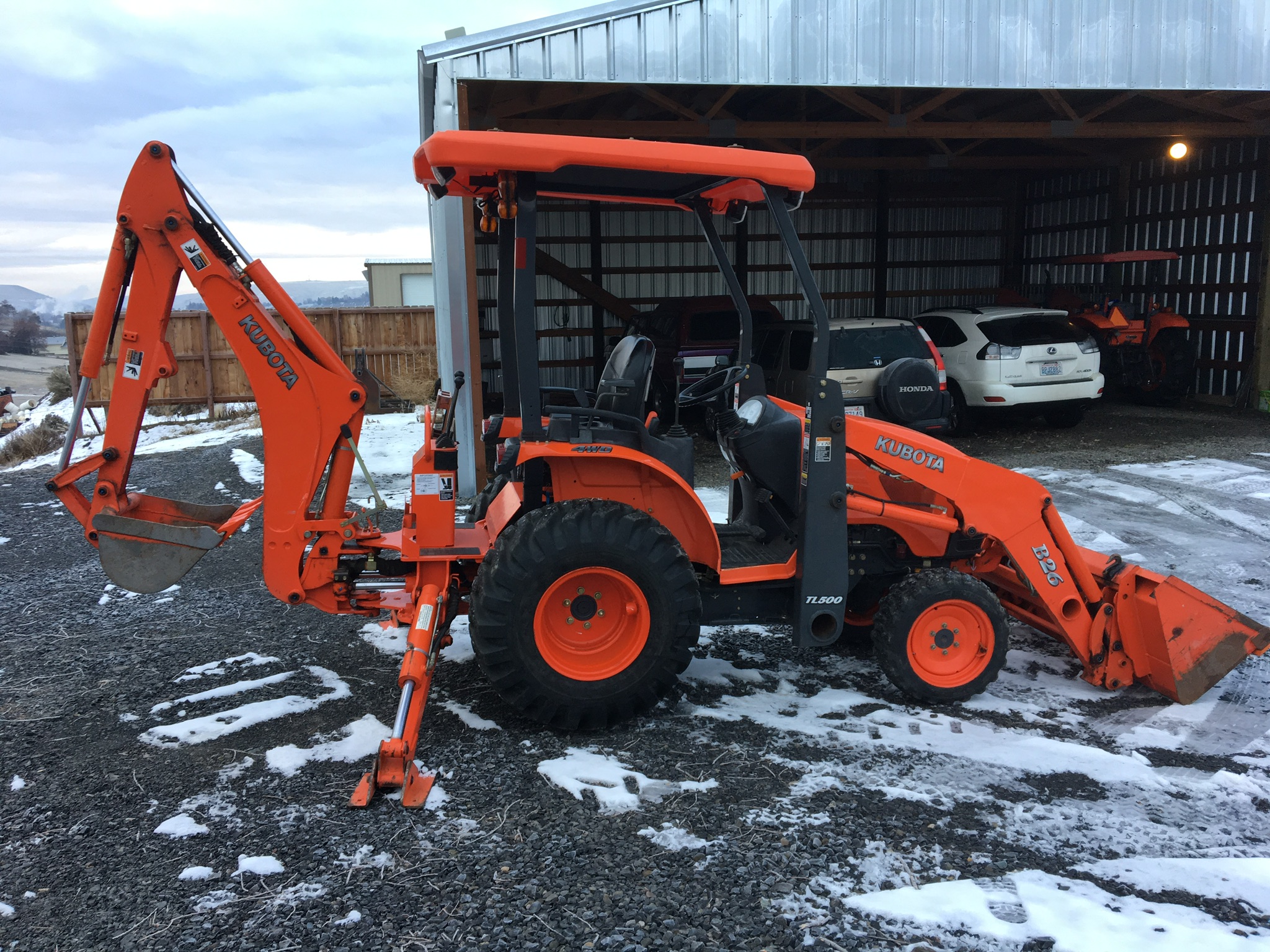

Hey �� folks, I have an ‘07 B26 and I bit the bullet and bought the thumb and remote valve kit. The stuff is waiting for me at the dealer and Im out of town for another week.. I just read that Ill need the quick attach in order to install the thumb on my hoe is this true, do I need to order that thing too?
Heres a shot of mine:)

Chunk of $$$! Our B26 is a great machine. Use the thumb often.
According to the wholegoods price sheet the thumb option is compatible with pin-on or quick attach buckets.
The quick attach backhoe bucket system is the easiest, strongest I have ever used. Takes longer to get on/off tractor than to change a bucket. Heavy built qa buckets weighing twice as much as the pin-on buckets. Ours came with three sizes. Only downside is we don’t need to change buckets that often.
/ Does the B26 hydraulic thumb install require a quick attach?
Man that痴 great news. Friggin excellent, thanks for the reply. Im not too sad about my pin on bucket being a tad lighter.
I知 going to look into this wholegoods list it seems I may have been able to answer my own question.
