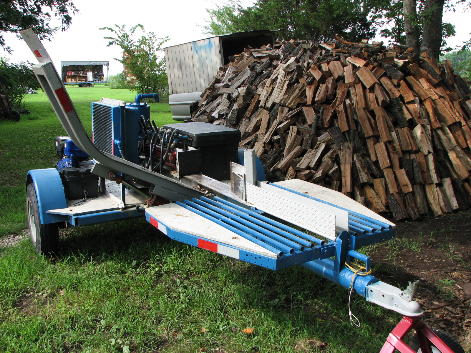

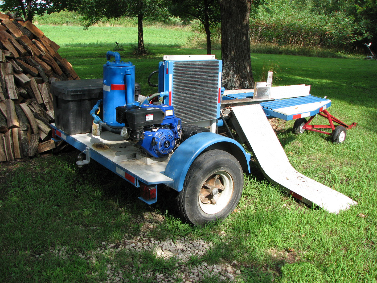

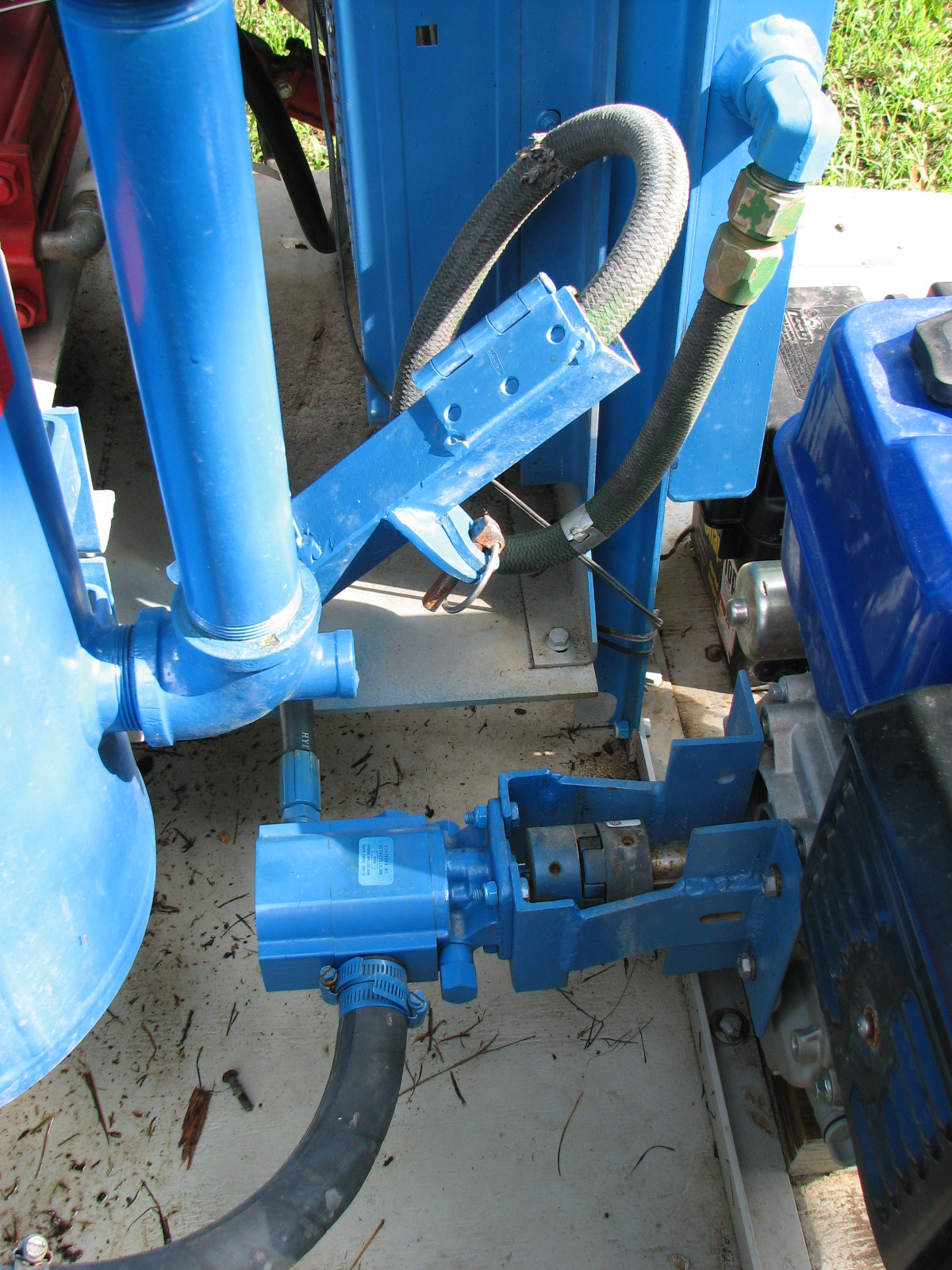

I am a fan of the dedicated horizontal splitters where every thing is at waist height & the wedge is fixed to the beam. Where I am in mid Missouri, the only splitters available were horizontal/vertical, (the wedge is on the ram), within the 16 - 30 ton range. This ruled them out for me.
I chose to build my own. I added a log lift, out feed tables, a wider axle, & a hitch on the back I can pull a trailer with. I am using a 11hp Greyhound (Harbor Freight) engine at 1/2 throttle to run a 16 gpm Haldex 2 stage pump. I have never had it stall out & once I sharpened the wedge it has been able to split anything I want it to. (Elm, hedge, ..) (My valve's pressure release is set at 2,500 psi & use a 4" x 24" cylinder.)
On your oil reservoir; make sure the suction port size is at least as large as the inlet on your hydraulic pump & the return port is 3/4".
*** NOTE ** Please disregard the filter in the suction circuit as shown in the pictures attached. It has been moved after being educated by fellow TBN members and placed in the return circuit.
A few of tips
#1 - If you should get a piece of wood stuck on your wedge, DO NOT try to beat it of with a Hammer/maul/ax/... instead keep an 8' length of 1/4" chain on hand and with the push plate positioned next to the wood, wrap the chain around the wood & push plate the retract the cylinder & it will pull the wood right off the wedge.
#2 - Sharpen your wedge, it will GREATLY reduce the effort required to split the wood.
#3 - If you normally split wood lengths several inches shorter than the travel of your cylinder, make a cylinder stop to go between the cylinder body & the yoke on the ram to prevent the ram from fully retracting. This will shorten you cycle time. Make it removable so when you are through splitting for the day, you are able to fully retract the ram to help protect it. (You can make it from 2 pieces of angle iron with hinges, 3 pieces of wood fastened into a "U" shape, ... or your can purchase spring loaded "stop collars" from tractor supply stores which can snap over the ram shaft. I make mine with hinged angle iron & weld a couple of short pieces of flat metal with a hole in them so they over lap & I can hold the angle iron closed with a linchpin. The picture shows one fastened on a hose so I don't lose it. I use it as my transport cylinder lock for the log lift when I am going down the road.
I have a little less than $1,200 in making my splitter. :thumbsup:
