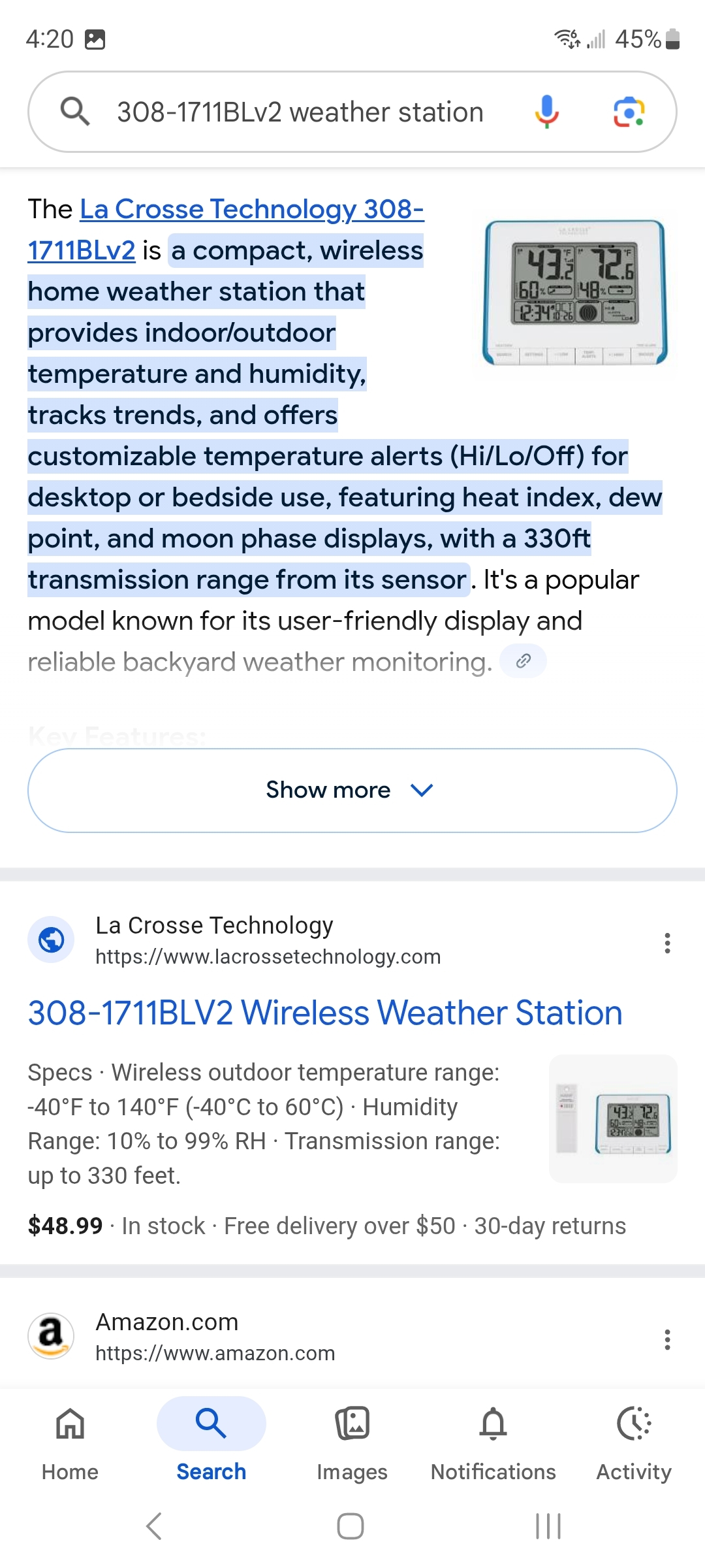

   / Does anyone have a low-temperature alarm in their barn? #18
I have this one. It works well.
