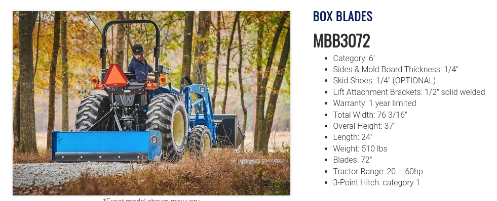

Hi folks,
New Kioti owner here. My dealer, who does his main volume on LS tractors, is steering me toward a 6' LS box blade for my tractor @ a price of 1,440$.
He has it readily available and I kind of like it. Looks strong, esp. with the optional skids installed on the side.
Does anybody have any feedback on these attachments ? Thank you !

I'm sure that box blade will do the trick. It is rated for up to 60hp so should be fine for you tractor. It's a box blade, I wouldn't over think it. Unless you are going to use it in a business for heavy duty work, and if you are I would buy a Woods or a BEFCO or an EA.
However, unless you like shiny new and have $$ burning a hole in you pocked, buy a used one. Around here you can get a very nice used box blade for under $1k and probably around $800. There isn't much that goes wrong that isn't obvious.
Your tractor could handle an 7' BB, might want to consider upsizing.

510 pounds / 6' = 85 pounds per foot of width.
You will find few heavier per foot of width.
Make sure your BB choice completely covers the width of your rear tires.

I purchased one from the dealer I bought the tractor from. MT335H. I am a retired metal fabricator and was going to build my own. The problem is I could not find a decent price on the cutting blade.The shipping was as much as the cost of the blade. I finally got one from Behlin Country website. It was $100 and $35 shipping. The reason the shipping was so inexpensive was it was only 3/8" thick so it was within the 50lb. limit of UPS. So I was tuned into the thickness of the cutting blades. 3/8" was too light so I decided just to buy one with the 1/2" blade.
I looked at the King cutter box blades at Fleet Farm. They have a good thick 1/2" blade on them and also were on sale for about $250 less then the LS. My dealer had done some extras for me when I bought the tractor so I figured I would patronize him.
After I got it home I noticed it only has a 7/16" blade. Pissed me off that I didn't look at it closer before I bought it. I also find it works better for moving material if you take off the side skids. I have a hydraulic top link and I find if you tilt the front of the box down it just rides on the skids and lifts the blade up. It actually works more like a land plane with the side skids on. Look at most of the land planes...they all have the runners on the sides. If you want to move some material or ditch out a driveway you are better off removing them.
