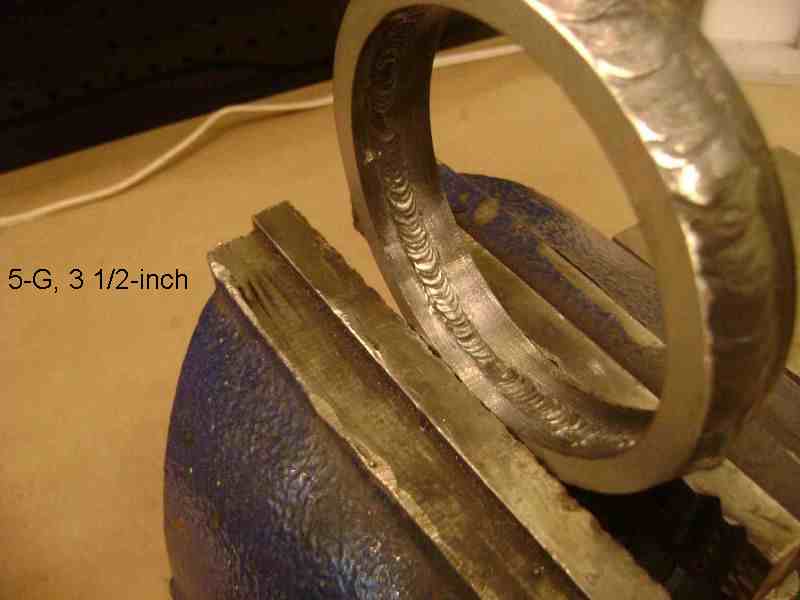

I do when I want 100% penetration!
Depends on what level you want to take your welding / fabrication skills to. You'll need to figure out what angle of bevel, land, (root face), and gap works best for you. Two double bevel plates are easier to get full penetration than two single bevel plates.
Well that's good to know. Maybe (just maybe) it isn't all my fault then. I'll try beveling a few pieces and see how it goes.

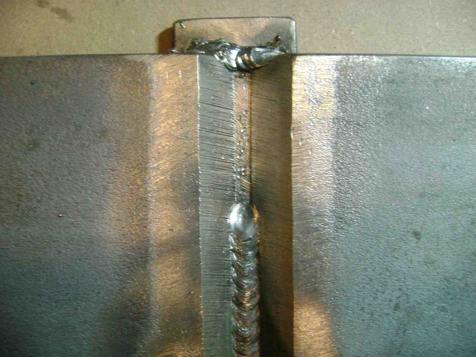

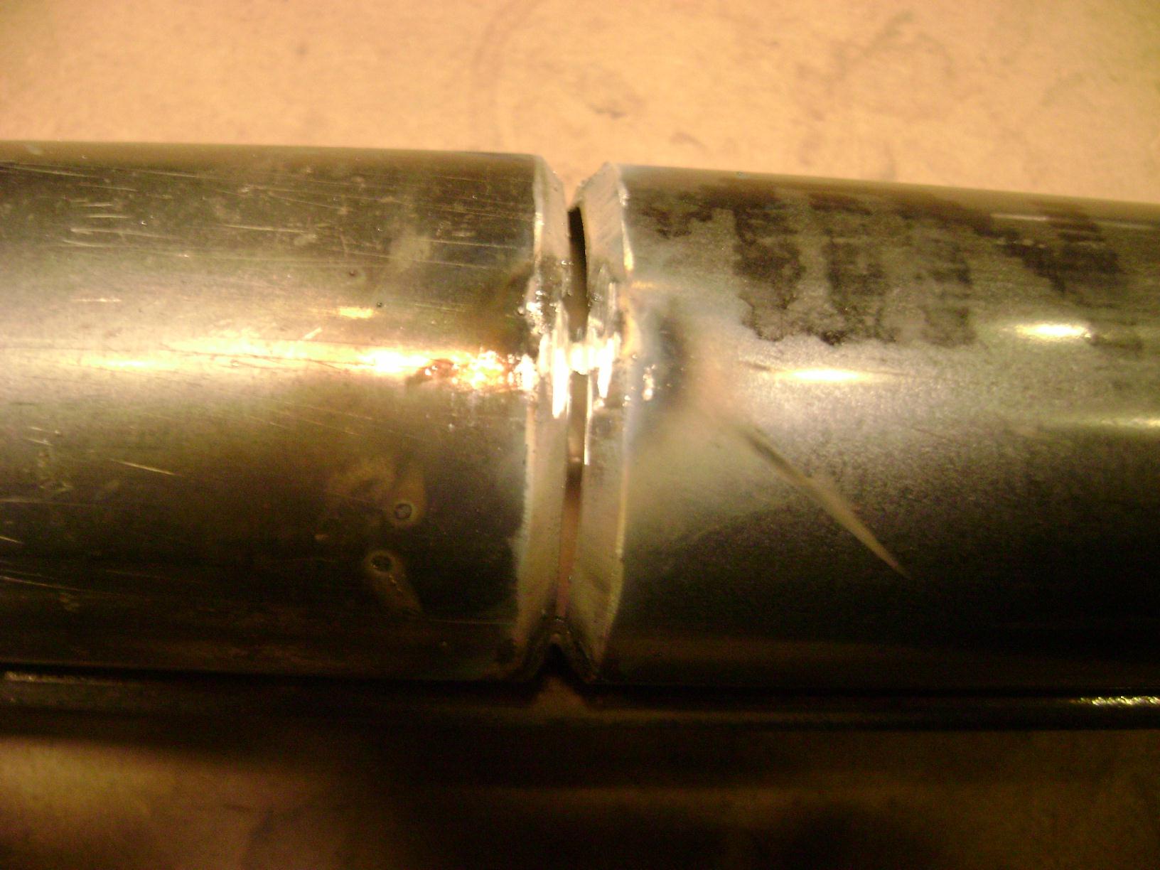

I don't have any pictures of how I like to prep my joints for open root welding. I do for Tig welding, but not stick. Here is a picture of how I like to prep for open root with backing plate, this is vertical up with 1/8 inch 7018. For open root stick welding plate or pipe, I like 37-degree bevel, with 1/16 inch gap using 1/8 inch rod. Now the land, (root face) depends on which brand of rod I'm using, it can vary from 1/16 to 3/32 inch.

I did find these.
