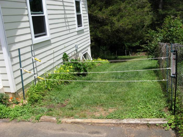

I had an electric fence around the big garden I had until 9 years ago in the creek bottom. Could move the fence easily to bring mulch in, etc.
Best fence for hooved rats is a 2 deep one in the attachment. I relocated my wire fence (one in the picture is with nylon rope) around the back yard to be like this fence. Since then, NO HOOVED RATS in the raspberries. There are daylillies and further back camellias, both hooved rat candy, in this picture.

I had a 4 ft high electric fence around the big garden for 8 years. Only hooved rat problem was if the fence charger or battery was on the blink.
With this double fence and their poor depth perception, they won't attempt to jump a 4 ft fence. Before I put the double fence in (single outer strand), I'd see them easily jump the fence out the back door here. Since then, nada.
