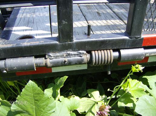

This is the way my ramps work, no lifting or struggling with them, also don't have to worry about them lifting up and falling off when starting up on them. Also the retaining pins are spring loaded and mounted to the trailer , just hold pin out while sliding the ramp out about two inches and then you can release the pin and slide the ramp out till it stops. When done just slide ramps all the way back in until spring pins lock into place securing ramps.

My slide outs are apparently pretty crudely mounted: you pull them out too far and they fall on the ground. Would like to see pics of how yours operate.
I was thinking that if I were to slightly extend the angle iron rails (that the ramps sit on) and add a horizontal catch (another piece of angle iron) then they would pull out just far enough and could be lifted into position from there.
