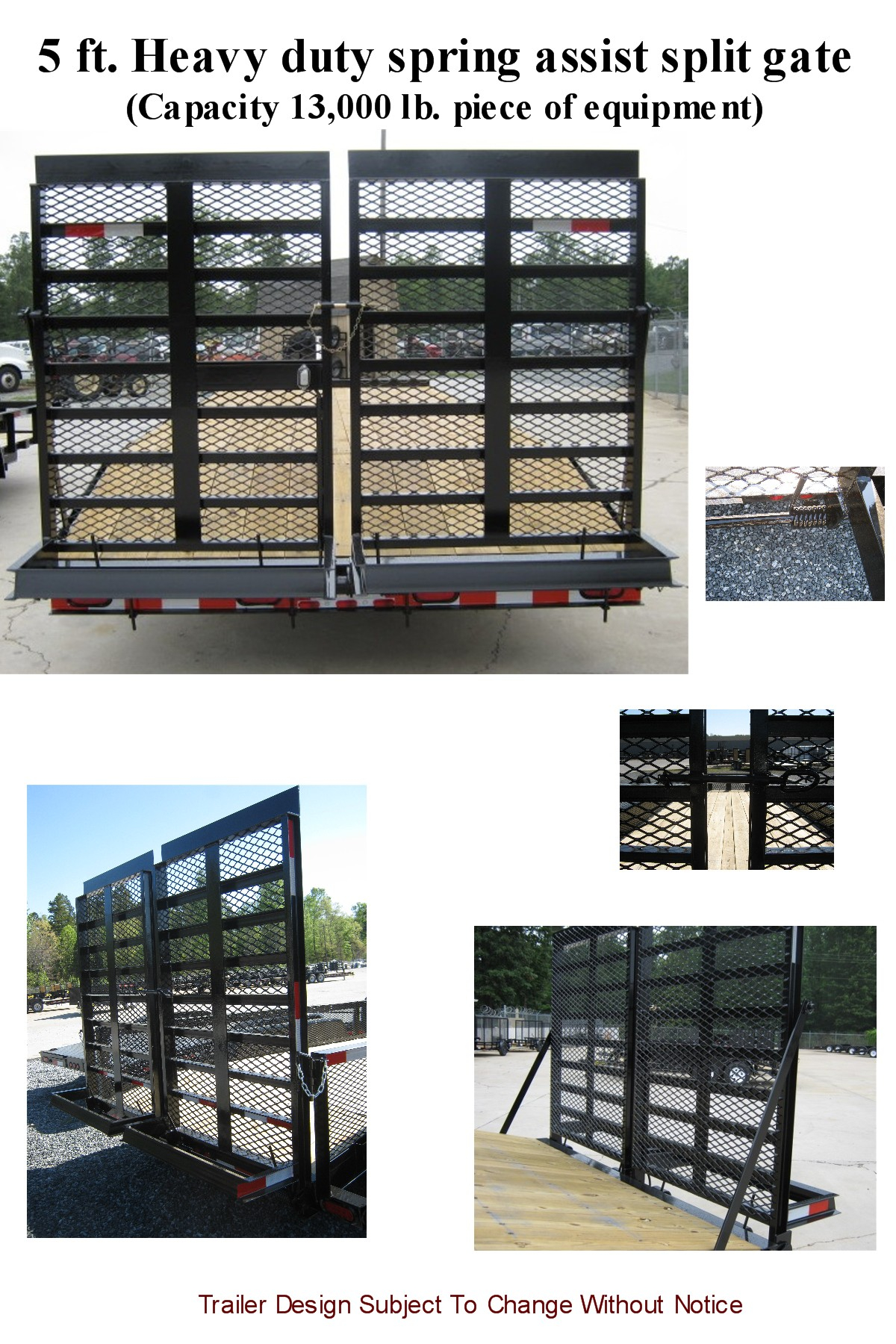

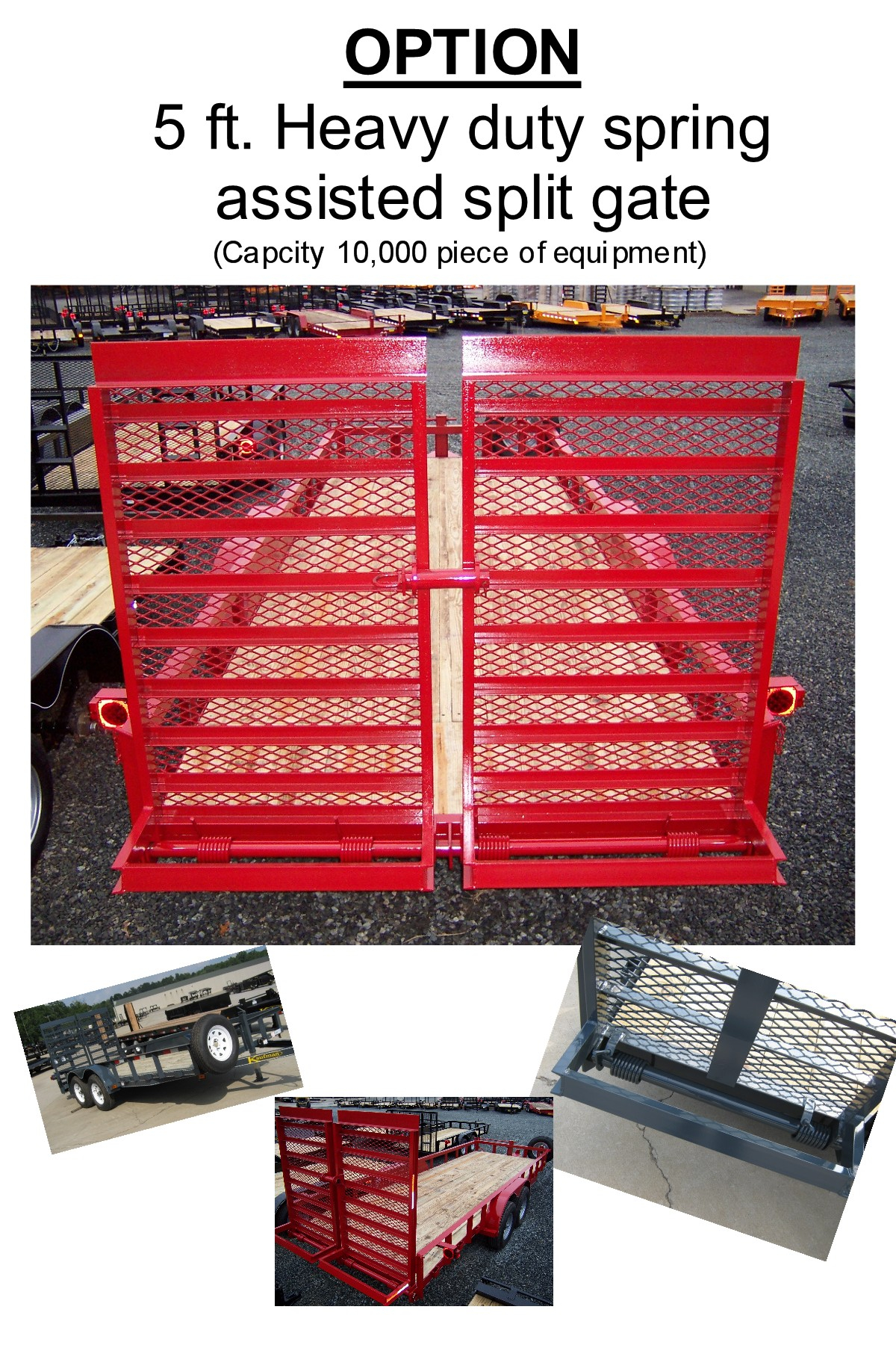

Why are split ramps so rare and seldom seen on flat deck equipment trailers?
They seem so useful and when spring assisted, very easy to flip up.
They make a trailer instantly capable of loading any wheel configuration or size or rubber tracked machinery. The reinforced wire mesh is smoother for large tractors or small diameter tires on zero turns.
When in the upright position, they do a great job holding hay bales or equipment from accidentally rolling off.
So why do equipment trailers continue to come with those awful slide-in ramps or the skinny, kind of dangerous stand up ramps? I have been loading & unloading equipment for 35 years and still think they are undersized. One slip and there’s an accident.
Is it cost? I guess everything is made cheaply as possible to stay competitive, but with all the safety features built into equipment, these seem like a no-brainer safety item.

The simple reason is they’re more expensive. I wouldn’t buy anything wire mesh though. That stuff is trash.

Why is it “trash“ if it’s reinforced underneath with the exact same or similar ladder ramp? I have a 10 year old non reinforced mesh ramp that’s still in perfect condition
/ Split ramps for equipment trailers #4
Wire mesh is far from all being equal. Some heavier gauge welded stuff would work fine. But the cheap expanded metal pulls off and is about impossible to keep welded on. But I still wouldn’t want it unless maybe I was a landscaper pushing wheelbarrows or push mowers up it. My ZT would have no trouble going up the ladder bar ramp without it.

I also believe they are an added cost that most wouldn't pay for.
I have one on my 12' landscape trailer and I can drive anything up on it. Motorcycles, to lawnmowers. Pushing a wheelbarrow up it is a snap.
But, if I were to buy an equipment trailer, I would pay the extra cost for one. Especially knowing that my tractor and vehicles have different wheel bases.

Full width Mega ramps are a lot more expensive, and not small tire friendly unless mesh added and if it is, they probably won’t lay flat.
The split ramps in the picture I showed are from Kaufman and they cost $500. Cant get the capacity of mega, but 13,000lbs is basically any skid steer or 125HP farm tractor. Not too bad?

My 20' equipment trailer has split ramps, but they are not full width.
They have no mesh, and the angle iron has the top of the angle facing up (does not hold dirt or water).
They each have hefty springs, and even this 80 year old can still lift them.
They can be slid together, or apart, on a pipe tube, to accommodate any machine wheel spacing.
They can be slid way apart, or even removed, to accommodate any particularly long cargo.
I suspect my ramps were the cheapest design for the manufacturer to build, on a $4,400 OTD 14K trailer.
Certainly cheaper than also using mesh on top of the angle material.
I am satisfied with the design of my ramps, though they would not be good with a small wheel diameter machine, like a lawn tractor.
Most people (me included) do not normally carry a lawn tractor on a 14K equipment trailer, though it certainly can be done.

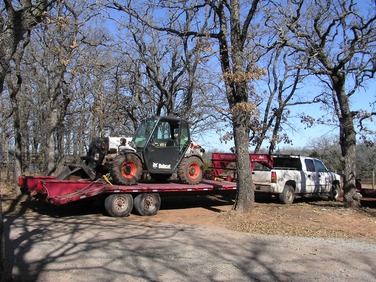

My 22' deckover GN with flip up ramps that can be hydraulic powered :) .
Click to see how: Compact telehandler
