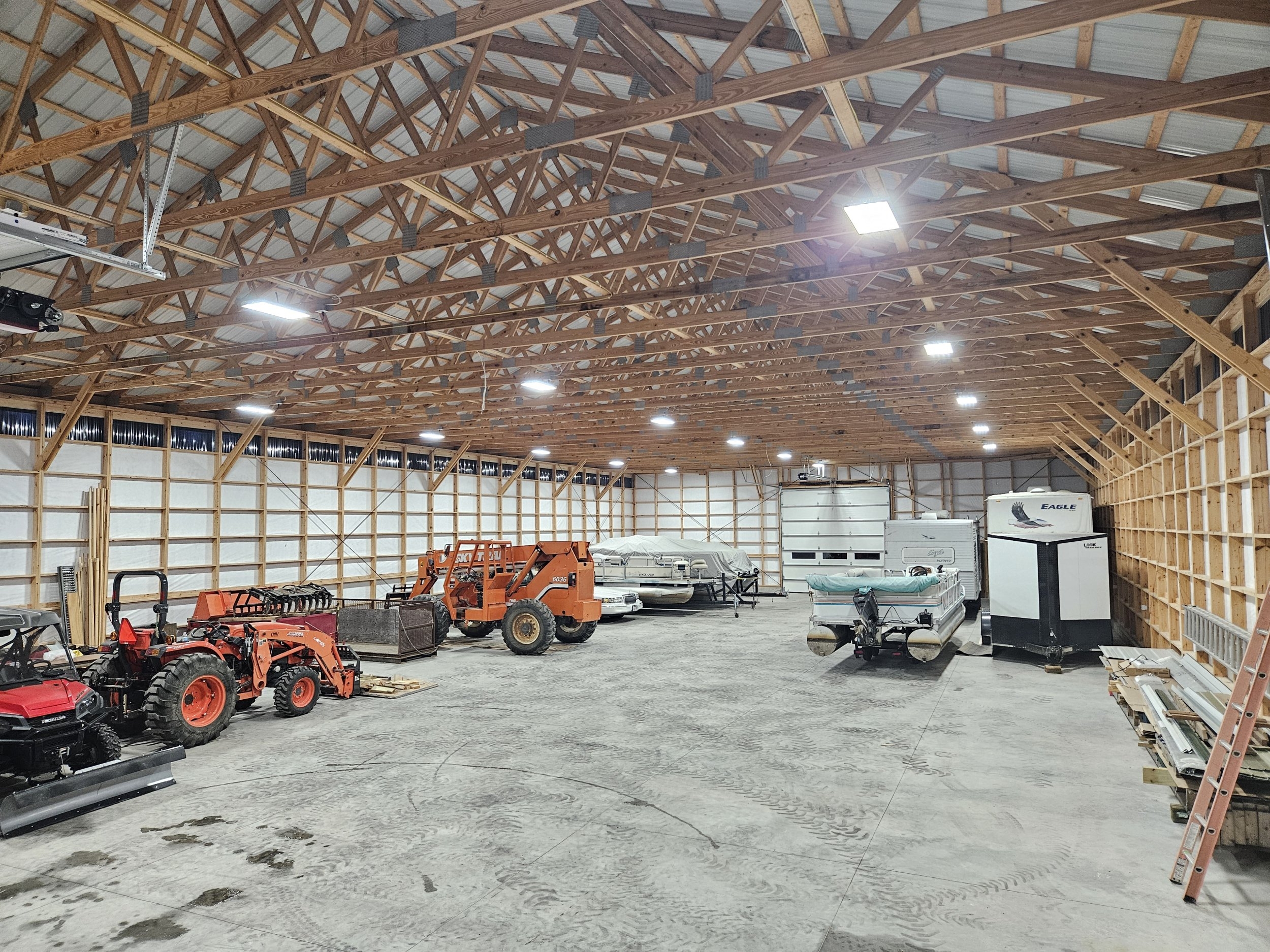

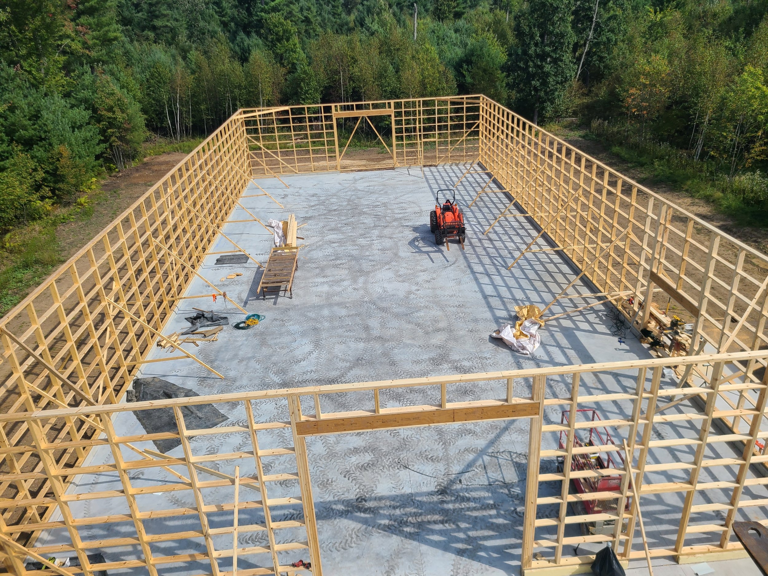

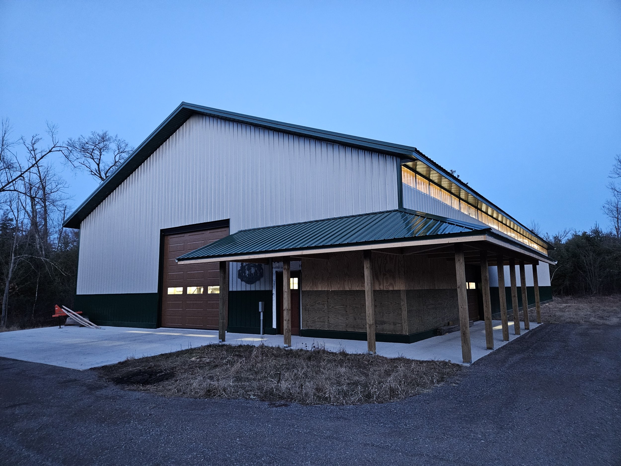

Needed some more space...figured go big or go home! 60 x 120 by myself working weekends! Renting out the extra space.

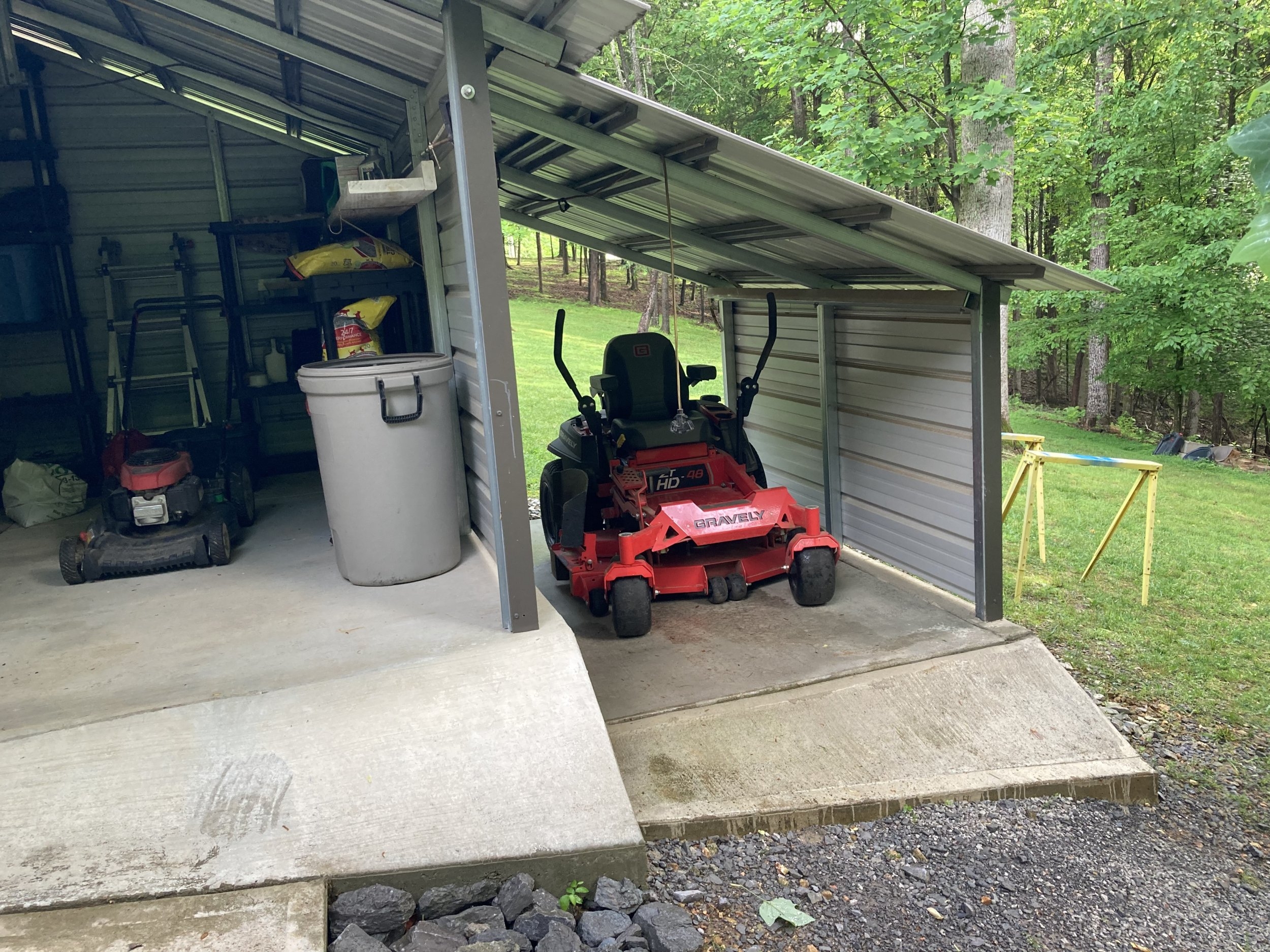

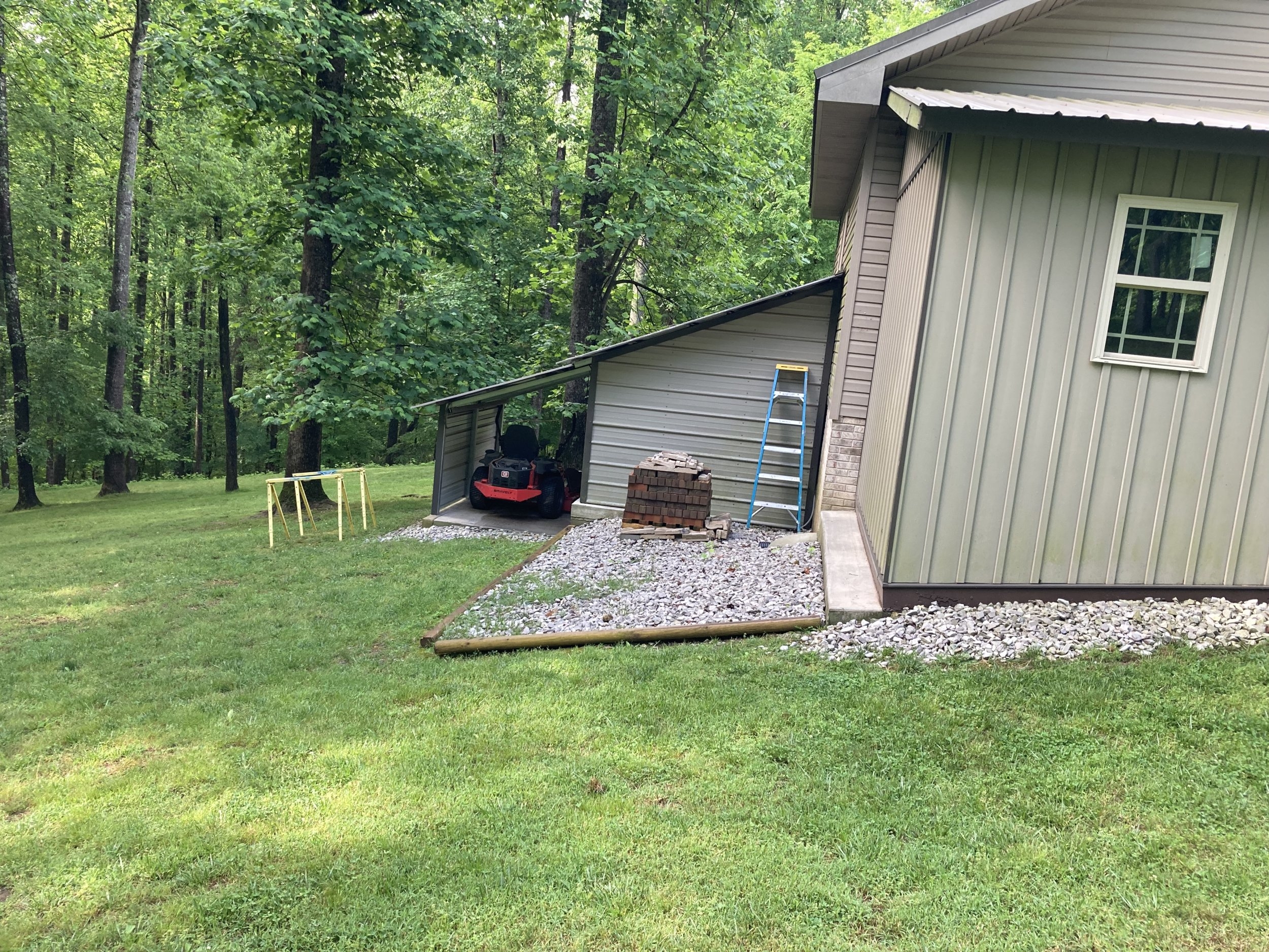

Sold my older yanmar and can now get by with this at new 2 acre place

Damn, that's nice. I rarely have "building envy", but you're making me feel it!

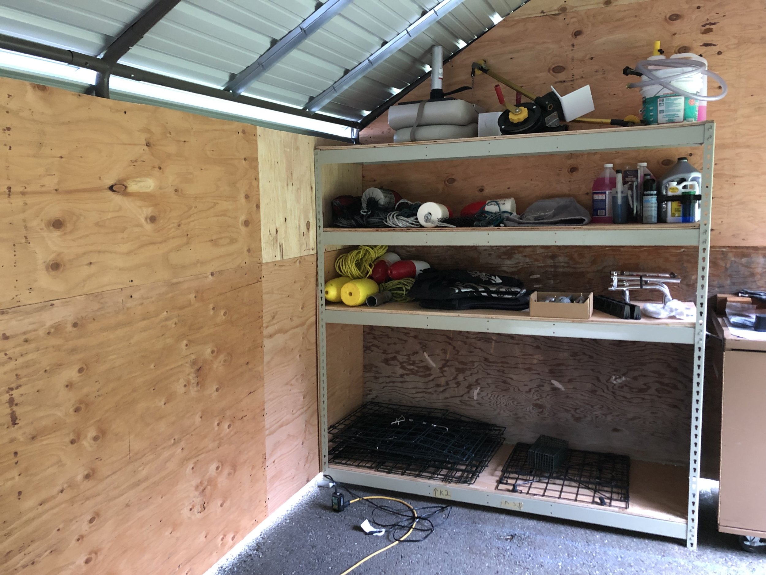

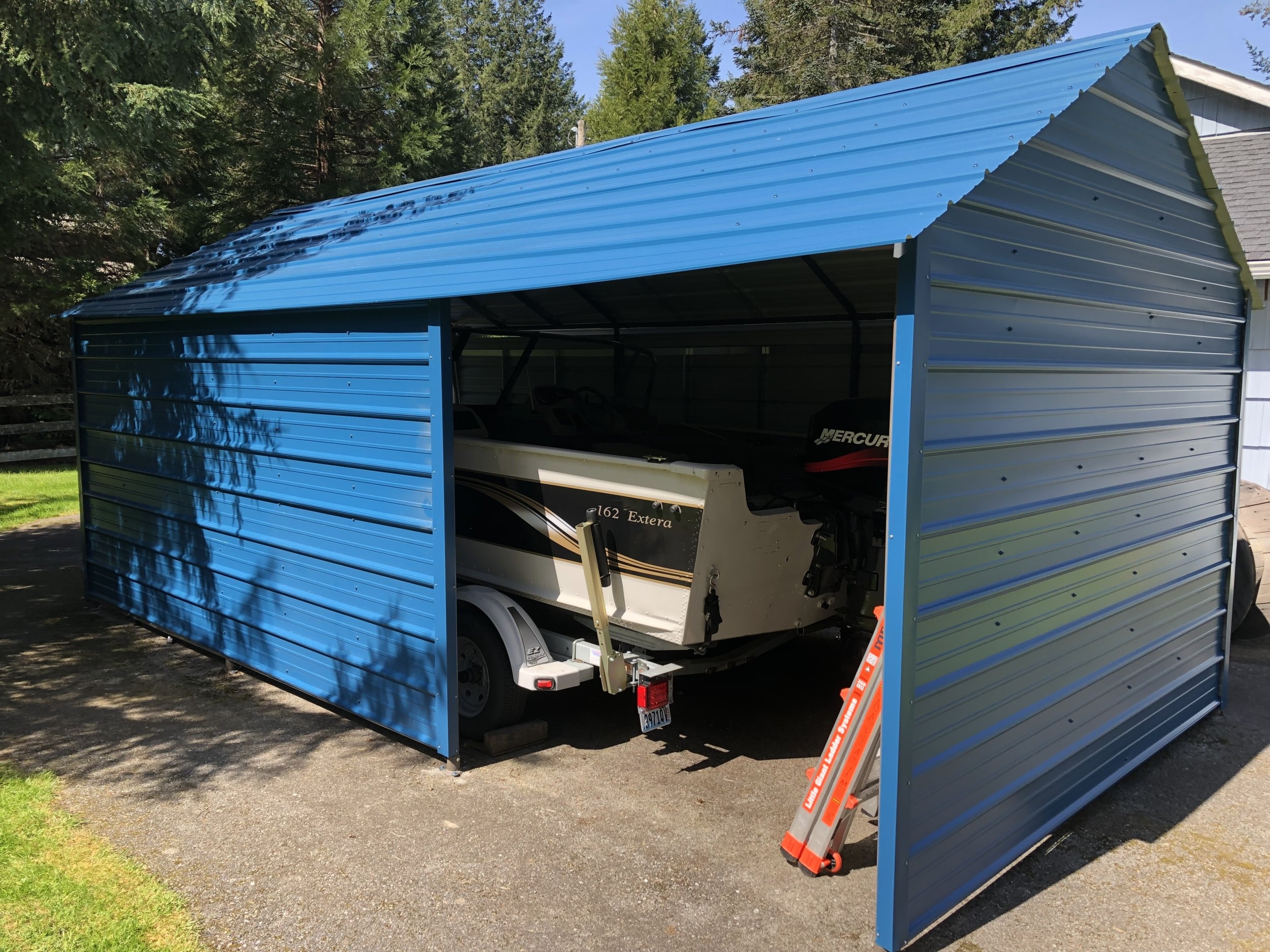

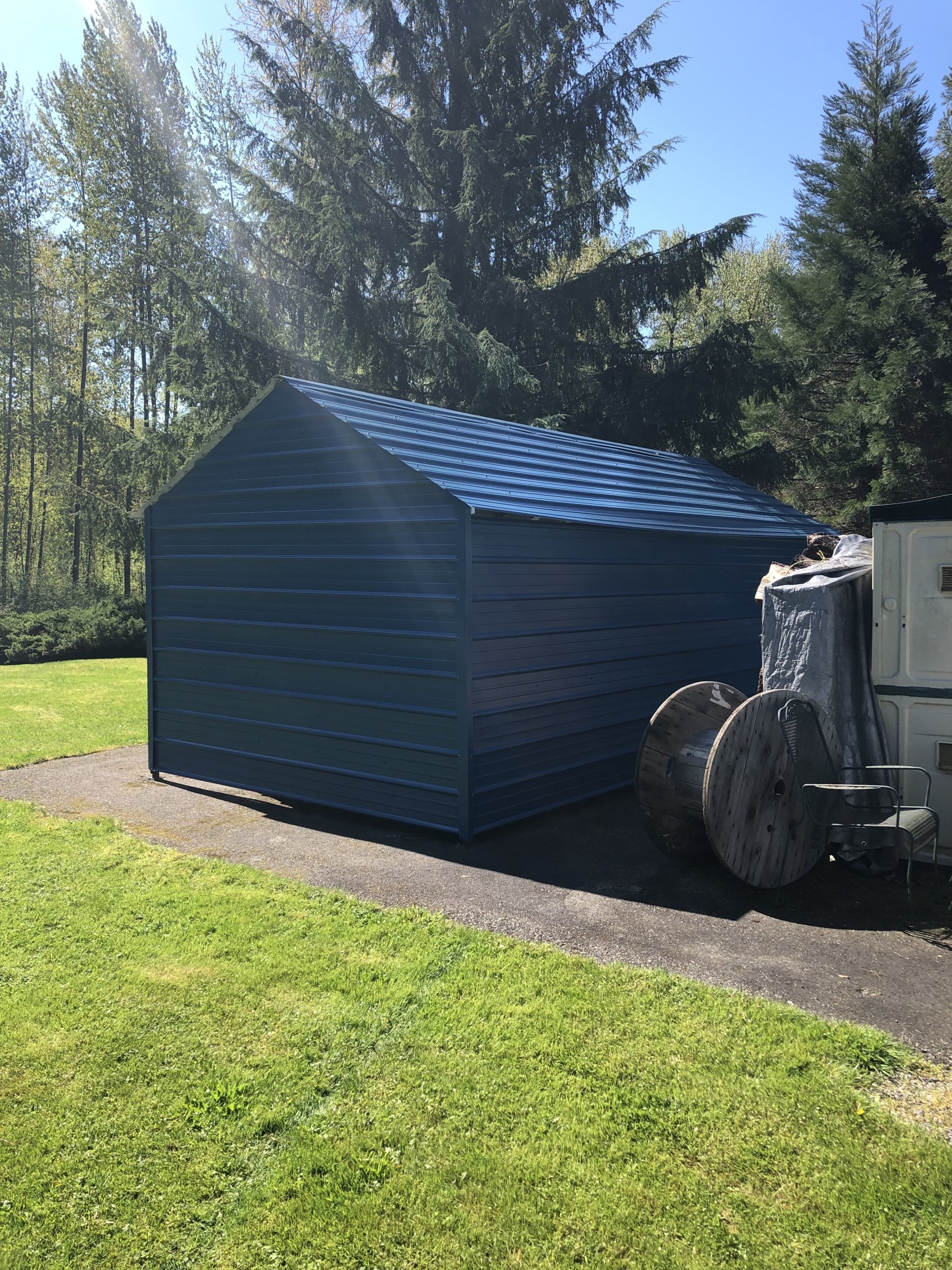

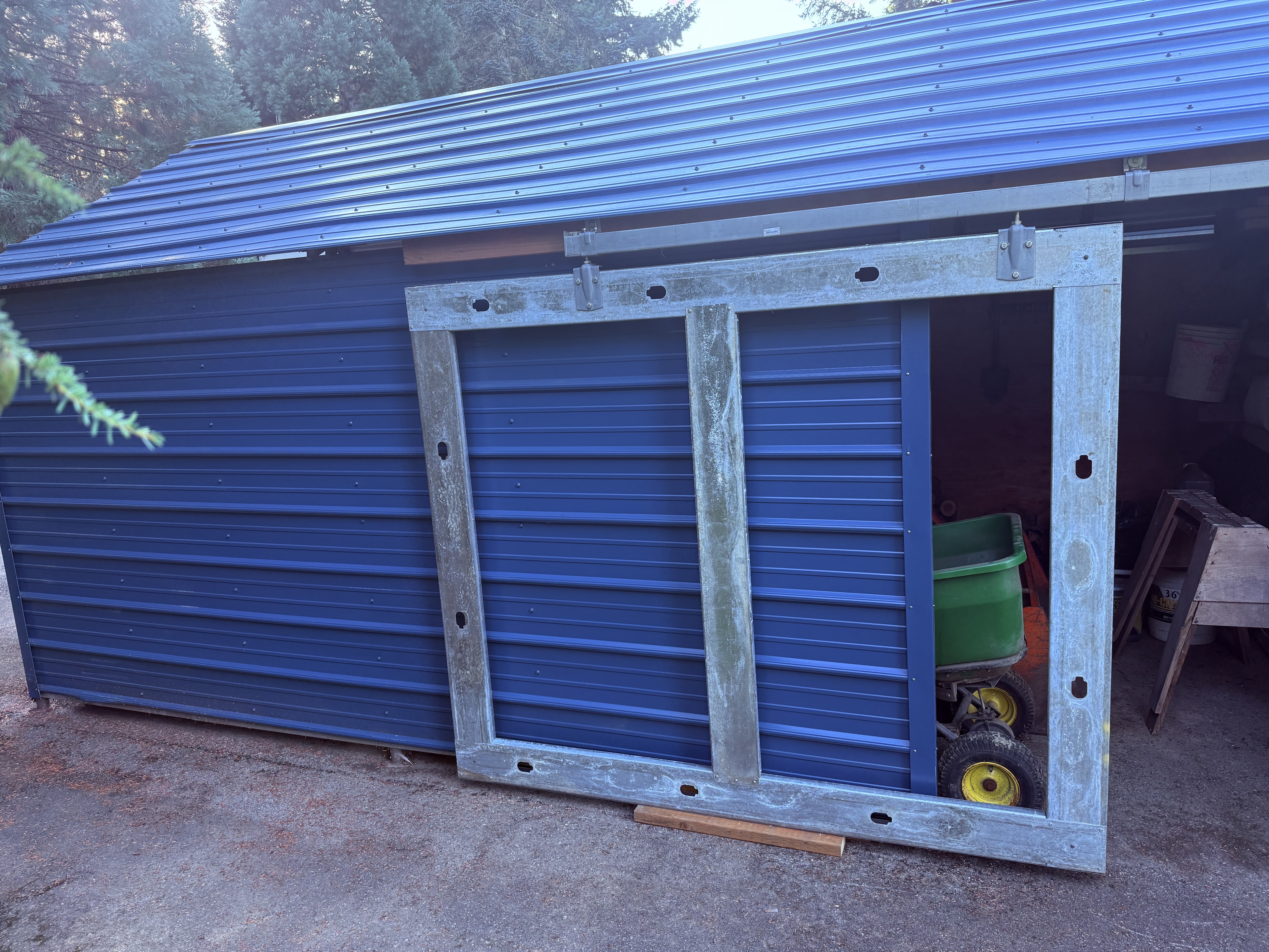

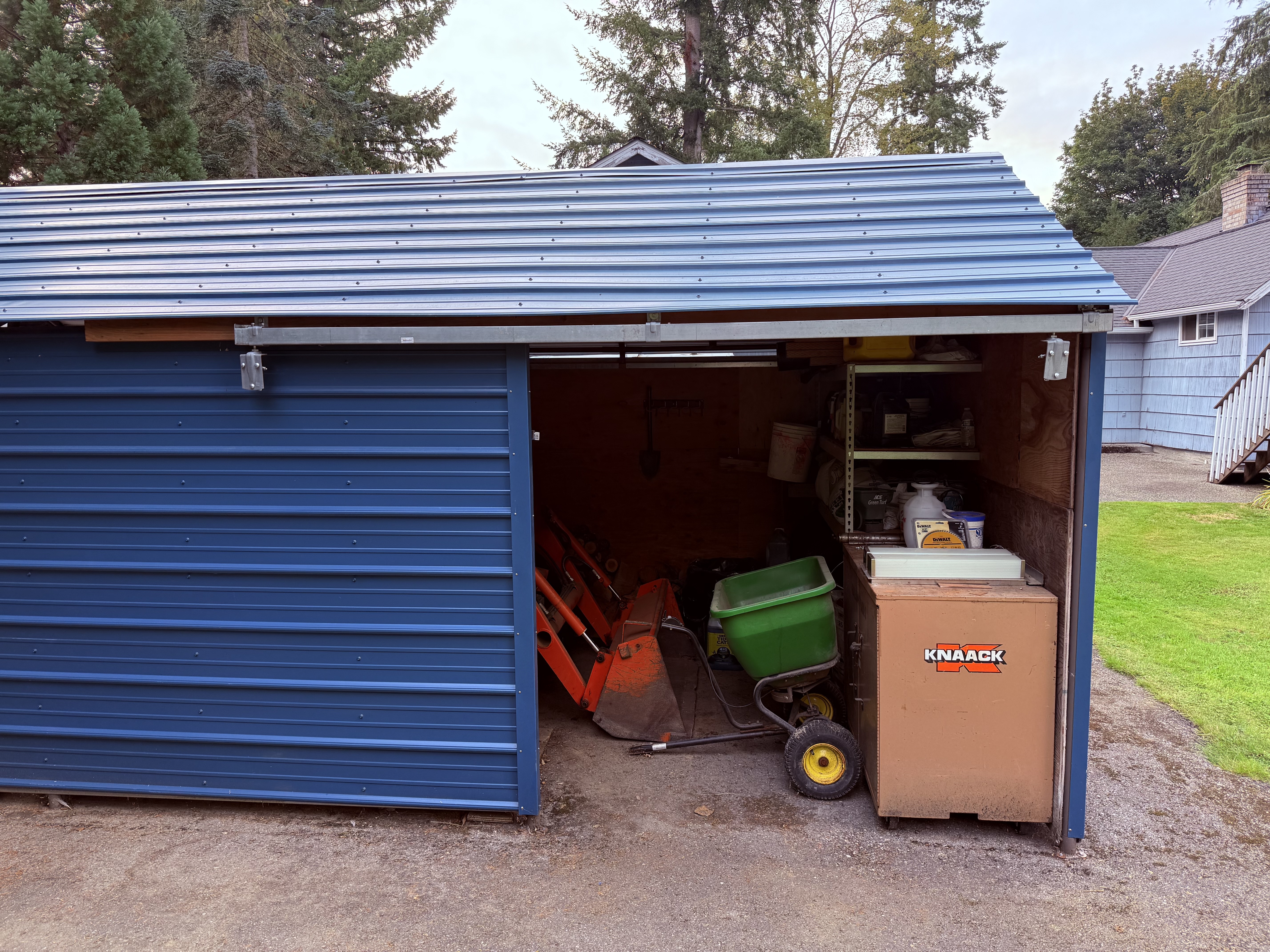

When I had boats I got a Costco 24x12 “tent” structure and had to replace the canvas on it twice. The second year after I last replaced it I decided to use the “bones” and frame it out and clad with metal. Then I used plywood inside on the walls to shore it up or as shear walls. Also good to mount hangers, shelves etc. The last pic was when I still had my boat in it however now my Kubota lives there. All in I have just over $2.5k into it as I shopped the materials and got the metal wholesale.
Just got rid of the old tarps I had and beginning to build and hang doors. Side door is a sliding barn type. I’ll sheet it with metal this week and the front doors will be swinging double doors in the front. Those I’ll probably put off ‘til next spring.

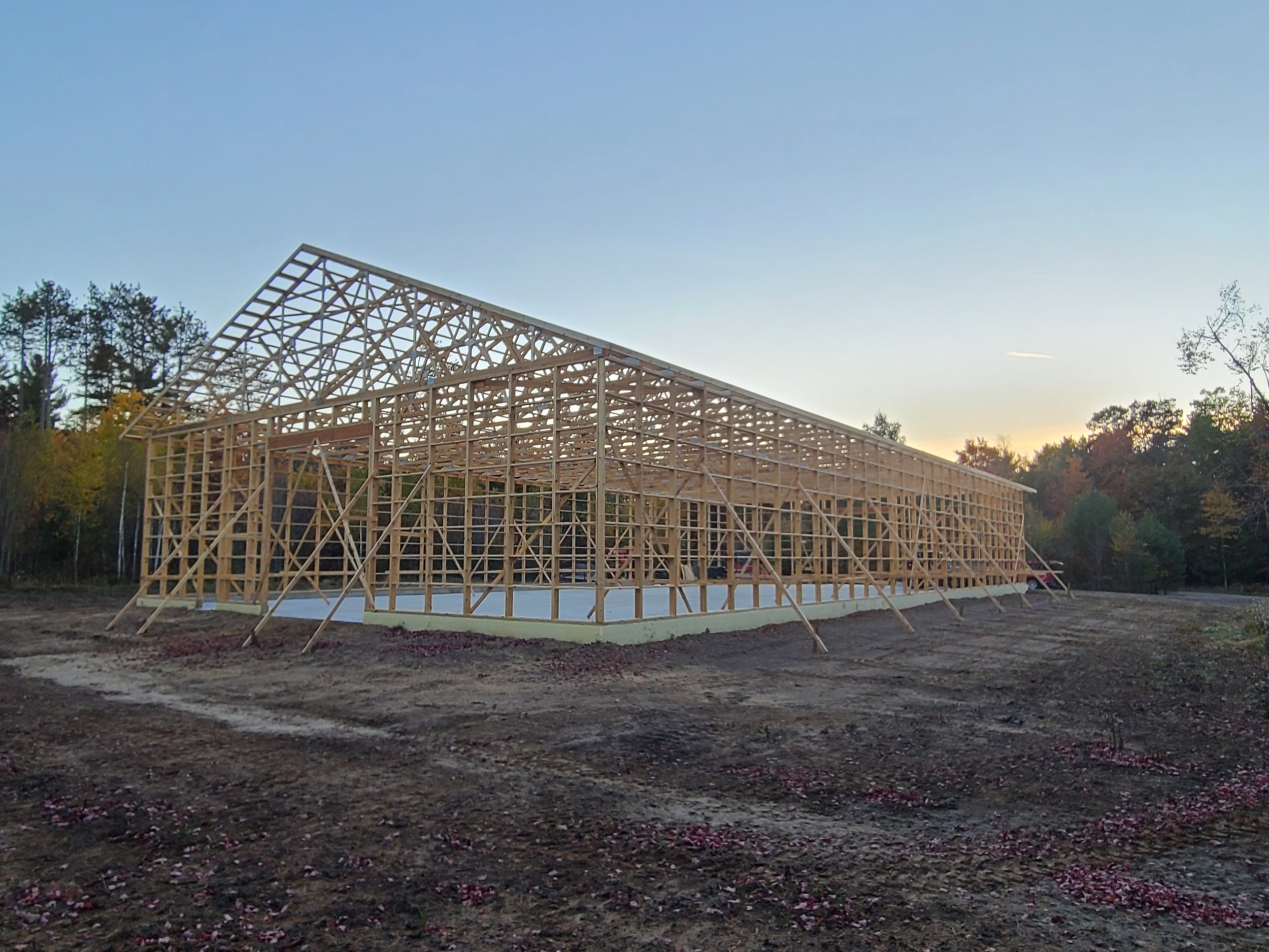

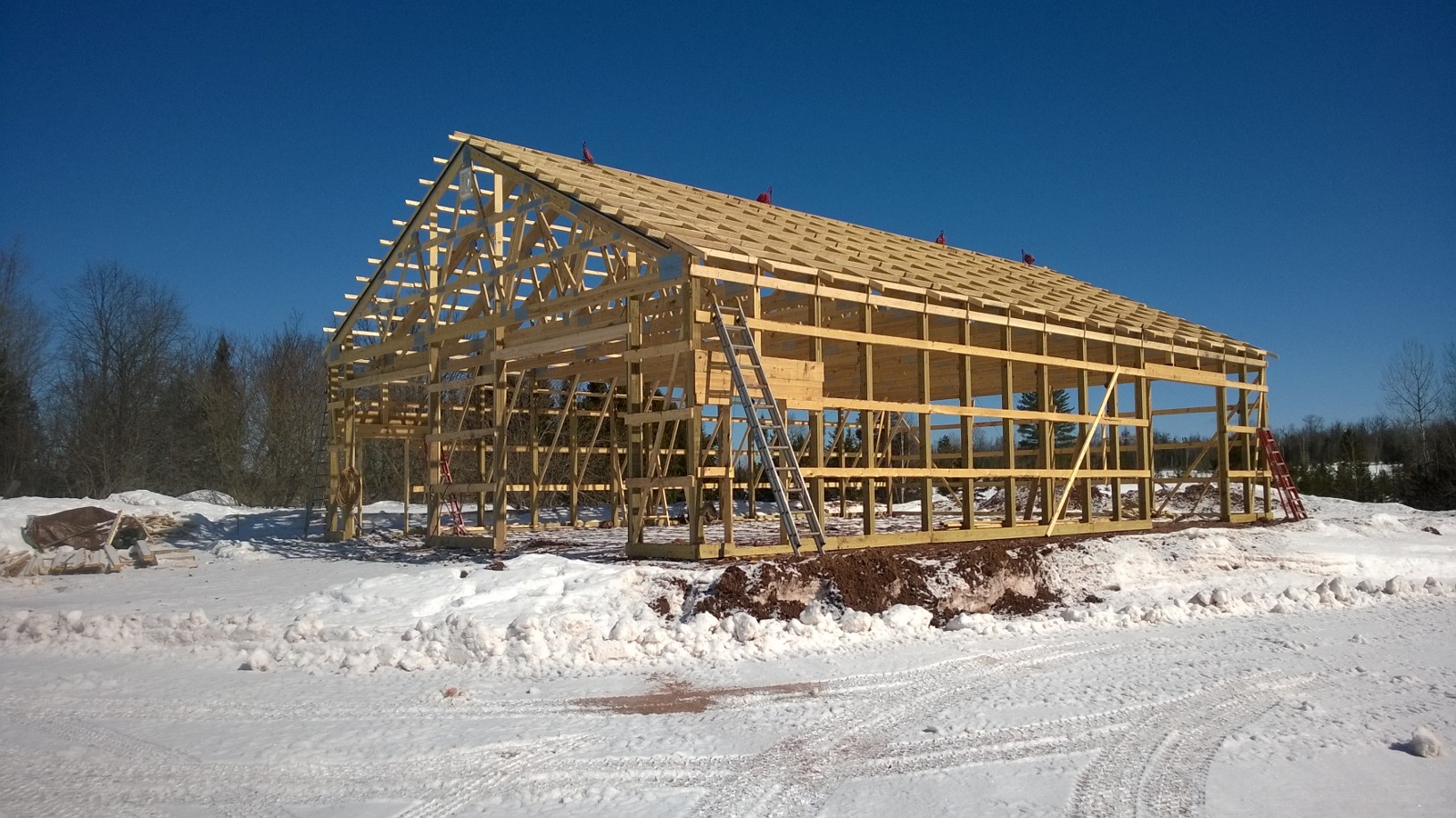

The whole barn is sitting on sand, but the back 2/3 of my PB is on a hill side. The dozer operator built me a very large bathtub with clay and we filled it with 400 yds of compacted sand.
Notice the purlins, they are vertical 2x4. Top of the truss are 2x12 and bottom are 2x10. This gives me 100 lb snowload.
