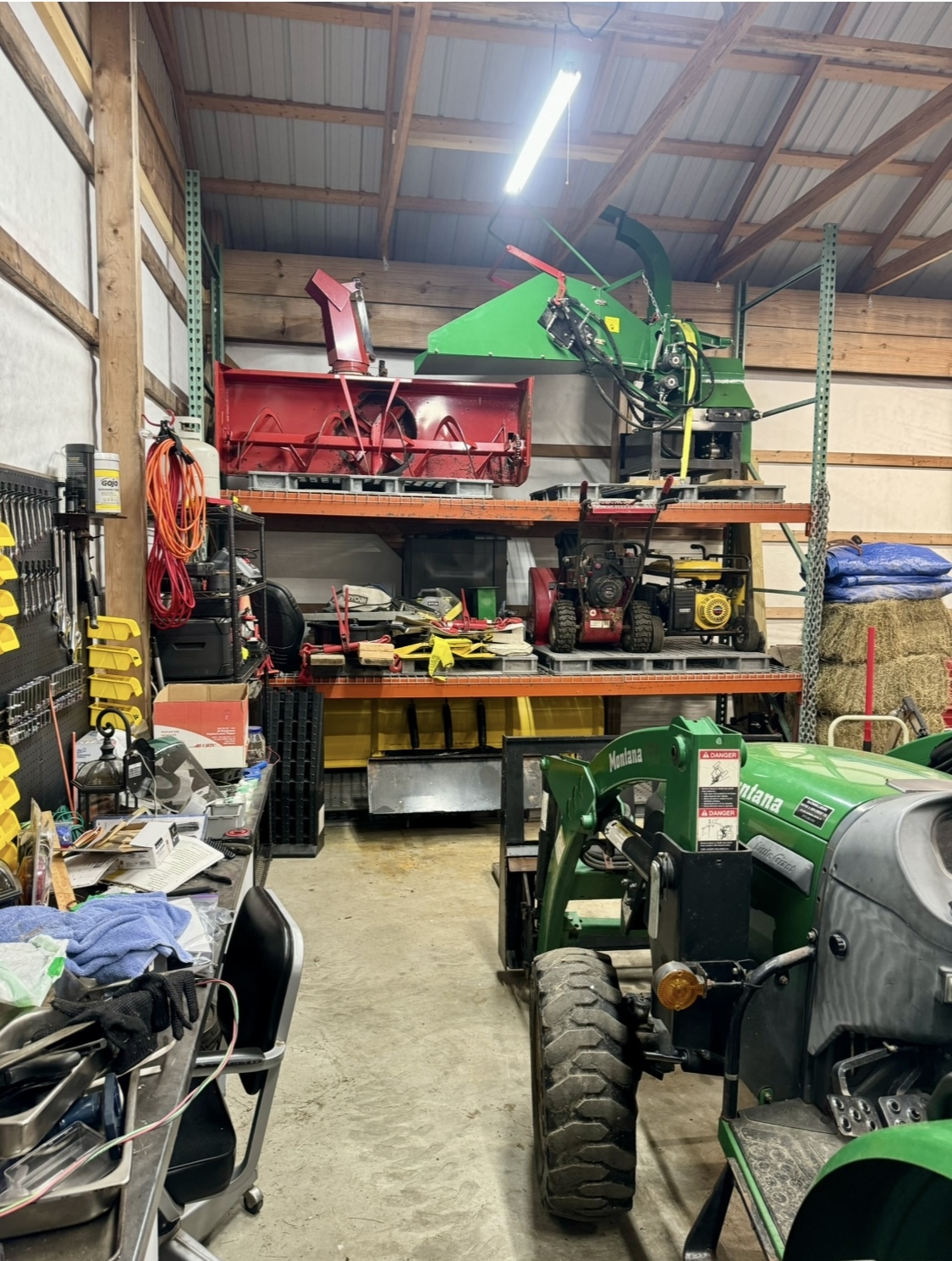

We built a 30x40x12 barn and the tractor shop is 13x30. I store most my implements on a 12’ wide, 12’ tall pallet rack. It stores my snowplow, snowblower, chipper, rototiller, forks, bucket and grapple.

Nice use of pallet racks. Are you able to put the chipper and snow blower up there using the tractor in the pic?
Yes. The blower is light, 450 lbs or so. The chipper is more of a load, 950lbs. We put the blower up on the shelf yesterday. Chipper will come down in the next couple of weeks. My Montana tractor front end loader is rated to lift 1600lbs to full height. Not sure I would attempt that. At 950 lbs the back end gets really light, even with an 800lb concrete weight on back. Maybe I need a lot more rear ballast. My Montana has a 28hp 4 cylinder Mitsubishi engine.

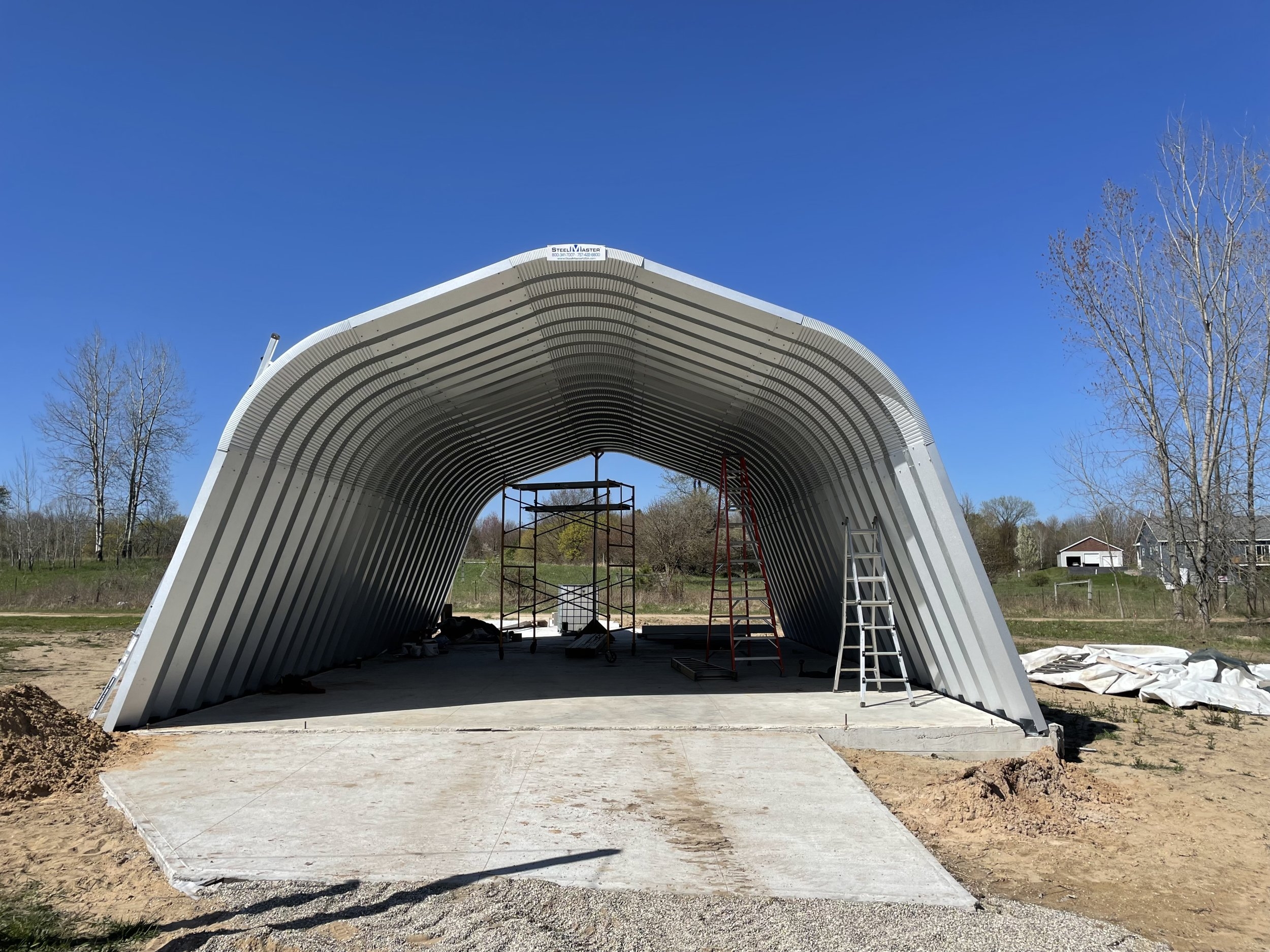

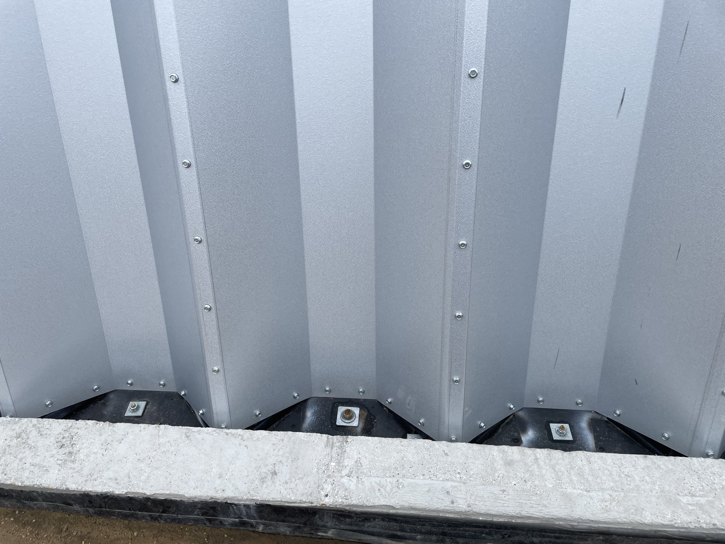

I am finishing a SteelMaster Quonset. They said I was out of warrant so a missing piece was going to be another $126. I bent one myself to finish the job. The sent plenty of bolts. Seem knowledgeable, however the price they wanted for the baseplate was crazy high, like 6k. I designed and built my own for $1700. The dimensions are 30’ X 48’. Closing the ends with drive through sliding doors 12’ X 15’.
