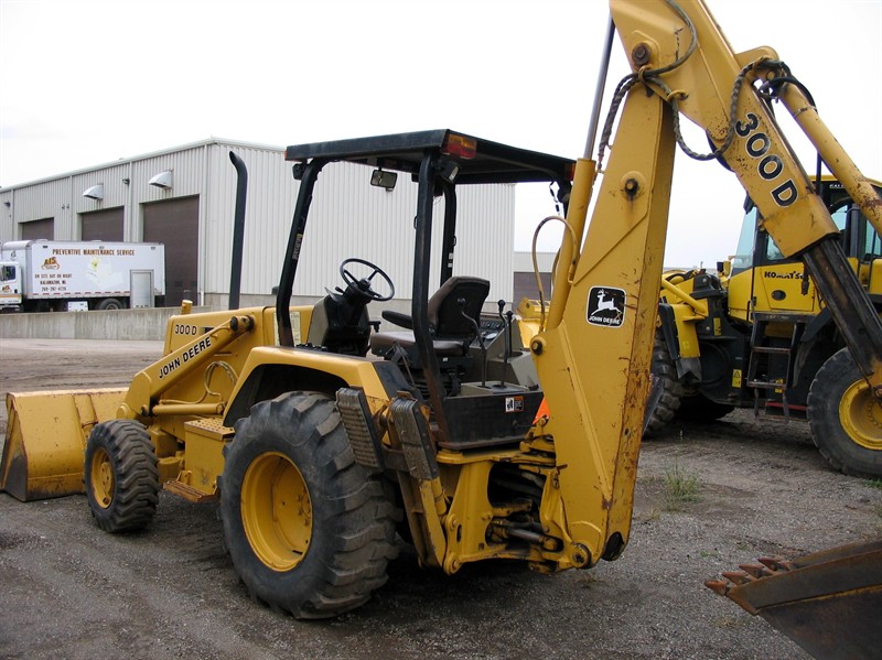

I want to add one term to the discussion: Utility Tractor. As said before, a TLB is primarily designed to excavate with the BH, then load into a dump truck with the FEL. It does not lend itself easily to swapping implements, except for quickly changing BH bucket sizes and a roller/compactor for backfilling trenches. A Utility Tractor, on the other hand, is designed for versatility. It is a utilitarian machine, meaning it is designed to do many things fairly well, while not specializing in one or two things. Most of us have a UT, a CUT, or a SCUT. Utility tractors are not as heavy duty as TLBs, however, in their "utilitarian" design, it is far easier to change implements for the task at hand. A BX25 is not a true TLB; it comes with a BH, but it is in reality a SCUT. For totally specialized jobs, there are dedicated machines like ZTRs and tracked front excavators; these specialized machines are very non-utilitarian. A TLB is not a "bad" tractor; it is just not a utility tractor.

/ Do TLBs make "bad" tractors? #30
A regular ag tractor Kubota or otherwise is really not designed to move dirt day in and day out. A TLB is. This is because of the bigger GPM pumps, larger cylinders and mainly because of the heavy duty one piece no twist frame. It also depends on how often you really are going to use the tractor, a lot of guy put maybe 50-200 hours a year on their tractor...but if you are like me (1000 hours on L39 in 23 months and 500 hours on B26 in 12 months) then the heavy duty structure pays off. The TLBs do cost you quite a bit more up front but if you are really going to be running the tractor 6-8 hours a day, in my expirience the TLBs hold together well. Like I said before in this post I can go from digging a stump with the backhoe to pulling a box blade or shredding in about 15 minutes then I can go back to backhoe in about the same amount of time. I simply leave my backhoe off most of the time and leave the 3 point hitch connected with a quick hitch...so now it is like a regular tractor. I can switch from implement to implement in under 2 minutes...so I do not see the down side to this set up. Just my 2 cents.
Ryer
P.S. find the size tractor you think you will need...and buy the next size up or you will always wish you had :)

SCUT, CUT and utility tractors..... Multipurpose tractors. TLB's easy off FEL's and BH's and with PTO's and 3ph's. This being a Kubota owners forum then it seems to reason to me that the definition provided by the manufacturer Kubota would be the definition we use here and not what someone has decided they mean in their minds because that's what they've always called them. This is what Kubota defines their TLB's to be.
:D You are so much fun to debate. I love ya, but gotta play oppositional advocate here. These terms had a meaning before Kubota ever made or sold tractors. So on whose authority does Kubota get to change the meaning? I'm going to draw an analogy to cars.
Back in the old days, it was pretty easy to distinguish between a sedan and a pickup truck. Then along came panel vans, jeeps, full sized vans, and station wagons. Now pickups had separate cabs and beds, until Ford decided the '61-'63 F100 should have a unibody design. Then someone decided that pickups could be built on car frames and we got the Chevy El Camino, Ford Ranchero, Cadillac Mirage, and the VW Rabbit PU, all unibody designs. Were those things cars or trucks? Does a car make a bad truck; does a truck make a bad car? What if you're talking about one of those four vehicles? Now along come the minivan and SUV. What's a minivan; is it a little van or a big station wagon? What is an SUV: a car, a truck, a station wagon? Well, it's built on a truck frame, so for EPA mileage, it qualifies as a truck. Uh, oh, now we get the crossover, a SUV built on a car frame, so what is that? Oops, that's not enough, now we need to cross the SUV with a pickup, so we get the unibody Sport Utility Pickup in the form of the Honda Ridgeline, Cadillac Escalade, and Chevy Avalanche. Oh, we can't let the crossover be outdone by the SUP, so we need a crossover Sport Utility Pickup: the Subaru Baja. What is this thing in the pic below, what are the right terms? Is it a car, pickup, SUV, crossover, SUP, crossover SUP, all of the above, none of the above, or what?
I think there was a time when the terms TLB and Utility Tractor had distinctly different meanings, just like you could tell a sedan from a pickup and there wasn't a lot of in between stuff to muddy the water. The meanings of words change. Middle English is hard enough to understand, and Old English is unreadable to everyone except linguists who specialize in it. Heck, when I was a kid, the word gay just meant somebody was happy, and to say that someone or something "sucked" was an incredibly vile slur. My father would have slapped my teeth out of my head if he had ever heard me say that someone sucked. Before WWII, the word plastic was an adjective, a synonym for flexible; now it is a noun for a synthetic material.
I think that in the realm of big agribusiness and large scale commercial construction, TLB and Utility Tractor probably mean pretty much what they did in the post WWII years; in those days, family farmers used a utility tractor, never a TLB. In the realm of those of us who need Estate Tractors so we can pretend we are Mr. Douglas on Green Acres (tee, hee, hee), the waters have become muddied. I would agree with you though in this, makers of these smaller tractors have mixed and matched so many features on these little things that they almost have to apply terminology in a broader sense. You say you once taught at the college level. I would assume therefore that you have some knowledge of the field of etymology, the study of the origin of words and the evolution of their meaning over time. The meanings of words change. The place I am going to disagree with you is in who gets to decide what words mean (other than Bill Clinton). It seems that you imply that individuals do not get to decide what words mean, while Kubota does. I would posit that Kubota has never built a single piece of truly big commercial Ag or construction equipment, not the kind of stuff Caterpillar builds. I do not think it is inappropriate for Kubota to borrow the term TLB to describe a BX25, however I think my statement that a BX25 is not a true TLB is closer to being correct in the original context of the term.
So where does that leave us? I think we need to ask the OP to be more specific about his original question (which he has now done). Is he talking about a big Case TLB used to lay water mains in paved roads? If so, I would reply that this tractor is not a good choice to use as a utility tractor due to the time it takes to change implements (as well as the mass and size). On the other hand, if he is asking whether a BX25 is more difficult than a BX2360 when it comes to changing implements, the answer is that there is no difference. So, with all the kazillion options and sizes in today's market, rather than the original question, "Do TLBs make bad (utility) tractors," it is better to ask what most people here ask when they say, "Here are the specific tasks I need to do, on this much property, in this amount of time. What tractors come the closest to meeting my needs?"

I have a B21. It has a frame mounted backhoe unit that is easy to remove and put on after you've done it a few times.
When the backhoe is off, it's a great little tractor. Now the B21 has low PTO HP, so if you're doing much with the 3 PT stuff I'd look at a B26 or maybee bigger (L39?). I've run a small tiller and landscape rake with my B21. When I use the landscape rake to pull out the rocks in an area I've just tilled, it's great to have the loader on there to pick up the rocks.
The only downside is you always leave the loader on. I've never taken mine off, the "guess" is that removing it is a 3 hour process.
Due to the low horse power on the B21, I got a JD 4520 (50 HP on the PTO) so I could run a 6 foot rotary cutter. If I had a B26 I might have got a 4 foot cutter. With a L39 I could run a 5 or 6 foot cutter.
I dd not get the loader for the JD 4520 since I had the loader on the B21 TLB. Agree with other poster that having a backhoe is costly but very useful. the cost of the backhoe on the B21 is about the same as the loader on the 4520. I've also used a L39. I actually prefer the small size of the B21 for most of the utility and maintenance stuff I do. The small size is great for me. Again, the hardest part about selecting any tractor is knowing what you want to do. No piece of equipment is a jack of all trades, you need to intelligently manage the trade offs when you decide what to get.
So, to answer the OP, a TLB does not make a bad tractor. Asses your needs just like you would any other tractor (PTO HP, weight, width) and then realize you'll always have that loader sticking out in front. Also realize you'll only have rear PTO attachments. If all that is not a problem for your property and work areas, well, you're good to go and a TLB makes a pretty good tractor too.
