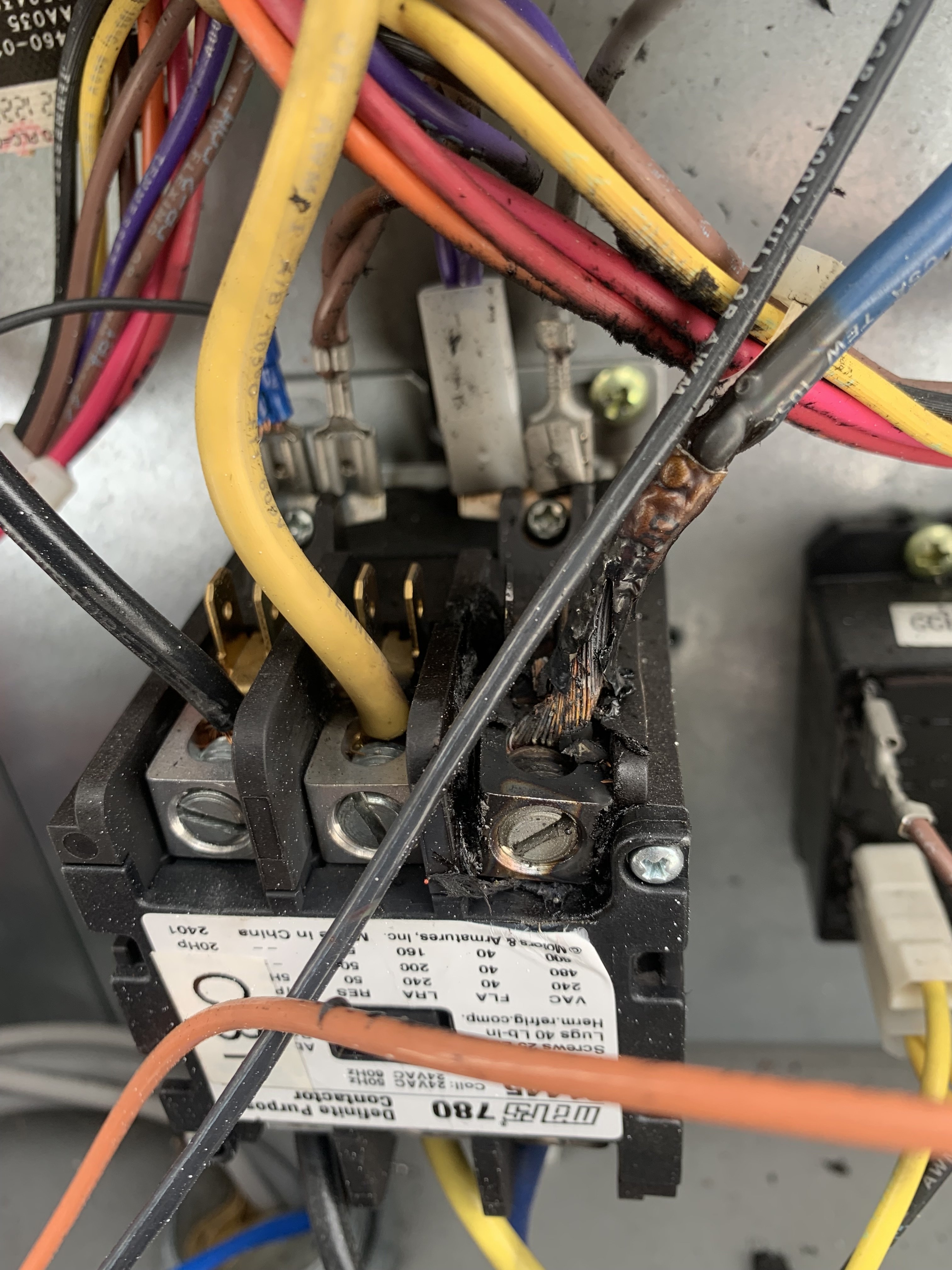

Yesterday a bad contactor blew two of three 125 volt 480 volt fuses that again required supply house to open after hours and no 125 amp only 100 on shelf so using the 100 in place of 125 until tomorrow.
The failure also tripped the 125 amp breaker in the panel room…
I don’t see the need for both 125 amp fuses at the service disconnect on a 125 amp circuit breaker protected dedicated circuit…
