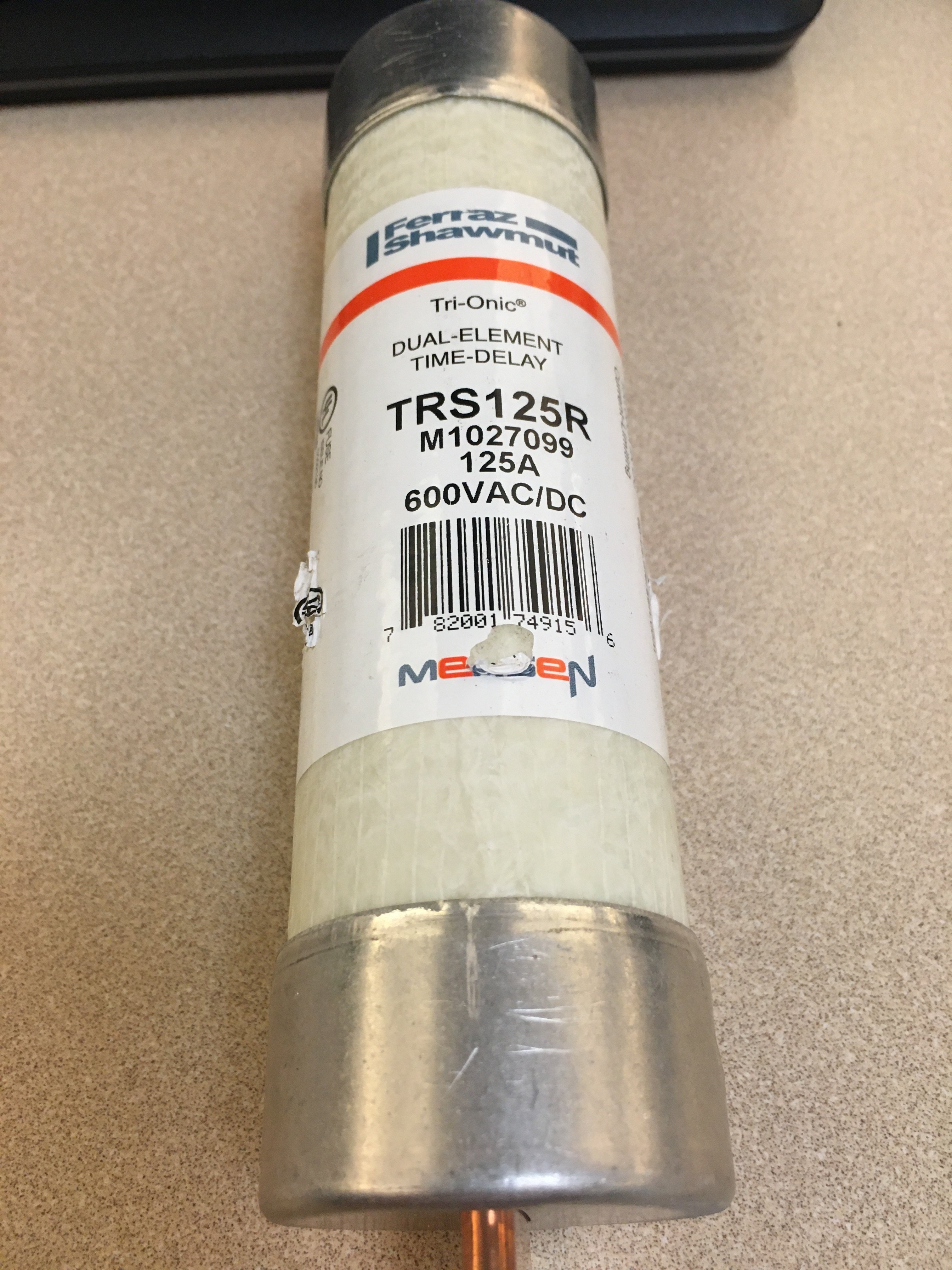

The inside the unit factory breakers stamped made in China and they have never tripped…
I think that is to @grsthegreat's point about the speed of tripping on a fast fuse vs a circuit breaker more than "Brand Name" vs "Off brand"/"Made in China" in particular.
The on equipment/near equipment fuses are there to limit the damage to the equipment and the upstream breaker is there to prevent damage to the wires. They have different jobs/functions to my way of thinking. In my own limited experience, all of the large equipment installations that I've been on deck for had detailed specifications on minimum current, maximum current, and type of fuse to be installed.

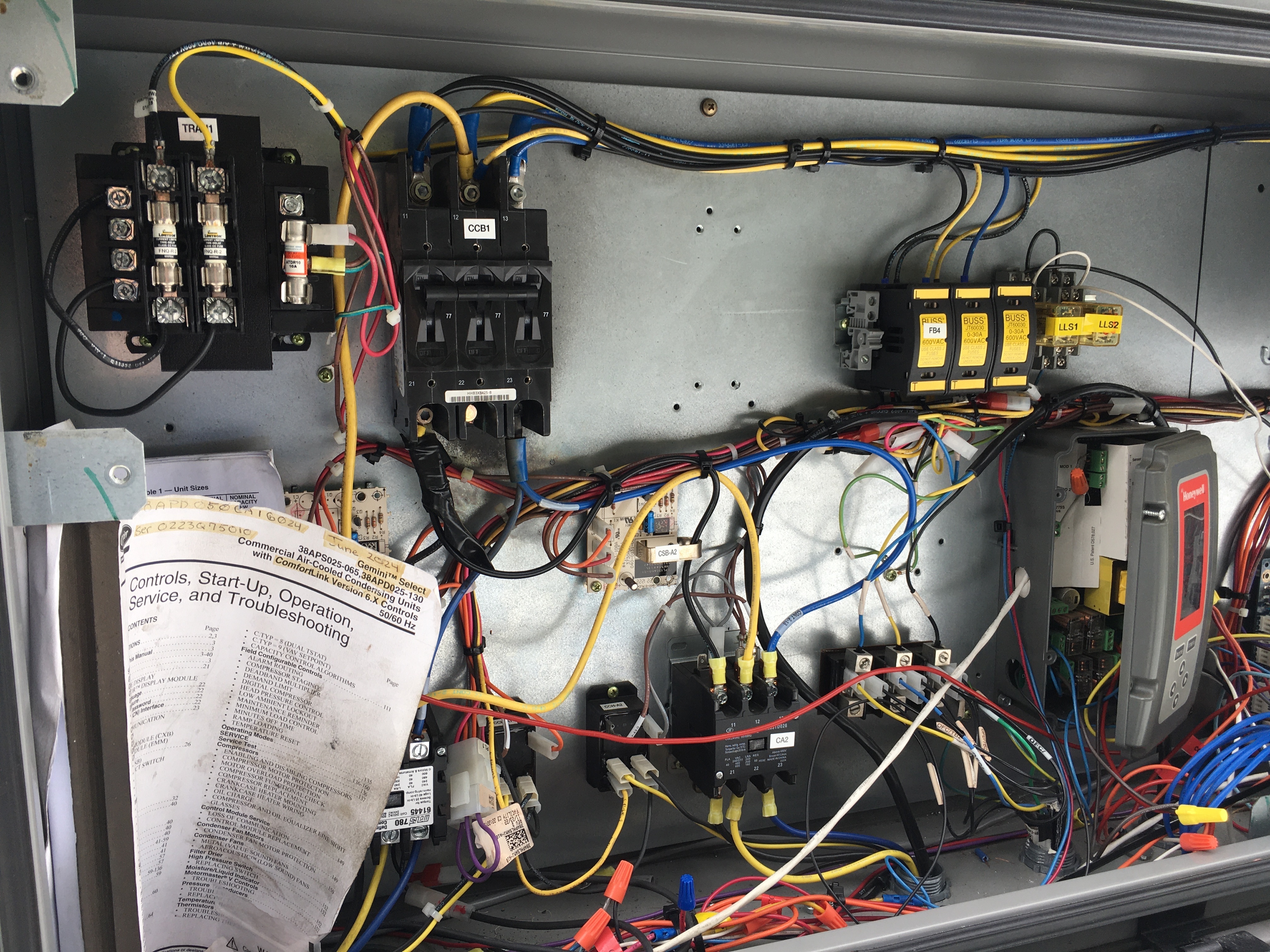

If it were me, I'd buy a second board... I detest this trend in HVAC in particular of not stocking spares of even current equipment, especially for equipment with known track records of failures.
I can't tell from your photo, but there might be an electrical technician nearby who could repair the board, especially if you didn't lose a microcontroller. I do think I'd be wondering a bit about why some many pieces let out the magic smoke at once, and I would want to develop a plan to find and address the underlying cause. That's a lot of broken items.

This project install started June of last year… all time off and leaves canceled pending reliable HVAC in place…
I’m holding a substantial sum pending completion.
The inside the unit wiring is a almost a rats nest as jumpers needed to function are in place while waiting on the new circuit board.
