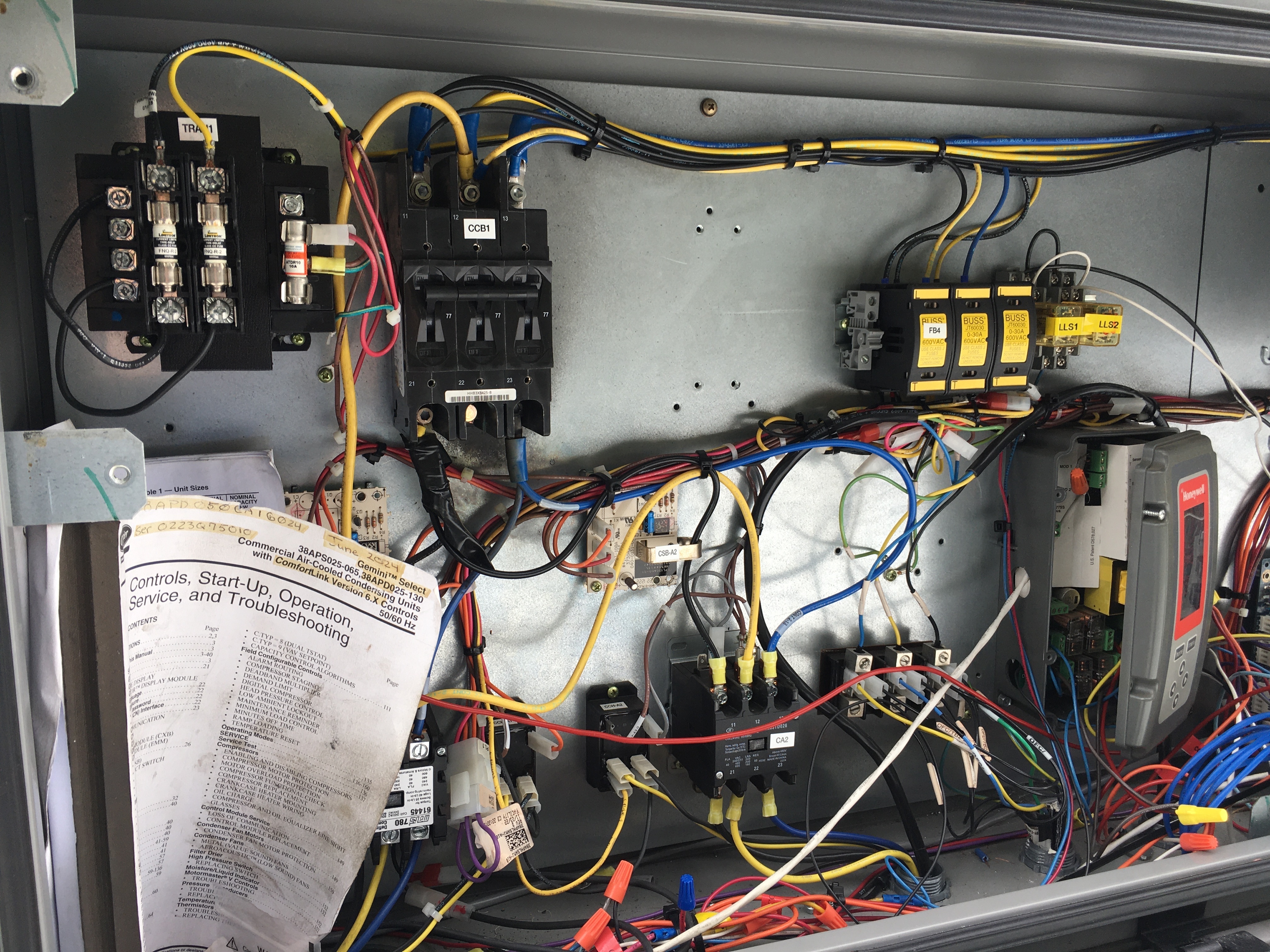

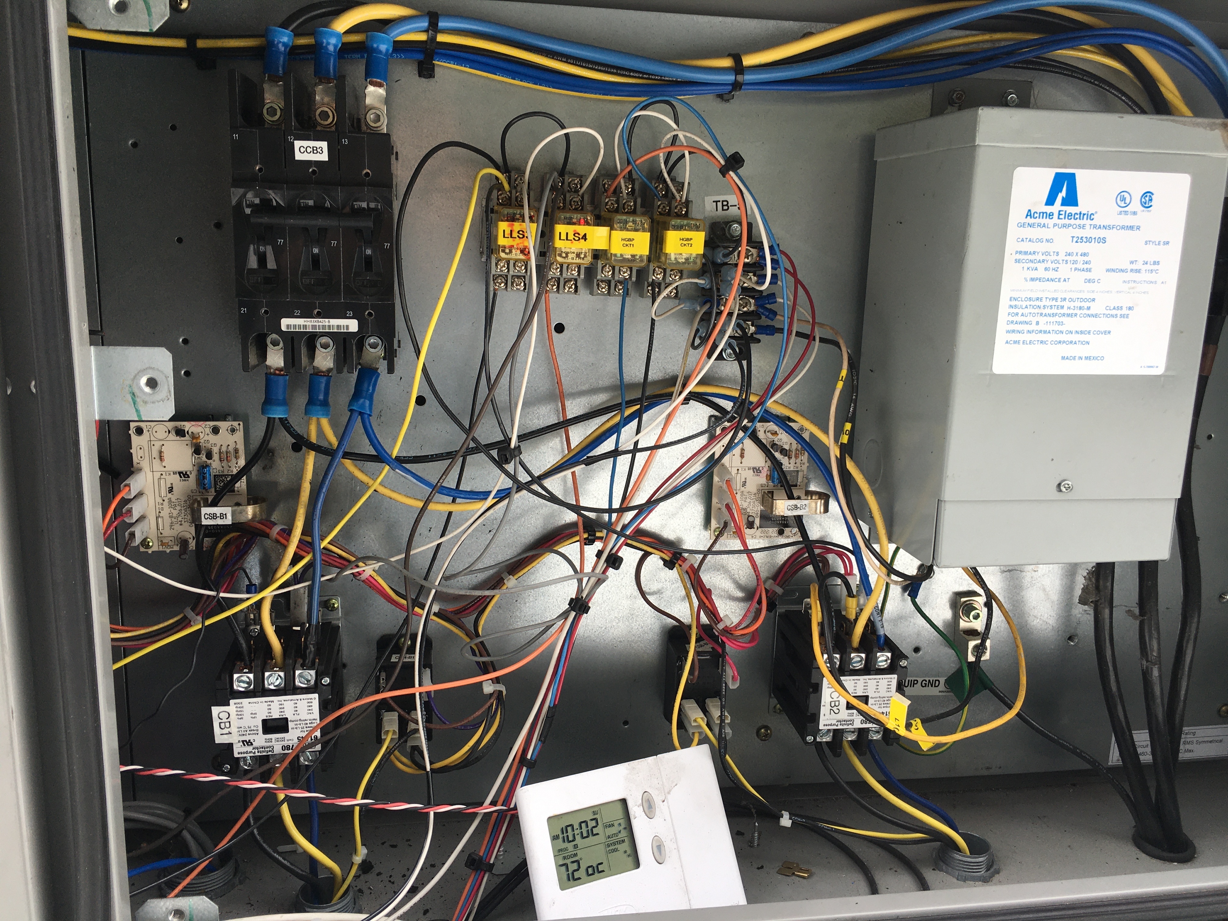

I understand 410a is getting pricey…
The new built up unit takes many jugs to charge both circuits..
A nearby study found 8 of 61 Schrader valves leaking…
I felt bad for the contractor having to replace all the lost refrigerant plus paying for the supply house to open on a weekend…
Yesterday a bad contactor blew two of three 125 volt 480 volt fuses that required supply house to open after hours again and no 125 amp only 100 on shelf.
The failure also tripped the 125 amp breaker in the panel room…

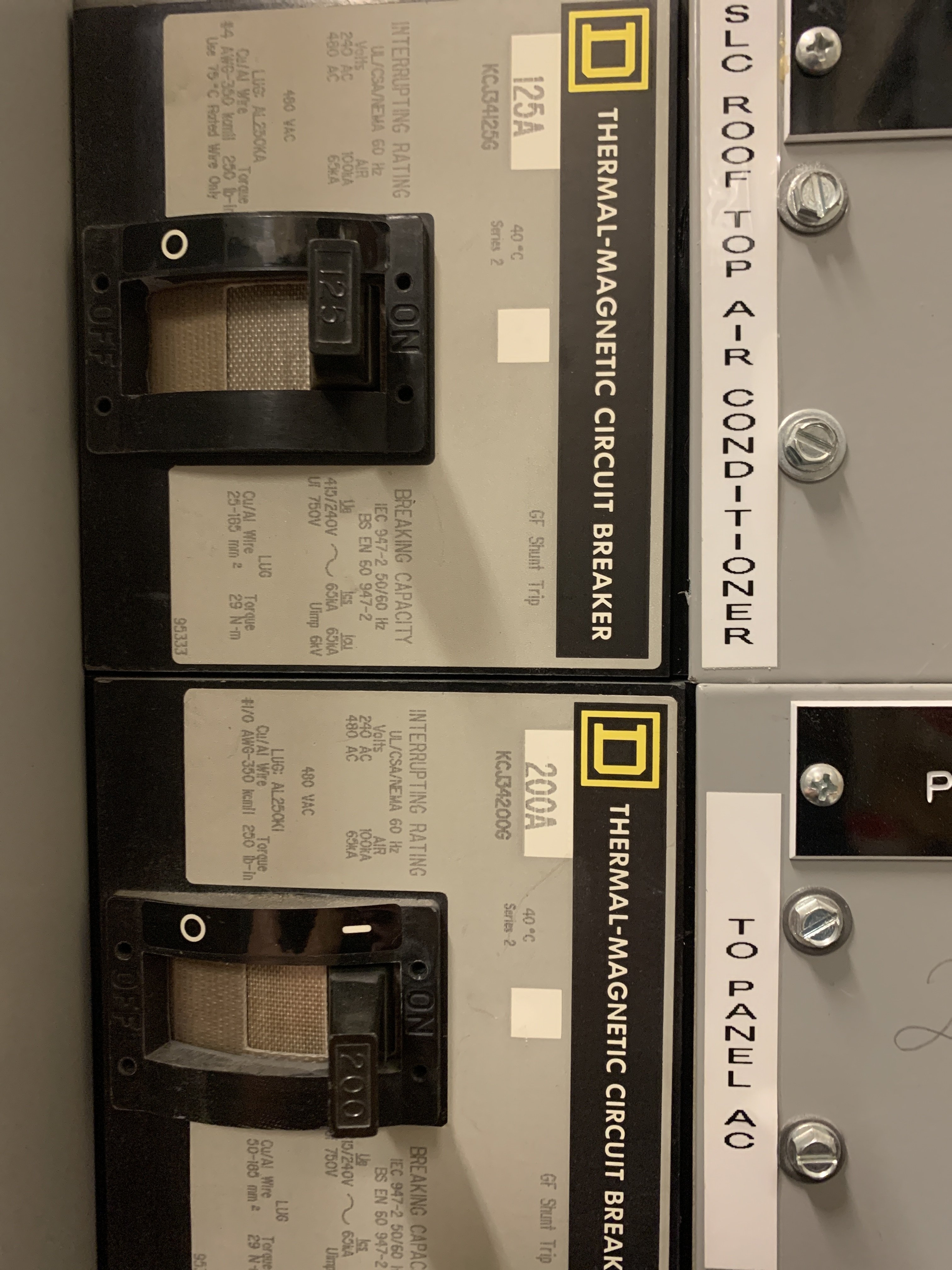

I don’t see the need for both 125 amp fuses at the service disconnect on a 125 amp circuit breaker protected dedicated circuit…
What am I missing because I’m thinking just making the Service Disconnect fuseless.
Cant just do that. Fuses are first line of defense for motors, etc. some like ac units will use time delay fusus, other are instantaneous. A breaker will allow alot more power thru to device before they trip. How come your hospital doesnt install a locked fuse cabinet and store some of every sized fuse necessary? The hospital and large production facilities i used to work on had large fuse cabinets plus inventory records to keep them stocked.
Are you using magnetic contractors for the systems? Then appropriate thermal trips can be installed for motor protection.
To my knowledge the physical disconnects located in sight of the unit do not have to be fuse protected, as long as the upstream protection is sized correctly.
As they are just for "personal" safety while working on the equipment.
I will also admit to not staying current with the NEC the last 10 years.

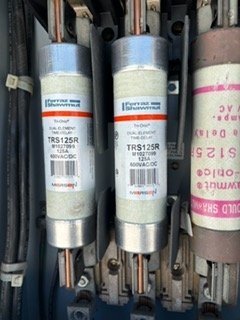

I have spares for every fuse in the building in many formats from euro style to cartridge plus spare circuit breakers.
I only keep 3 of the TRS125R on hand since the only application is this unit… never needed to use one in 30 years.
I keep the 3 spares on the roof in the unit control cabinet.
Yesterday I told the tech I have spares on the roof and he said only one and it’s bad?
Turns out contractor used my spares and didn’t say anything and did not replace…

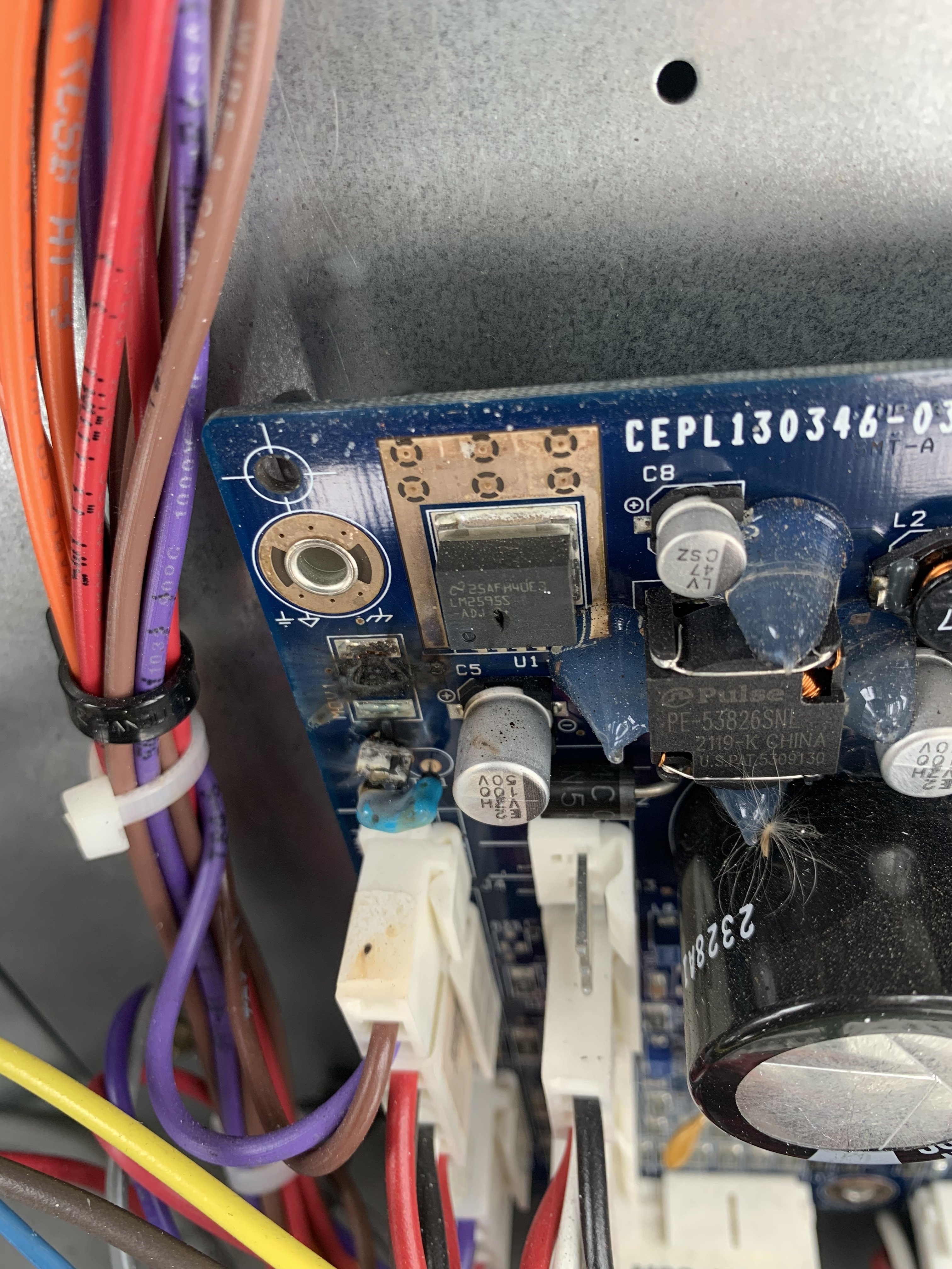

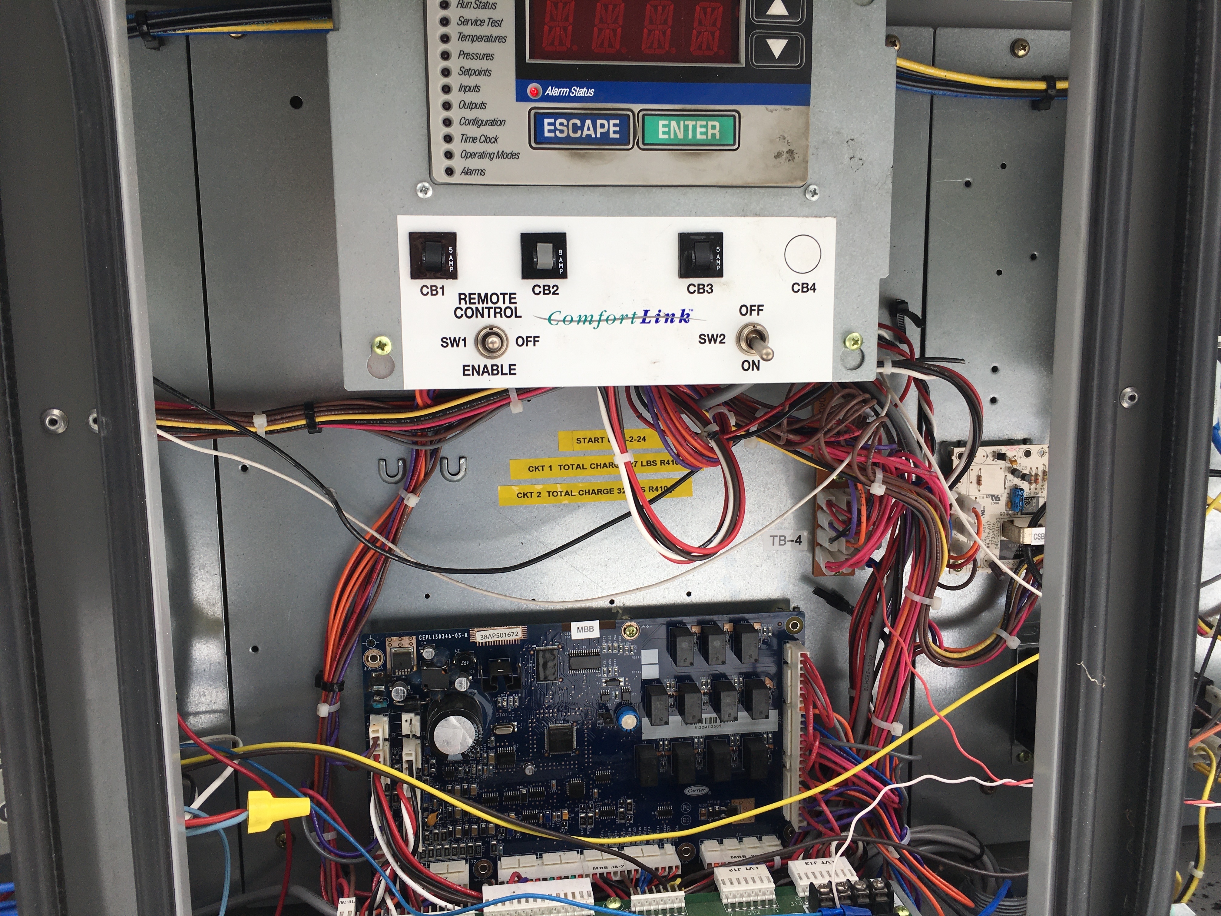

Several weeks ago this board in the same unit became toast… 5-6 weeks build from Carrier… none in North America per Carrier…

That may or may not be true. Some devices will work just great with thermal disconnects, others not so much. Some equipment ive installed in pharmaceutical production facilities have strict instructions as to what sized fusible devices you need. As to need for cut off, while the NEC may not require a knife or fused disconnect next to machine, the device itself may need it depending on the complexity of the electronics within the device. Some machinery includes fuses within the controls. Most dont. Some machines will void warranty if fuses arnt used.

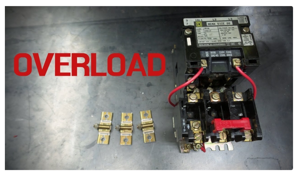

Thermal magnetic circuit breaker is not the same as a disconnect with resettable heaters. The heater elements can be sized for the load, and are resettable.
But again, not as fast acting as a instant fail fuse.
Several weeks ago this board in the same unit became toast… 5-6 weeks build from Carrier… none in North America per Carrier…View attachment 3804314
If it were me, I'd buy a second board... I detest this trend in HVAC in particular of not stocking spares of even current equipment, especially for equipment with known track records of failures.
I can't tell from your photo, but there might be an electrical technician nearby who could repair the board, especially if you didn't lose a microcontroller. I do think I'd be wondering a bit about why some many pieces let out the magic smoke at once, and I would want to develop a plan to find and address the underlying cause. That's a lot of broken items.
Schrader valves? Without a gas tight over cap? That seems like a worse than poor design from this armchair. These days, at a distance, Carrier seems to have this diversity of designs, some good, and some in the pig's breakfast category, or worse.
