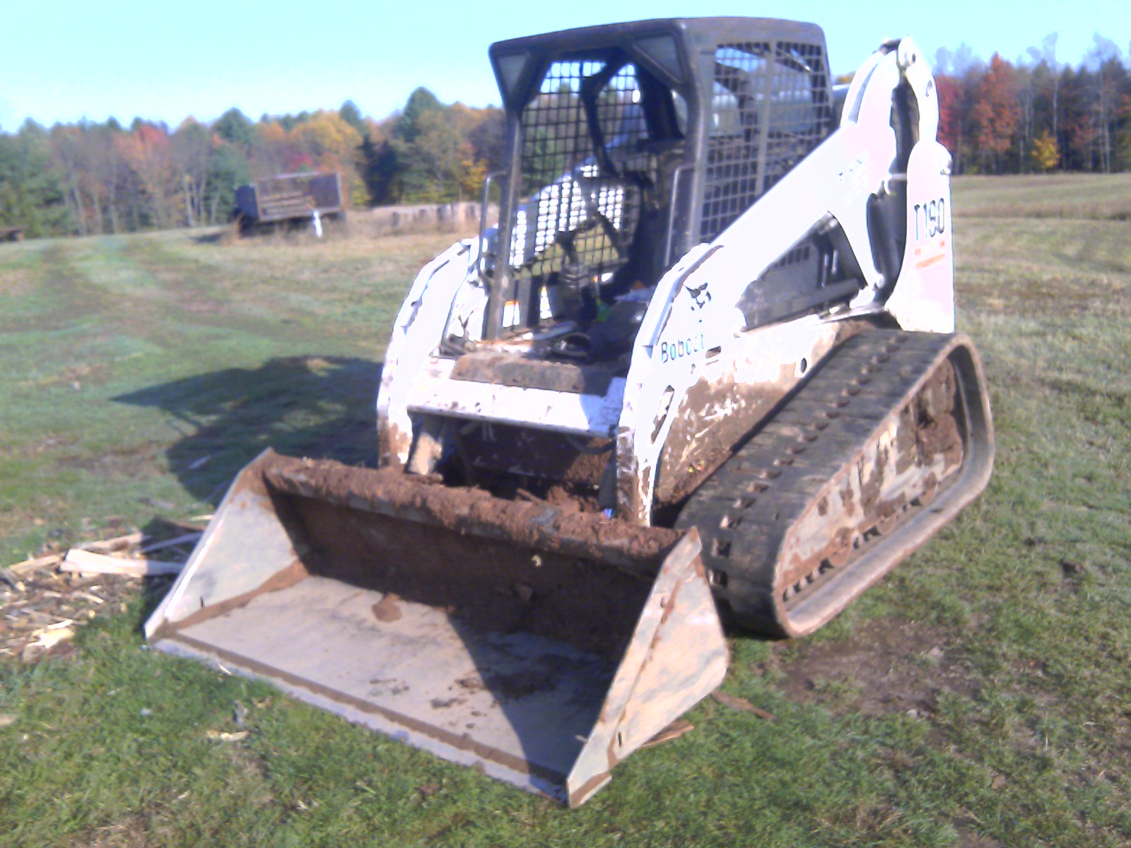

From some brief reading here, i would consider a tracked skidsteer. if all your doing is moving dirt and such and possibly some mowing go with a highflow tracked unit. They are unbelievably stable on steep slopes.
Personally, i have been on a tractor for 53 years now in all sorts of foolish places, i cant say i have been scared of situations but i show respect for the machines capabilities and will push it to the limit and then some, Its all right to be scared to operate a piece of equipment on a slope, it is dangerous work for a new comer, a lot to take in and understand, go slow and start on some level ground to start out. Soon it will come natural just like when you learned to walk.
If in doubt then the best thing is to rent a certain piece of equipment for a weekend and try it, dont forget the insurance on it in case it does roll .. . Becareful and good luck, John
BTW ( 3 years ago i rolled a Barko log loader over the side of a mountain it stopped 300' down on a ledge when the ground gave way, i havent regained the nerve to operate one since and i operated one of these for 30 years)

A tracked skid like jpm1 shows is what our landscaper used when we built our house. He whizzed across our hillside with the various blades and levelers at top speed. I can climb the hill he was on with my BX, but I'd never go across it like he did. Lots of weight, all but dragging on the ground. I'm sure you could roll one of those, but you'd have to work at it a lot harder than a tractor.
