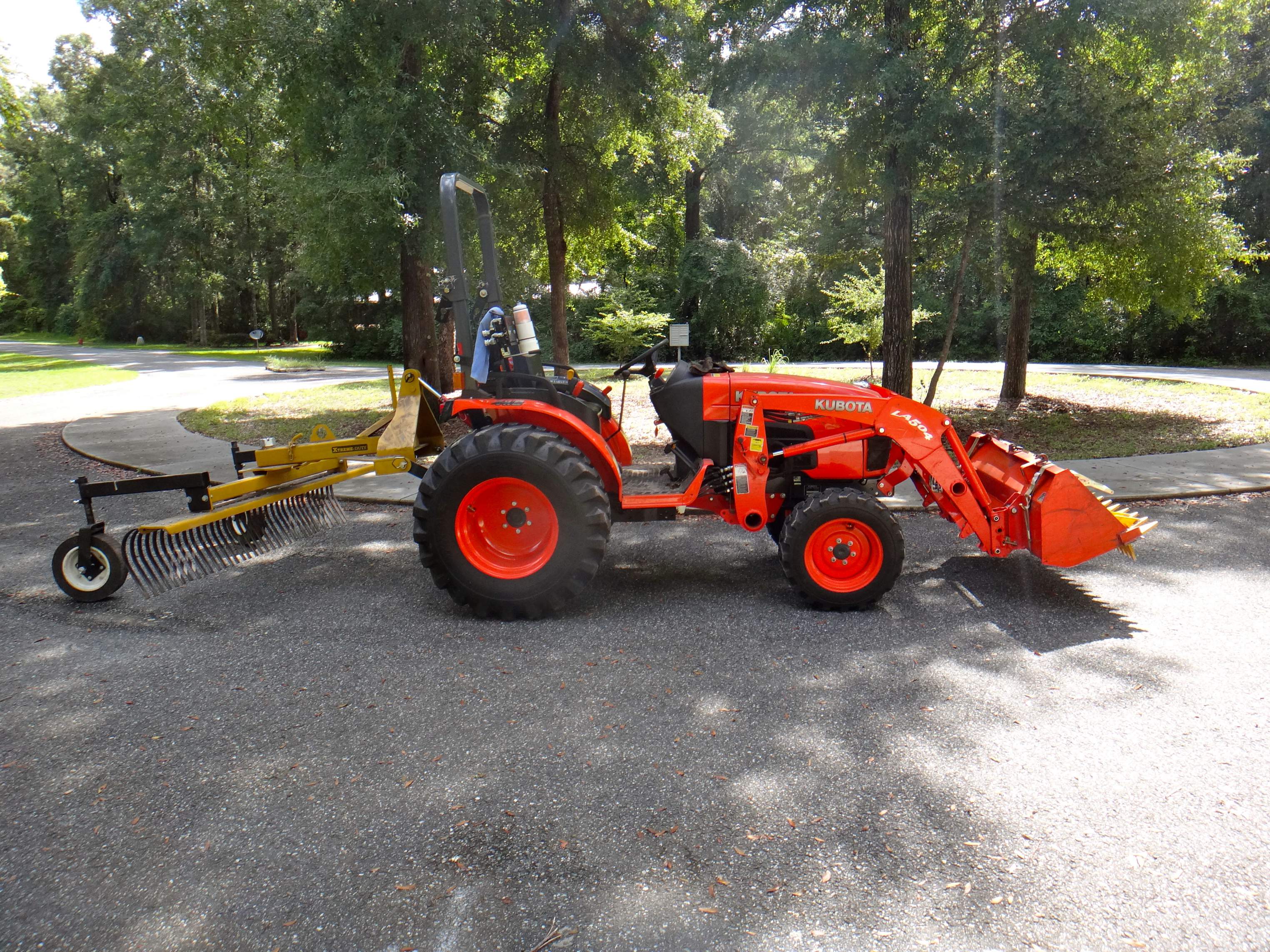

4) With a Toothbar or Bucket Spade attached a FEL bucket can do some digging. It can remove sod but not so sod can easily be reused. With a Ratchet Rake attached, bucket can do limited grading. BX is limited for digging/grading by lack of power.
For serious grading you use "implements" which mount on the three point hitch at the rear of the tractor. There are a bizillion implements for grading. The four most common are the Box Blade, Landscape Rake, Rear/Angle Blade and Land Plane......then things get esoteric.
The three point hitch is now an industry standard. All tractors come with them, in five capacities: Category 0/BX, Category 1/Most Prevalent, Category 2/Utility Tractors, Category 3/Ag Tractors and Category 4/Behemoths.
Three points hitches are all laid out the same. Understand one, understand all.
5) Make a list. Tractors can do everything but limb trees.
You need a tractor in the 30-40 horsepower range, not a BX.
If I were a Cardiologist, instead of a retired marketing guy, I would buy a Kubota "Grand L" L3560. L3560 has all the gold bells and platinum whistles standard, including the ever-so-nice three point hitch with pin adjustable and telescoping lower links, which makes mounting heavy implements easy on your heart.
I aspire to an L3560. Nirvana.
http://www.kubota.com/product/L60/lineup.aspx
I buy one new implement every-other-month. It used to make Wifey crazy but she has figured out hobby tractoring is less expensvie than hobby boats.....and has become inured. The implements that sit are sold off. The stock of active implements keeps growing....
Sorry T-B-N limits pictures. I have a lot more.
YOU NEED A T-R-A-C-T-O-R L-O-A-D-E-R.
